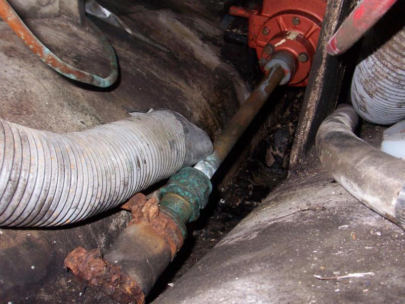

I'm with Bill Roosa on this.
They even sell wire wheels and cup wire wheels that you can put in your drill. The wire wheel will clean the patina off of brass and it is kind of rewarding to do. None of them come with the "son" attachment though.
I cleaned my 40+ year old stuffing box (bronze) earlier this spring using a bench mounted wire wheel. It looked like new in about 1/2 hour.
Save the ketchup for your burger, vinegar for your salad dressing and lemon wedges for your iced tea.
Before/after pictures attached.
