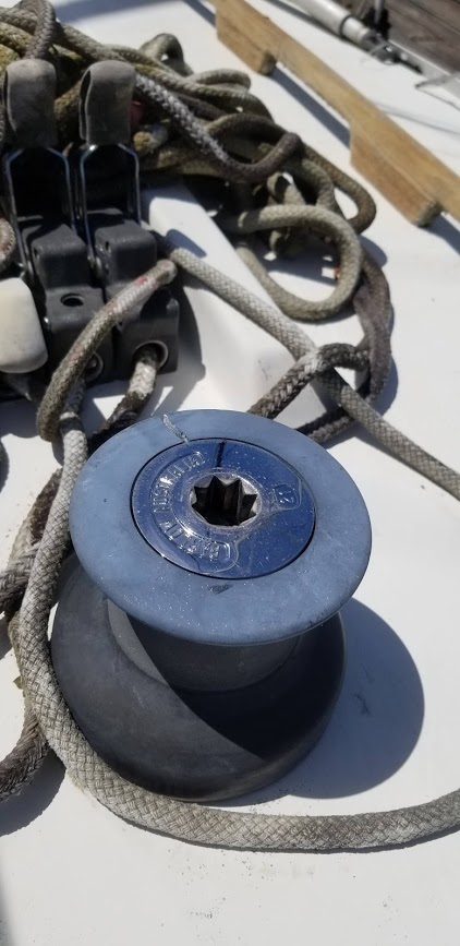

Need help have a broken Australia Barlow 21 needs replacing. We are thinking of replacing both on the cabin to Lewmar Self Tailing but dont know the proper size any advise? 1988 Hunter 28.5

Starting March 10 to 16 West Marine is running a BOGO on winches, I would wait until then to purchase. Barlow and Barient are the same company I believe.
Heres a good comparison chart
Likes: BlowMeAway
22,846
OK Here you go. This came from L-36.com site it is a listing of comparisons for the winches on many boats. You have a Barient/Barlow winch. A #21. You can use the table to find your winch specifics in the "Standard Winch" area and choose one of the current manufactures with similar numbers.
Good Luck.

Of note, WM just sent out flyers stating they are holding a buy one get one sale on their Lewmar Winches. Mar 10-15.
:plus: The West Marine Bogo is the way to go for replacing winches. For comparison regarding wenches please see the chart below. Sorry @chiefairwrench, I had to do this! It happens every time on this forum. Spellcheck kills our sincerity. Welcome to the forum!

On my H31 which is the middle sister boat in our vintage I’m looking at Lewmar 16 self tailing for cabintop halyard winches and waiting for WM sale.
