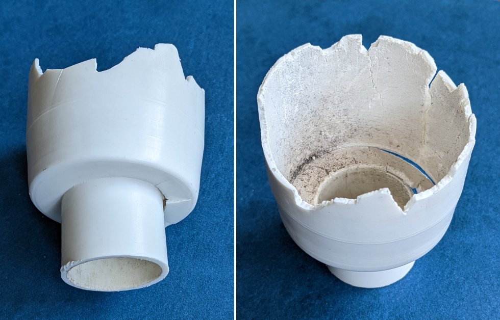

Next topic: the transom shower holder is broken, as this photo shows. It's about 2.25" across at the fat end and 1.125" wide at the narrow end. It's made of plastic that feels quite fragile now.
I've been told that these break routinely.
Do you guys know where I can find a replacement or have a recommendation about how I might repair or build one? Does someone have a 3D model of it and know how to create a new one in a 3D printer?

I’m assuming you already tried matching the sizes to readily available PVC pipe fittings at any hardware store.

I have a 2001 36 cc and replaced what appears to be that item or a similar one, new spray nozzle, and several of the caps which seem to last about two years from Scandvik. All seem to fit a hole 2.25 in in diameter. Suspect it may be cheaper than going through Beneteau parts - plus free shipping.

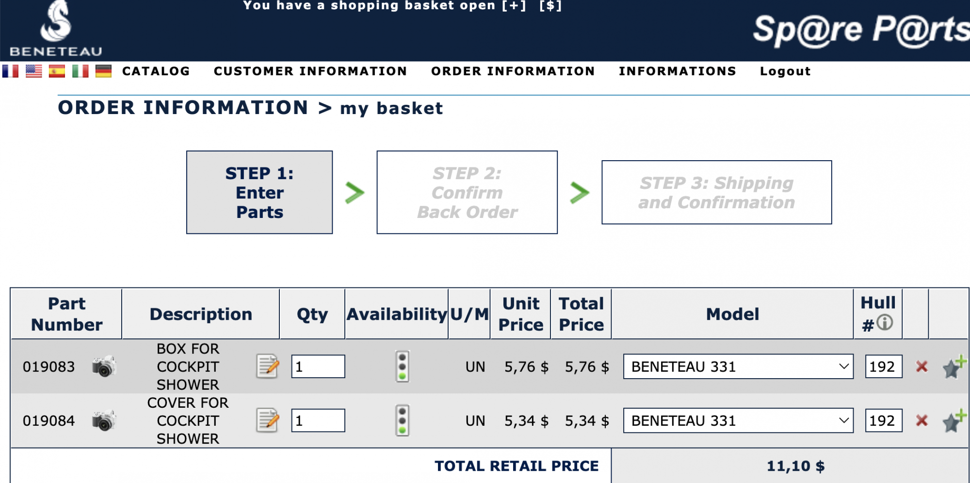

Thank you guys. I purchased my boat used, but fortunately the broker's a good guy and works at a Beneteau dealer. After emailing him quotes of what you said he found someone who created an account for me on spareparts.beneteauusa.com/ressources. What a trip!
I'm a computer science PhD and I speak some French but I'm having trouble finding a part by its part number on spareparts. I'd love a hint!
Thanks
Arthur
May 17, 2004
5,744
Thanks
Arthur
The site is far from intuitive if your pick your boat model from the drop down, then search for a keyword of “shower” it’ll bring up a list of shower related parts. I think that the first one (the box for cockpit shower) is it. Once you click on that you can see where it is in the diagrams and a photo of it.

My Beneteau 331 had similar issues with the degraded shower and mixer housings. I contacted Penguin Engineering concerning their parts SR81 (white pull-out shower) and SR81/1 (white mixer taps).
Zena was kind enough to inform me that they are a European dealer and provided me with the US-based agent website, www.scandvik.com, so that I could avoid shipping hassles and extra costs.
I found Scandivk part numbers: 10275 (White Recess Shower w/ 10' hose SR81) and 10498 (white Mixer Valve SR81/1). I was also able to locate a few direct housing replacements with the 3 5/8" (~92 mm)) overall diameter.
