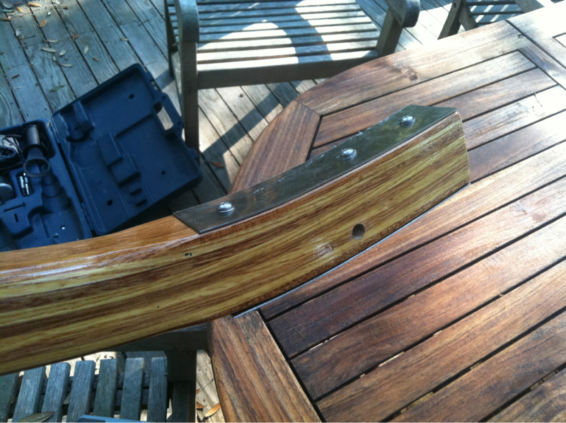

Jan 18, 2011
225
Hunter 26 Beaufort SC
My H22 kept breaking tillers. But the design must be different. Here are pics of how I reinforced it. I installed a piece of aluminum tubing through the bolt hole.
