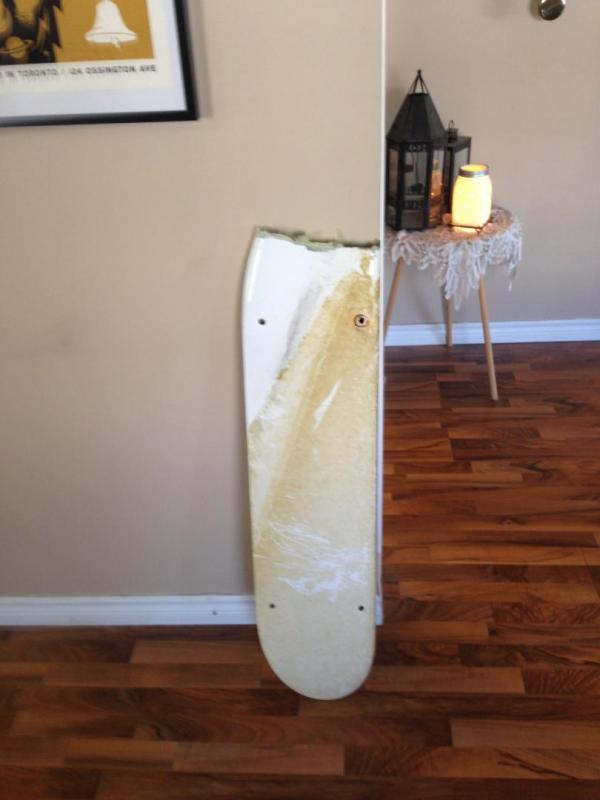

Just bought a 1994 26S and it came without a rudder. We did get one sent to us but are not sure if there is more to it than the stainless steel mount that is attached to the hull and tiller. When it was installed for us it was with a single bolt through the stainless steel mount. The rudder broke today while sailing. Just wondering if someone could give us some advice on how it should be mounted when we get a replacement as there was obviously too much stress for the hollow fiberglass rudder. It broke about 6 inches below the mount.

I wonder why that brand-new broken rudder has stains like that?
Was it partially submerged while not in use when it was on the boat, i.e. not all the way up or down?

Yeah this rudder appears to have been struck/hit while it was floating/resting on the surface of the water resulting in a stress fracture, it had some degree of side force applied to it in any event
make your next rudder outta wood, glass it over, U might bend break somnething else, but it wount be the rudder

I was also going to mention the staining. No indication it was ever vertical. Looks like it was swept back for quite some time. I personally raise mine out of the water when I am in the slip and haunt it down.
Now it is possible it was in the wrong hole and that would have been as far as it could have been hauled down.

Thanks for the input. The rudder broke under some fairly heavy wind conditions and the staining is because the pivot hole only allowed it to be raised partly out of the water.
Because there was no rudder on the boat when purchased the holes you can see in the photo were the only ones in the rudder when we received it and perhaps the pivot hole was drilled in the wrong place. We could not find any instructions or pictures of where the hole was to be so we went on the information we had at the time for hole location.

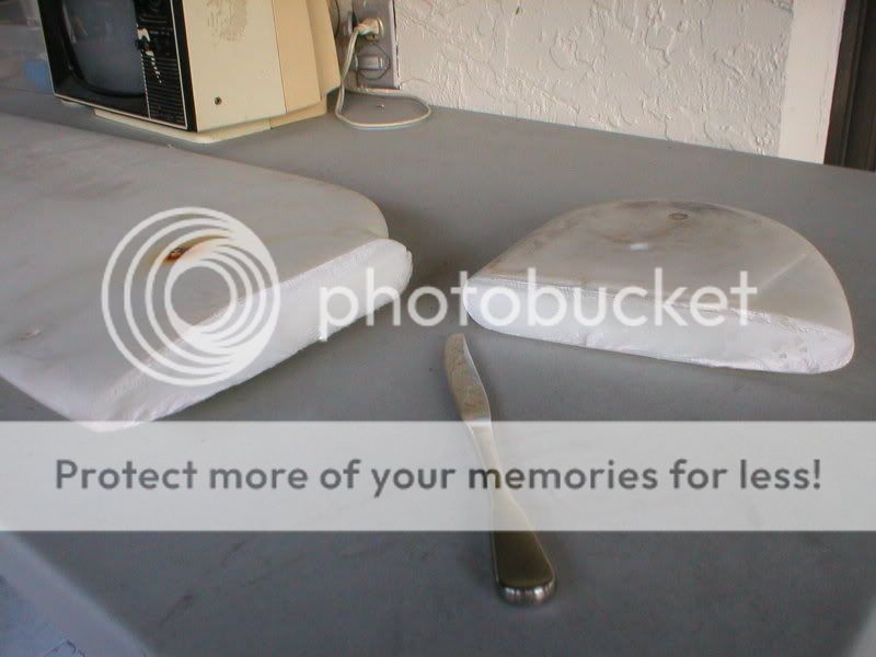

I am no forensic expert, but based on the crime scene it appears to me like someone used a butter knife to cut that one. :)

LOL, mine snapped in 10knts and a light chop... very unexpected. (but previous use was in some heavy conditions)
I can tell you these boats don't tow well at all without a rudder. I always carried my spare (stock) rudder. and installed it once towed to shallow protected water
