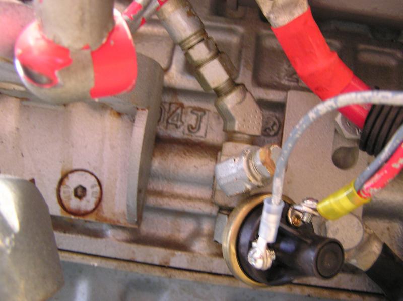

Shown is a picture of a pressure switch (Yanmar 2GM20F) with the wire disconnected. It has the solid post for attaching a ring terminal.

Thanks Ralph. I see the Westerbeke part # is 37323, I was just wondering if there is an upgraded or better part out there.
Jan 4, 2006
7,623
I see what you mean about this not being the sturdiest of electrical connections. It's bound to be broken again in just snagging it during regular maintenance.
Any chance you can anchor the wire very near the terminal so as to reduce the chance of snagging it ?

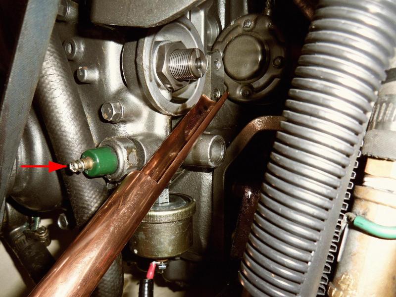

Does anyone have any photos of where this switch goes? I have the same issue...no low oil pressure warning horn or light. Replaced the horn. So now I have new Oil Pressure Sender switch. But not sure exactly where it goes yet.
Appreciate any photos or descriptions on how to do this.
Cheers,
Jim
Mar 22, 2009
360
Catalina 310 Gulfport Small Craft Harbor, MS
Thanks Paul. I take it that is lower forward port side.
That switch does not look exactly like what I got. There are 2 prongs on one end and a threaded post on the other.
Guess I screw the old one out and screw this new one in and then attach the 2 wires to the two prongs. The prongs look like the male end and will need female plugs to go on them...definitely not screw in wires as in your picture.
