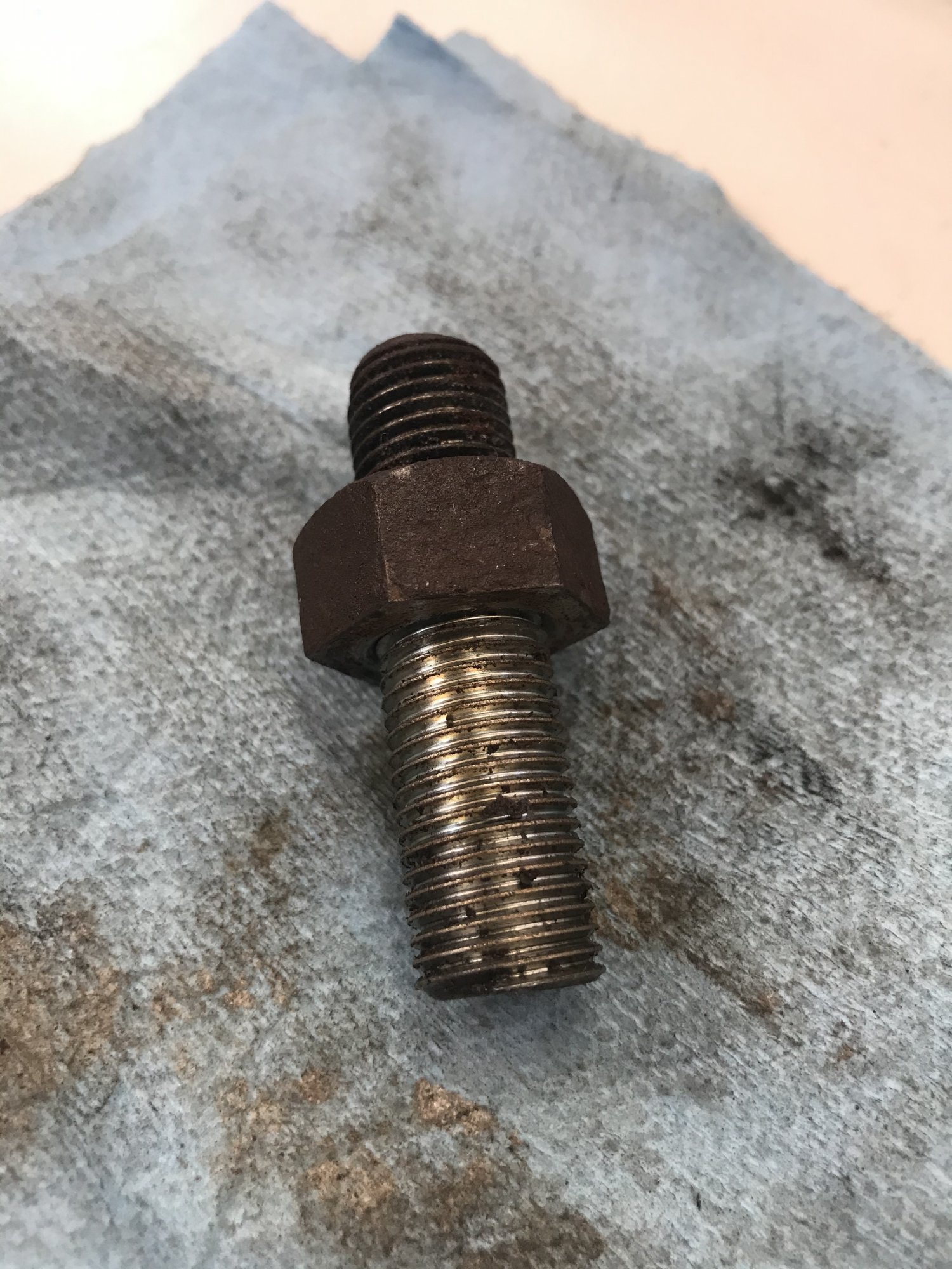

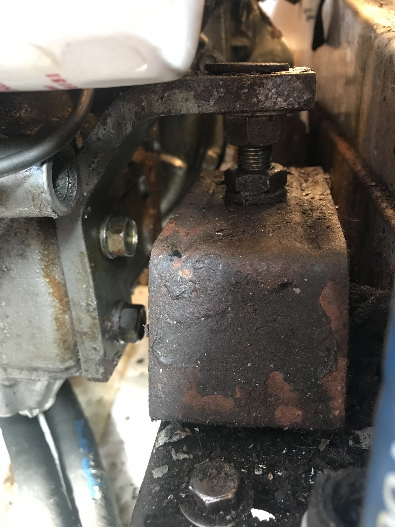

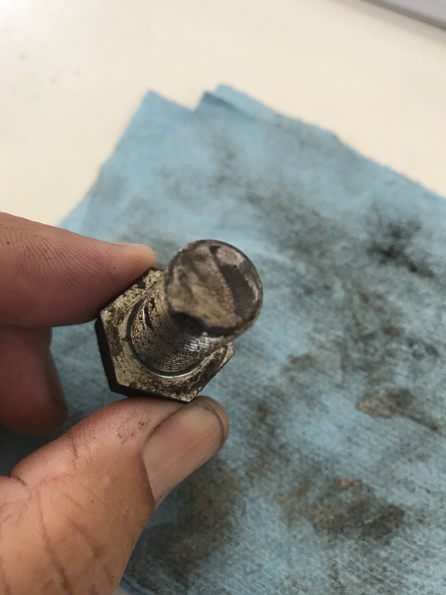

So in the process of trying to align my prop shaft with engine(which the previous owner paid $5000 to the boat shop to do but they never did it and had no explanation why) I find this bolt on my forward engine mount won’t adjust? I pulled it out and it looks like it sheared in the past and someone just stuck it back in?

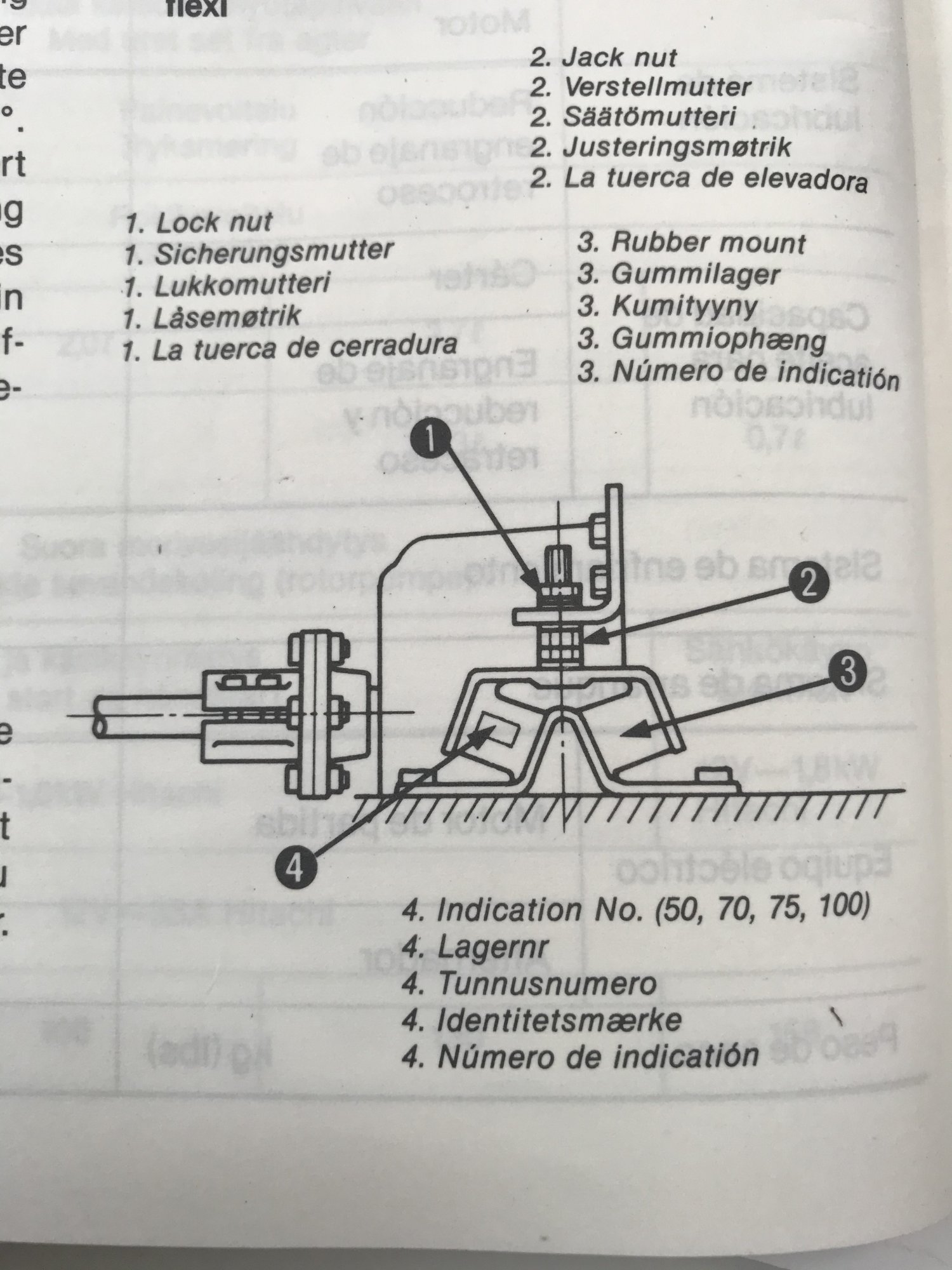

I’m pretty sure from looking at the yanmar part that the bolt on the mount is 1 piece not 2.
Any thoughts I just wanted to double check so I’m not replacing something that doesn’t need replaced.

You are correct, that bolt should gave a nut below, AND above the engine mount tab. Looks sheared off.

Definitely sheared! I wonder why? Depending on their age replace all four. If fairly new then look for a reason it sheared.

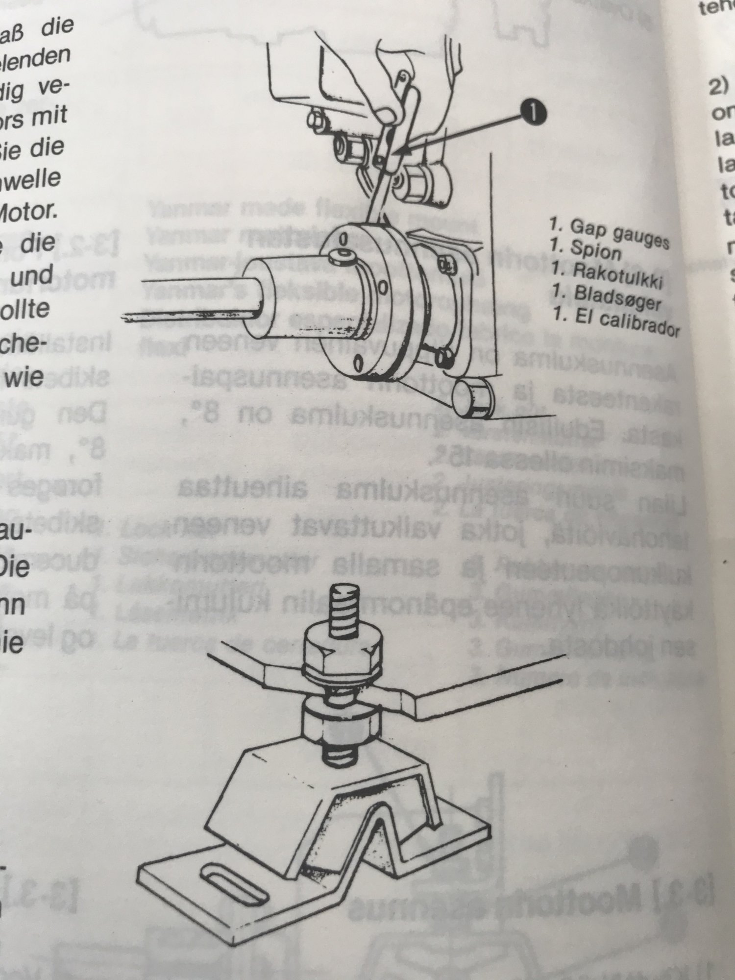

So just looking for advice as tomorrow I will be aligning shaft ant tightening things up.
questions. How critical are the gap settings manual say less than 0.2mm?
Is it worthwhile getting a flexible coupler does it make up for not perfect alignment?
Any tips advice on alignment?
