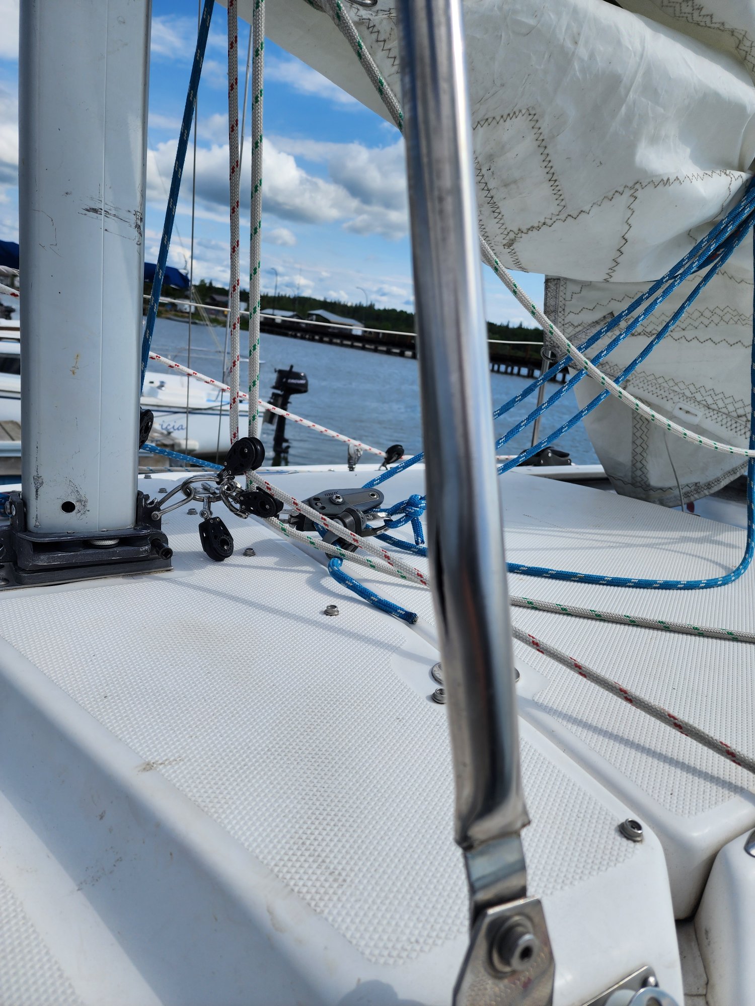

Raising the mast yesterday, and I had my new lower shrouds a little too tight (and on the wrong side of the spreaders) initially. I'm not sure at exacly what point it happened, either when the raising pole fell off-axis briefly, or when some very enthusiastic helpers hauled on it before I could confirm correct shroud attachments. There is now a longitudinal crack in the port mast strut, which I didn't notice until everything was up. Tension on the shrouds feels reasonable and the mast is stable, but I'm hesitant to take her out until this is addressed. I also need to drop the mast again to fix a halyard issue, which I'm a little nervous about given the damaged struts.

Assuming I don't overload it again, can I continue to sail with a damaged/missing strut? Also, assuming I have extra hands to take the weight if it lets go, can I still safely drop the mast for other maintenance? There's a fairly long lead-time to get new ones from Hunter Owners so I'm looking into locall fabrication, but expecting a bit of a wait.

It would be best to not use that strut as it is.. The crack looks to have been caused by water freezing inside the tube. A good stainless welder could weld that up.. Probably would be best to weld a patch over the crack after the crack is fixed with the edges of the patch about 1/2" beyond the crack all around. The patch should be the same thickness as the tube material.. That would be fine until you can source another ....

If I was on a camping trip with my 240 and broke one one of my struts, I would complete the trip and come home as scheduled. I would not call for a tow. If I broke a strut prior to the scheduled trip, I would fix it. Our vessels are to be maintained and must be sea worthy. I agree the strut is not a major point of strength while under sail (or all SV’s would have them) but it is nonetheless a broken part on your vessel.
I have a small machine shop close by that allocates Thursday’s to help the community with small tasks. I bet you could find a shop that could fix/replace that in no time.
If your mast is still stepped. You could easily use a small piece of rebar and a few hose clamps to reinforce that while unstepping then pull the strut.

I had a strut come off due to the top bolt holding it break. I was half way accross the Pacific in 30k average true wind.
I saw how the mast pumps without the strut, luckily I had a bolt to fix it. They are not meant for compression, that will damage them, the ball joint bolts bent on mine once. Fixing, welding yours should be fine.

I pulled it off without unstepping and dropped it off with a local fabricator. Should be back ajd ready to sail before I'm off work in a couple weeks. Not really worried abour the mast with the rest of the standing rigging in-place and no sails up.
