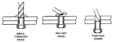

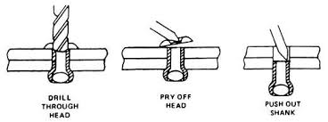

The SBO store sells the mast foot replacement .... to get the old rivets out, you need to drill out the center button of the rivet.
