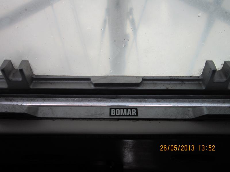

OK I have broken the riser arm on the forward hatch of my 1985 H34. :cry: I can read that it is a Bomar hatch but have no idea what model. Going to the Bomar site it looks like a 100 cast series but hard to tell for sure from the pic and I hate to order not knowing if it is the correct riser. Would not surprise me if, like most everything else they no longer make it. Wondering if anyone has had to replace theirs and what they found. Sorry guys I looked at the store but you don't list anything for the H34 hatch riser. :confused:

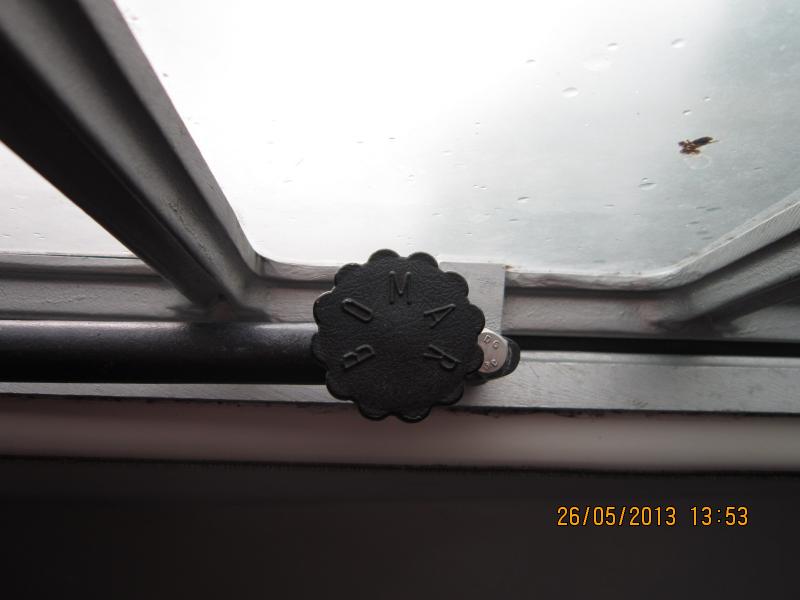

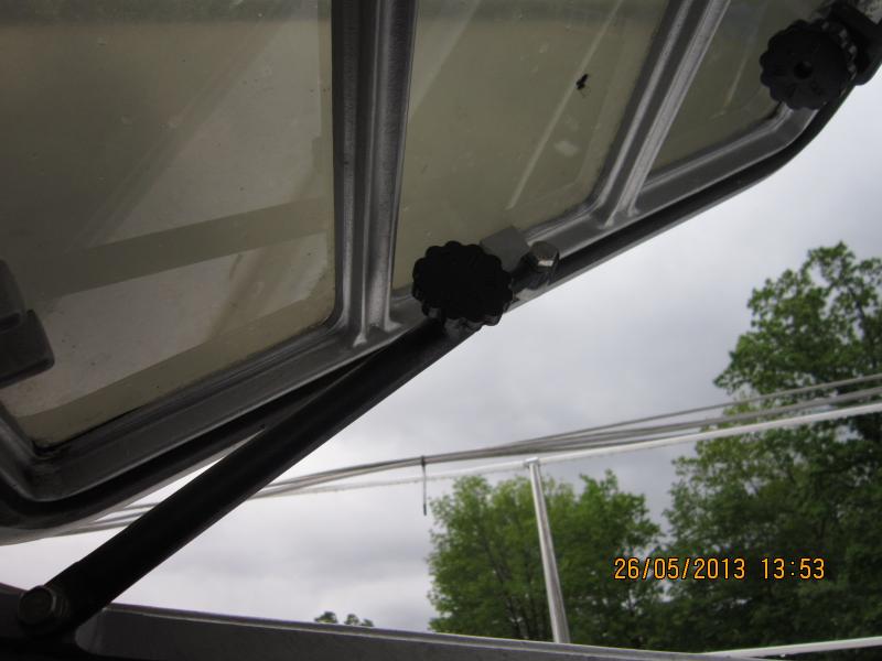

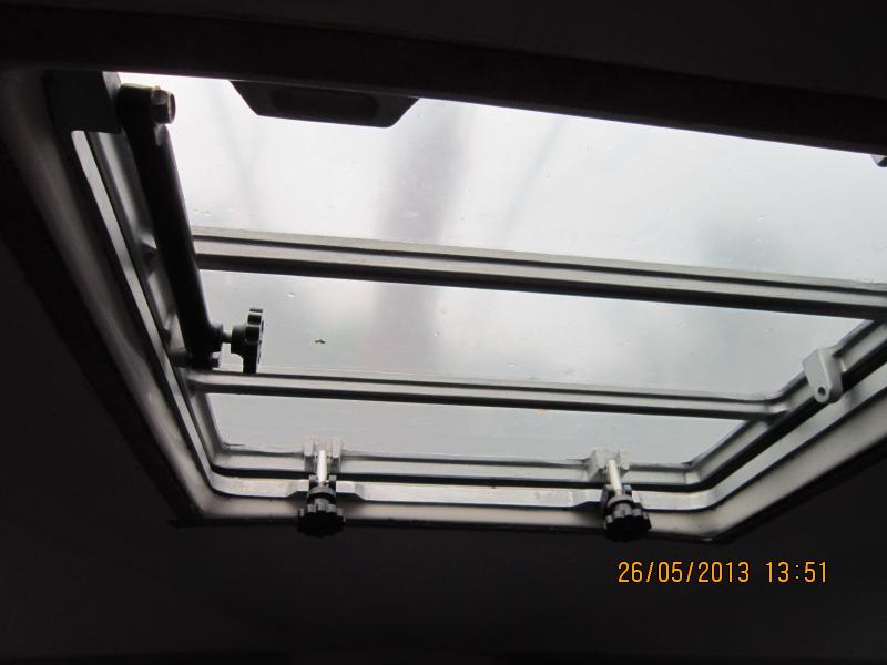

I just disassembled my hatch riser arm to investigate why it wasn't operating well. Please post what solution you find.:)

I called Pomganette/Bomar and the rep walked me through making sure I knew which hatch I had on the H34 which I beleive is the original - the CAST 100 Series and the arm part # P100-00 (Riser arm for cast 100 series cast hatch). The riser arm is avialable all over I just typed it in and got several stores listed. At $78-90 and they are almost the same when you added different shipping. So I guess it depends where you live who has the best price.

I did have two arms on the forward hatch. I would like to replace the missing arm.
10,050
Only one support arm here too.. on the starboard side.. The hatch has the cast bosses for another arm, but they are not drilled and tapped.
10,050
Claude.. Interesting ! I have exactly the same hatch and support arm but mine is on the starboard side ! Might be one of those things like how the water drains a different direction on the south side of the equator ?? The border at Canada might be causing the hatch arm to reverse? uuhh Maybe not..

I replaced mine back in 2009. I had only the starboard arm at the time, now have only the port arm (the screw separated as I removed the broken arm and I didn't feel like drilling it out). I paid $75 with shipping from Defender, and it was worth it.
Dec 14, 2003
1,423
Isn't it strange :confused: ? But I bought the boat in the USA and the arm was already on port. Unless PO switched it on your boat...or mine ? We need to get our boats side by side, with yours on my starboard, then open the hatches exactly the same and we'd have a matched set :D. Boat going in the water this Friday :D:D:D
