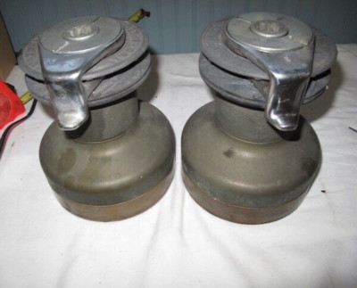

Follow up on Maxwell 24 ST broken gear. I did receive the Maxwell 24 non-ST found on market place. It is in great shape and does look like new old stock! Therefore I plan to proceed with the change of drive shaft to make it a ST. I found another issue however when I totally dissassembled my 24 ST and cleaned it in preparation of the exchange of gears. The drive shaft shows a minute hairline crack at the bottom splined area. So I contacted Arco-Hutton and they replied within 12 hours. Fabulous service. And they do have a drive shaft but the cost would be US $160 + US $35 to ship it to me in Canada. And I have no idea what custom duty would be. Considering the winches are 42 years old and they do show wear and tear on all parts, I don't think it would be wise to spend that much on the broken one knowing the other one is just as old and worn out. So my plan is to try to use the non ST gears with the ST damaged drive shaft until it breaks. If it lasts me the season, I'll have the whole winter to look for other winches. If it breaks this summer, then I'll bite the bullet and order 2 new 40ST winches (brand unknown at this time but at my age I won't be looking for something that would possibly last 40 years LOL). And I would try to sell the 1 working 24 ST + the 1 working 24 non ST + the non working 24 ST for parts. Comments everyone and Thanks for the suggestions.

Allan, unfortunately your caveat turned out to be true as far as the Maxwell 24 Non-ST I picked up on market place. While the dimensions are exactly the same as my 24 ST, the inside was totally different with different size gears + pawls and springs. So...I put it back together and forgot that idea. The driveshaft for the 24ST could be had from Arco-Hutton in Australia (got service from Allen Hutton as far as answering emails !) but figuring the 160 US$ price + 35$ to ship it to me, figuring that the other parts of this whinch and the 2nd one were just as old and worn out, I decided to bite the bullet and ordered 2 Harken 40.2 STC Radial from the local boat parts store. Got great price and they are going to be delivered here this afternoon. Soon I'll have them installed and shortly thereafter I'll put the 3 Maxwell 24 I currently have for sale: 1 chrome non ST (looks like new), 1 fully operational ST, and 1 ST for parts. Thanks to everyone who offered suggestions and help.
