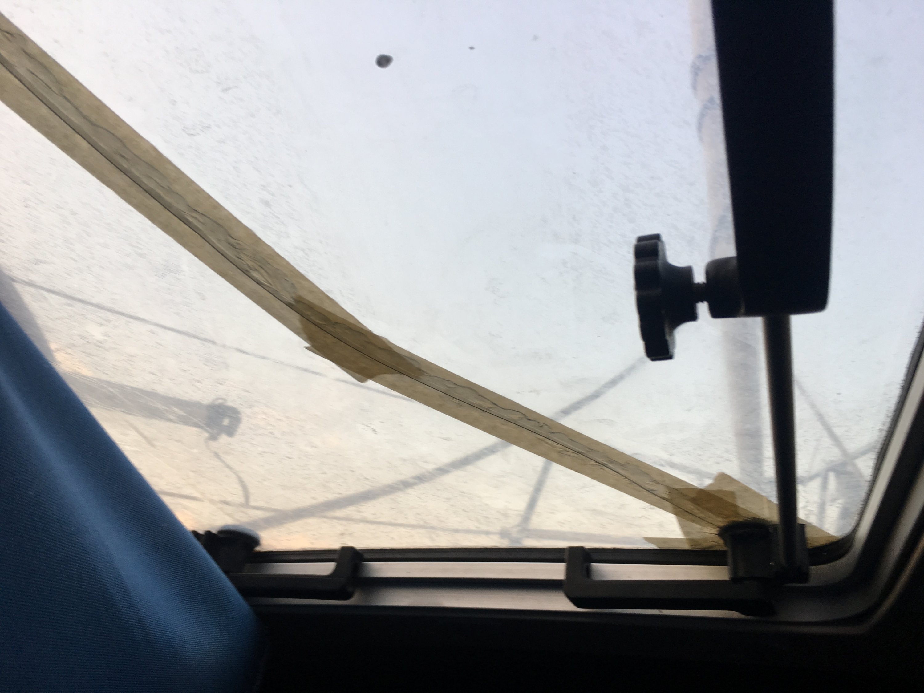

I had a small crack in the window around one of the latches before leaving on a 9 day trip and I accidentally pressed on it and it cracked in half down the middle. I used silicone to temporarily repair it but now I need to fix it. Is there a way to replace just window portion?

I believe my hatch is 15-7/8 centered on the dogs. According to CD, my only option is the bomar lens which is thick and may not be good. I called Bomar and they said they don't have anything pre-1999 and couldn't help me.
What should I do?

Well, I would think any good plastics house should be able to match that lens unless there something unique, which there does not appear to be. Failing that, this is the jobber I used to replace my port lights, opening and fixed: M.D.I., Marco Drovandi, 949 290 1069.

I just called that guy, Marco, and he doesn't think it would be more than a couple hundred to do the whole replacement. Very cool. Thanks.

The Tapp Plastics guys up at Stockton , California, did a fine job for me.. I had them cut 3/8" thick smoked acrylic lenses to my exact measurements.. then I pulled the old ones and glued in the new with Dow Corning 795.. Their cutting was perfect.. Hardest part was cleaning out the old frame and masking the lens and frame to make a nice glue job.. https://www.tapplastics.com/product...plastic/acrylic_sheets_transparent_colors/519

I used the M.D.I. Boat window guy, brought him my hatch, and in 24 hours he installed a new lens and gave it back to me for $150 (less than ordering a custom lens myself). He also said new port light windows are about $25/ea if I install them myself. Super helpful and reasonable guy. No B.S.
Marco Drovandi, (949)290-1069. 1008 S. Hathaway #G, Santa Ana, CA
