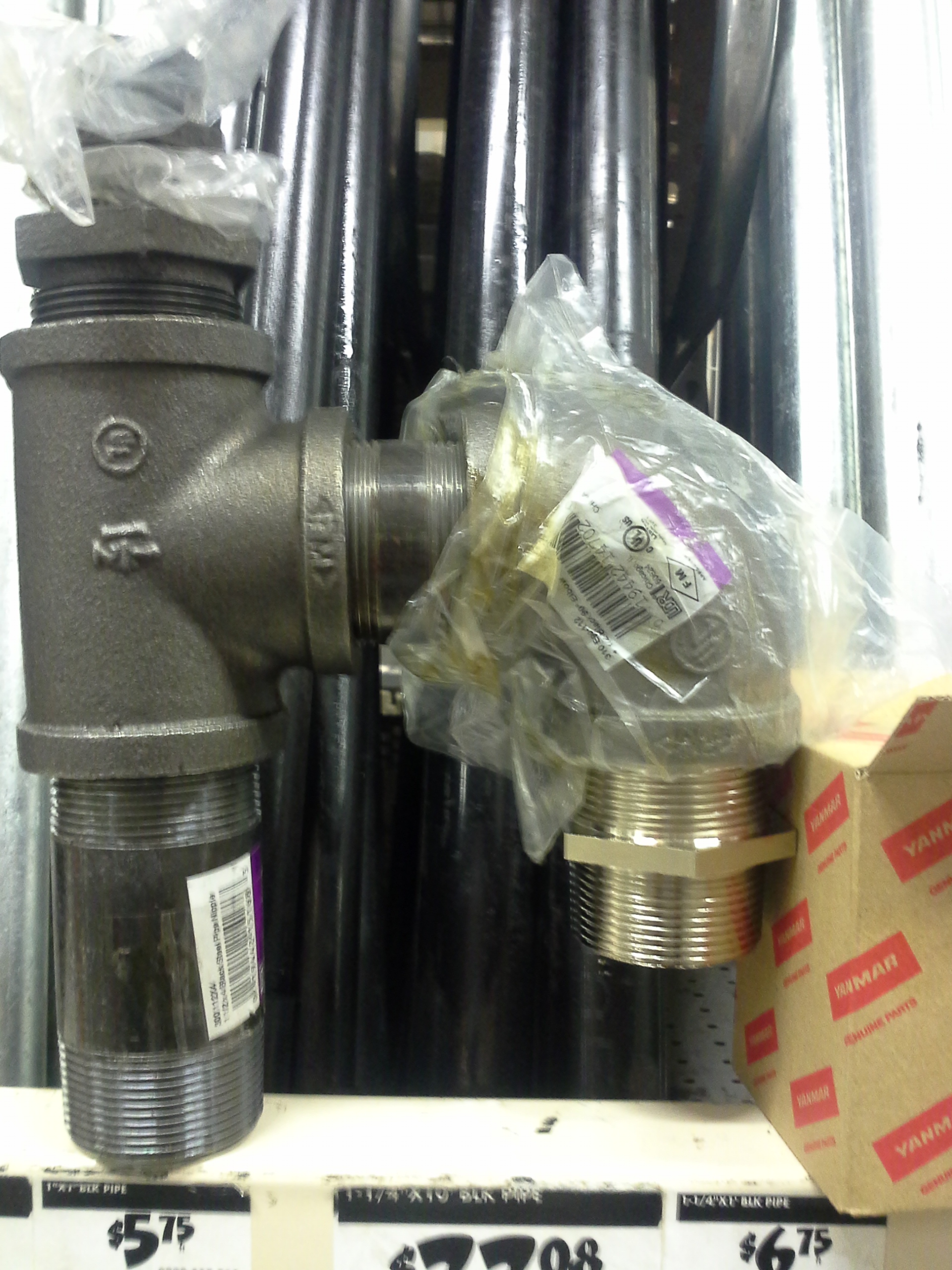

I had one break to but thanks to local pluming store was able to put together a new temp one to finish my trip. Please don't hold this against me...lol It did work great though! The engines heat exchangers output went to the top of the unit top pipe, the pipe ran inside pipe just below exhaust inlet from Yanmar 2GMF. This makes sure that water will not go back into exhaust.

View attachment 141473 I had one break to but thanks to local pluming store was able to put together a new temp one to finish my trip. Please don't hold this against me...lol It did work great though! The engines heat exchangers output went to the top of the unit top pipe, the pipe ran inside pipe just below exhaust inlet from Yanmar 2GMF. This makes sure that water will not go back into exhaust.
Great "get me home" fix! Keep as spare parts after you fit stock assembly. :)
