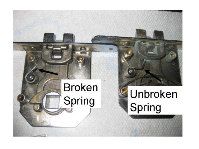

Hi- I have a 1992 41S5 with a door latch that won't. I took it apart and couldn't figure it out so I took a good one apart and found the problem. The standard (bacwards though) spring is broken and I need a new one obviously. I'm attaching a photo showing the broken one alongside the good one. I can't find this in the Beneteau parts - shocking I know. Anyone have some extra for sale?
Thanks-

This is a very late response, but the same thing happened to me and I took the mechanism into a good locksmith, and he made a new latch spring from spring-stock he had on hand. I think he charged me around $20.00.

Thank you very much. I think I'll have to do just that. This site, the Parts section anyway, is NO help at all.
