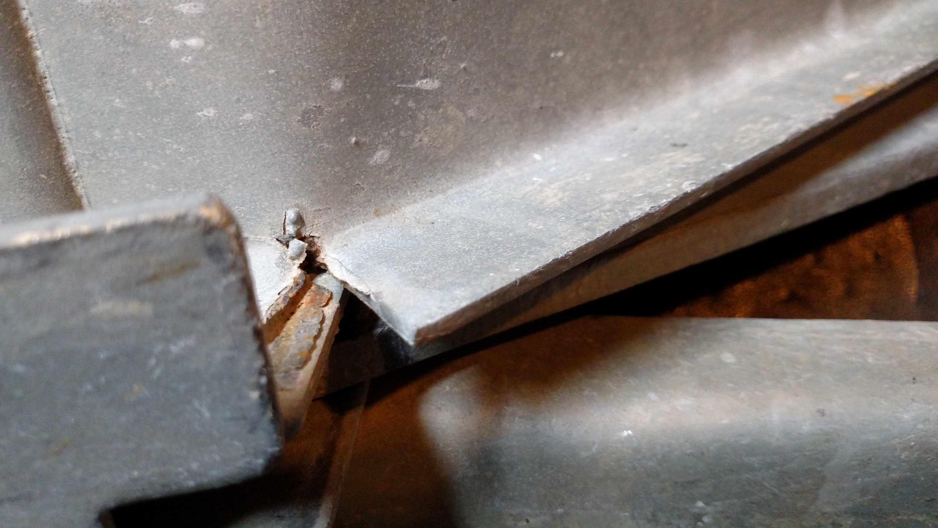

I was anchored out this past weekend in a sandy bottom. Wind was blowing 15-20mph overnight, but I was protected from wave action in a cove. Pulled up the anchor in the morning (by hand) and found one of the flukes bent about 20 degrees from the other. Upon inspection later I found that the weld had failed. There was very, very little weld penetration into the fluke. Approx. 50% of the weld area had no penetration at all. The anchor came with the boat so I have no idea how old it is, but it looked nice and clean.

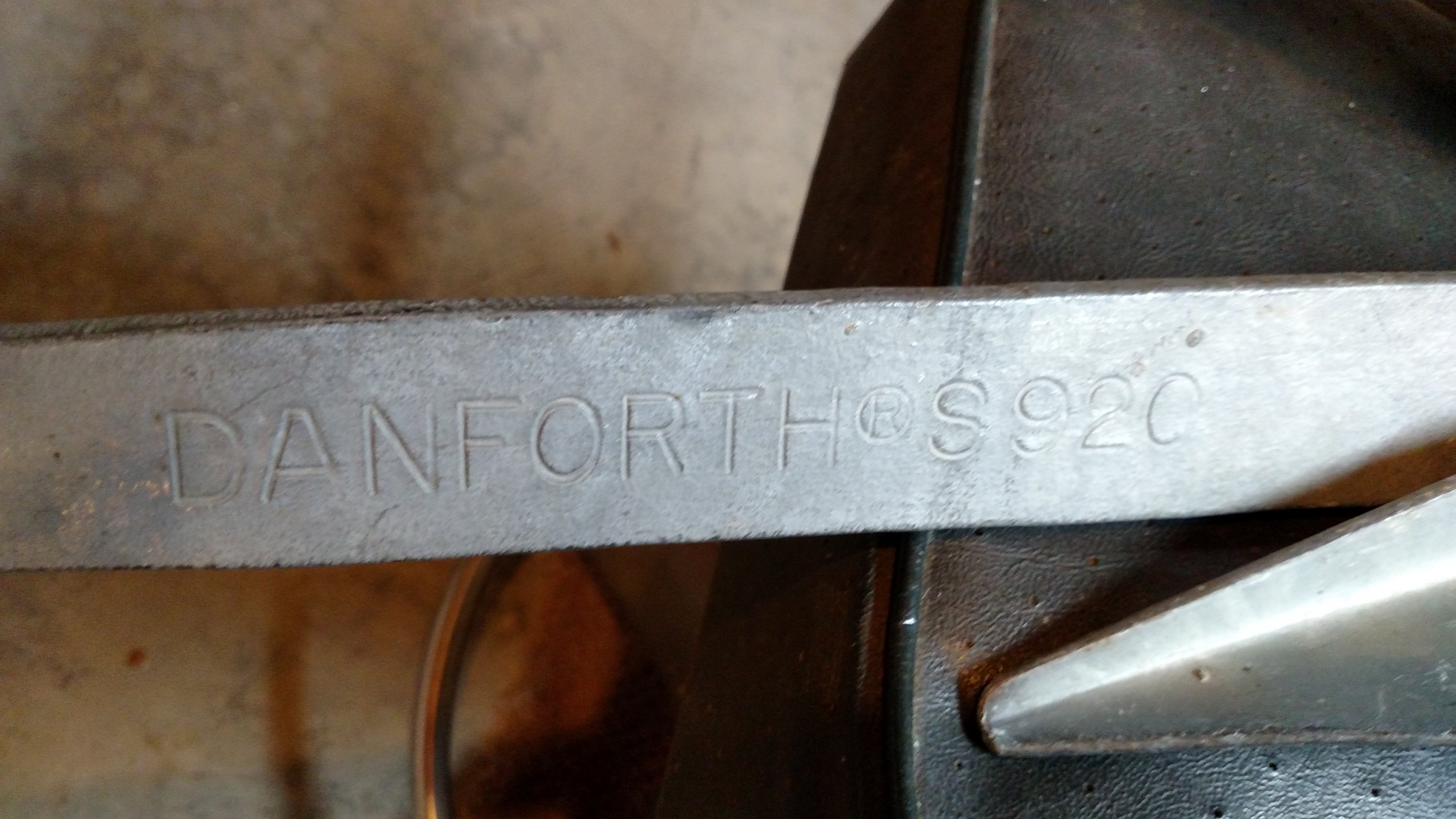

Is it a genuine Danforth (marked appropriately)? Only asking because there are tons of Danforth-TYPE anchors out there, many good, many not. I have seen one bent in a spiral after a blow with 50-60 knot winds and another that had a bent fluke when caught under a cable. No welds broken though.

Here's a shot of the name and model. Looks real.

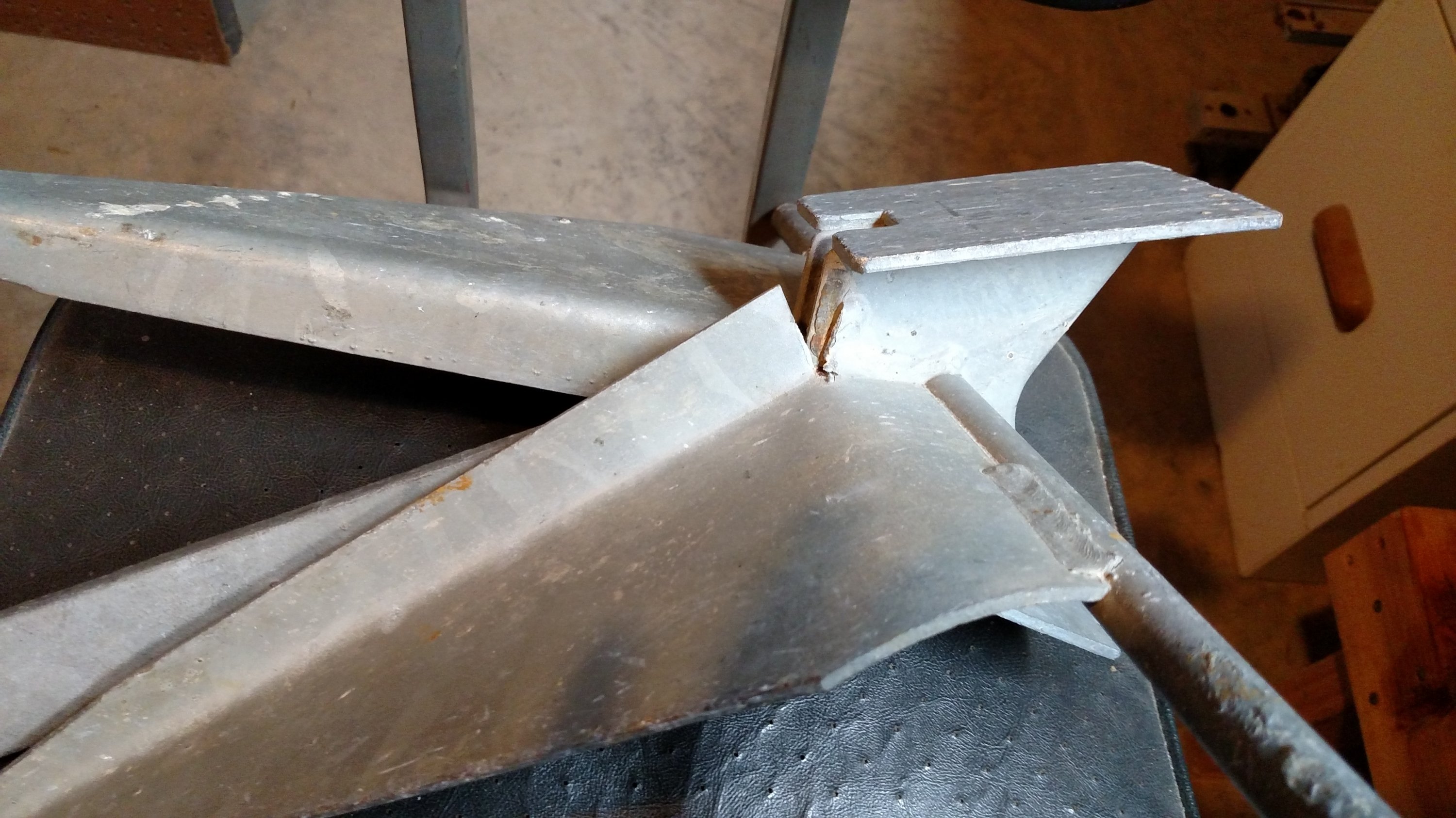

But that is not a place that should have a weld, is it? Has it been repaired? (I could easily be seeing it wrong).
Something seems wrong, because that is no strain for that anchor.
Mar 30, 2013
700
If the weld was a repair then it looks like they had it re-galvanized. A weld on galvanized metal is pretty obvious.
I'd have to look at my Danforth brand anchor to see if it has a weld in that area but that looks like a basic factory weld failure to me

A picture from farther away would be helpful to see just where that weld is. Looking at an old Danforth I have it looks like there is a yolk that attaches with a weld to both flukes but it is welded to the face of the fluke there is no slit in the fluke metal.

Except for the small lumps at the base of that separation, it looks like a break rather than a cold weld. Check the opposite fluke and see if there is a weld in that location. I have a Danforth to check but it is not here at the boat house anymore. Will check when at boat again. Chief

Here's a bigger picture to give everyone an idea where the break is located. It's not a split, it's the edge of the fluke where it should be welded.

Jerry: Checked my Danforth today and mine is made the same way with a weld on that overlapping piece. Definitely a bad weld! Chief

Look at the weld on the fluke to the cross bar. That weld is separating too. Danforth should definitely be notified.

Yup, that's what I found too. I needed to use it this weekend. It was straightened pretty easily. Ground away the galvanize in these areas and welded. Sprayed it with some cold galvanize, which should be fine in fresh water.

It is pretty clear the weld missed the joint and the stress on the cross arm fractured that weld. It is likely a robotic welding process so the likelihood of a lot problem is high. An ultrasonic inspection might be needed and/or a recall. High liability risk for danforth.
