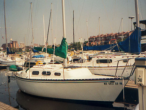

Peter, you appear to have the true plum of the H25 series: the trunk-cabin 'Mk 2' boat. I happen to love the earlier flush-deck/bubble-top versionfor its looks, but having recently seen one like yours I sort of regret not holding out for a Mk 2 boat. They are identical in all respects but for the deck and cabin mould.The four windows in your boat are similar to the two oval ones on the 27 and the ones on the early 30s. As far as I know they were completely manufactured by Hunter (not an off-the-shelf product, though they later changed that policy). The trapezoidal ones on my boat were designed by my dad and made by Hunter using aluminium trim rings and plexiglass.To change the plexi, remove the rings and plastic from the boat, scrape off the old bedding compound, and wash with acetone. Acquire some dark-grey 'smoked' plexi from a plastics guy (a Thomas's register will give you some sources) and use the old ones for patters to cut out the new ones. Re-install with new screws, flat washers and aircraft locknuts using 5200. Do NOT squeeze them all the way down for about 48 hours. Then screw them home tight. It should never leak.The worst part of the job, either now or in future, is removing the 5200. Use a combination of razor knives, plastic scrapers, acetone, or even gasoline (best solvent I know for cured 5200) and with patience and care you will achieve your results.JC 2
