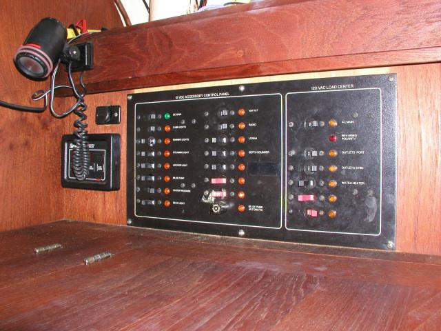

I want to replace several burnt out LED "on" indicator lights on a 1985 breaker panel. The size on the indicator lights currently available are smaller than the original ones in the panel, which I think might be 3/16". Does anyone know where I can find the old larger size?

Winton, I used these to replace all my panel lights in my 85 H34.. Ya have to do some soldering and heat shrink tube application , but they've has been fine for about 5 years now.. They are available in red and green as well..

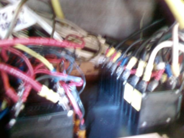

If ya look to the lbottom center in the fuzzy picture, you can see the row of little orange holders. They fit the original holes just fine. There is a little nut that holds them in place on the backside..
