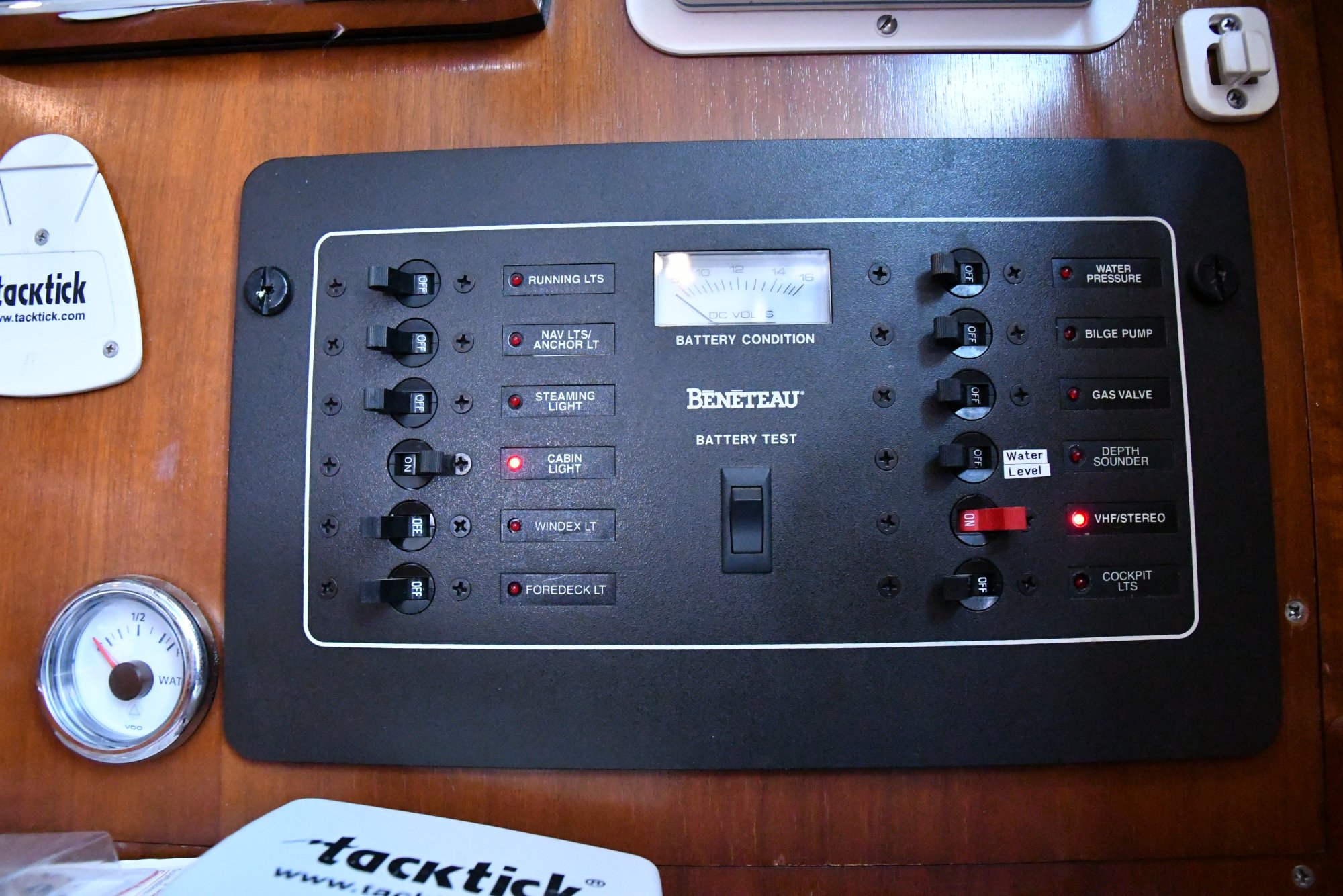

New owner...Does anyone know the manufacturer of the breakers in the panel? I am away from the boat and still getting to know her...2007 Marlow Hunter 336....ThanksView attachment 184330

Yes. I would give @Dave Groshong a shout at SBO.
I suspect the product is universal and a look at the BlueSea.com site could give you a number of choices to match.
Check out their Series - A toggle switch to see if it matches your panel.

Those (the configuration - screws, switch, LED,) look a lot like the ones in my panel, see the pic. Mine were "Bass Products".
Here is where I got all my switches/breakers for the panel. Can get various amperages as needed. All Marine Grade stuff.
They also have the little red LED’s that indicate whether power is on at the breaker and have standard labels or will make labels to fit the indent in the panel – all fit the factory panel.

I have a 1984 H27 and Blue Sea breakers are a prefect fit for my panel. Available at Jamestown Distributors.
