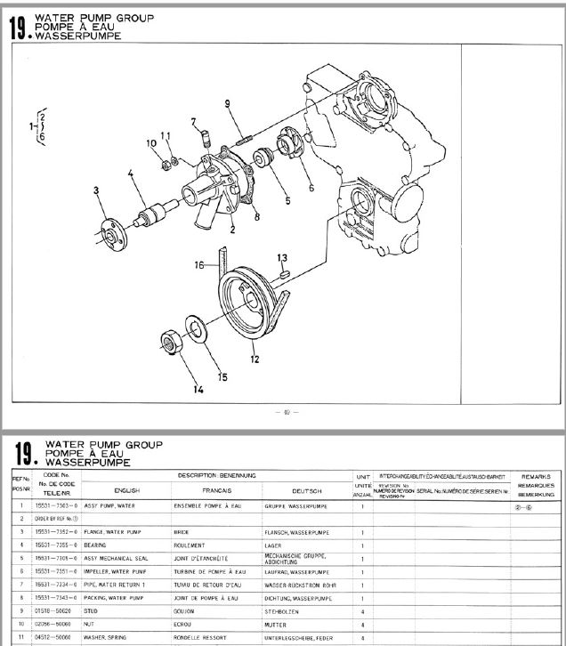

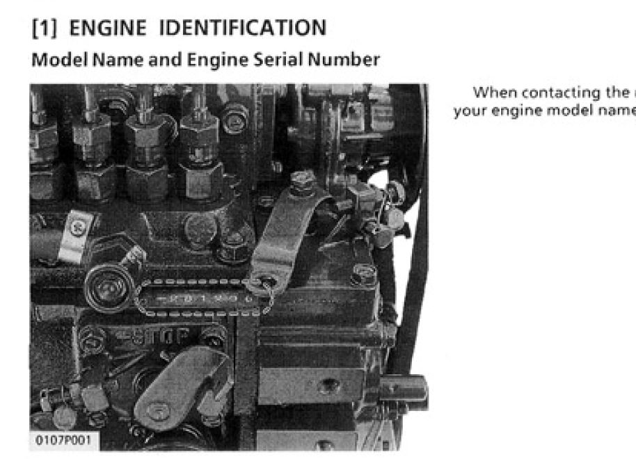

Taking a guess that your engine is a Universal M25 which is actually a Kubota diesel. The loacl Kubota dealer will be able to sell you a pump from a part number but typically won't be able to lookup a marine part. It helps if you can find the Kubota model D850??, D900?? D950??. There is a Kubota model and serial number in the vicinity of the high pressure pump. The data attached is from my old C30 and was a Kubota D950 equivalent. I think I actually bought my water pump from one of the auto parts places.
