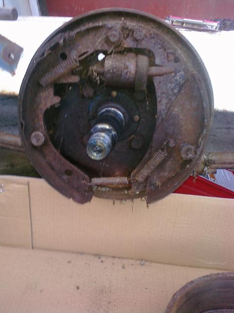

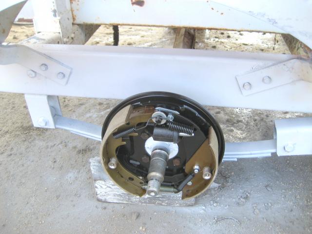

I have put a lot of work and money into replacing the brakes and backing plates and would like to keep them in good condition. I am primarily launching in salt water.

Frank the new brakes look good. I think if I was launching in and out of salt water on a regular basis I'd try the wash down kit or make one. I can't see where they would be bad.
Just curious about one thing. Since you were putting money into the old brakes did you consider switching over to disc brakes? That is something else I would want if going in and out of salt water or any water for that matter. I'm in the process right now of adding a second axle with the discs.
