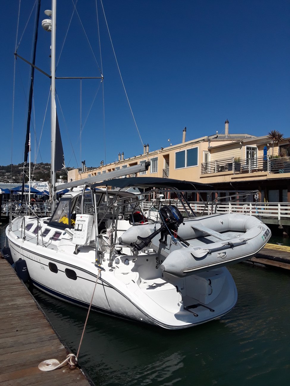

I installed stern rail mounted dinghy davits attached to the arch on my Hunter 386. I routinely sailed with the dinghy secured to it and 3.5 hp motor attached to the dinghy in the bay and down the coast. There are many manufacturers including Garhauer, Kato, Forespar Nova, Edson Marine, Mar-Tek, Ocean Marine, St. Croix, Sailboatowner, Baysystem, etc. made of 304 or 316 stainless. Each has weight load limits and special mounting requirements.
