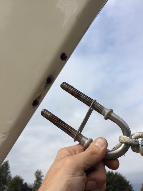

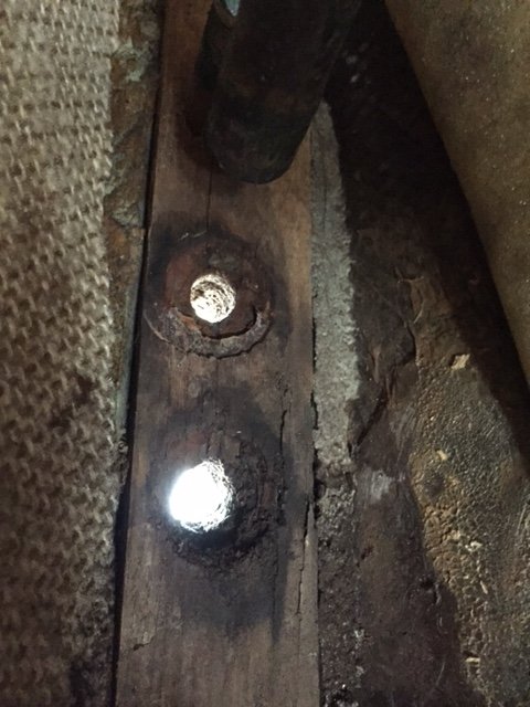

While inspecting my new 84' O'day 26' I found the wooden block in the very forward interior of the bow that is the hard point anchoring the bow U bolt is rotten...
-The old wooden block has been removed
-I have rebuilt the wooden block to the proper dimensions.
-The foam/sealant remains in the bow still retaining the receiving shape of the old block
My questions are:
Should I leave the original foam/sealant and add new foam/sealant in and around the location?
Should I chip out and remove as necessary the old foam/sealant and replace?
What is this foam/sealant stuff? What should I use?
Thanks,
Scott

I would clean out everything down to the fiberglass. Seal it with 5200. The hull has no wood in it, so remove anything that is bare wood or not glass. Make a block, but encase it with epoxy. Over drill the holes in your block, fill them with epoxy, and redrill them the correct size. Thus, the bolts are passing through only epoxy, and water cannot touch the wood.
Epoxy your block in place, or glue it with 5200. I would use the 5200.

I agree. A wood replacement can last 30 years but a SS or FG backing plate would normally be better.
For that bow eye bolt I think a wood blocked can be shaped to fit tightly easier than SS or FG. Then over drill the holes, saturate/seal with epoxy and epoxy in place will be fine just as you recommended.
