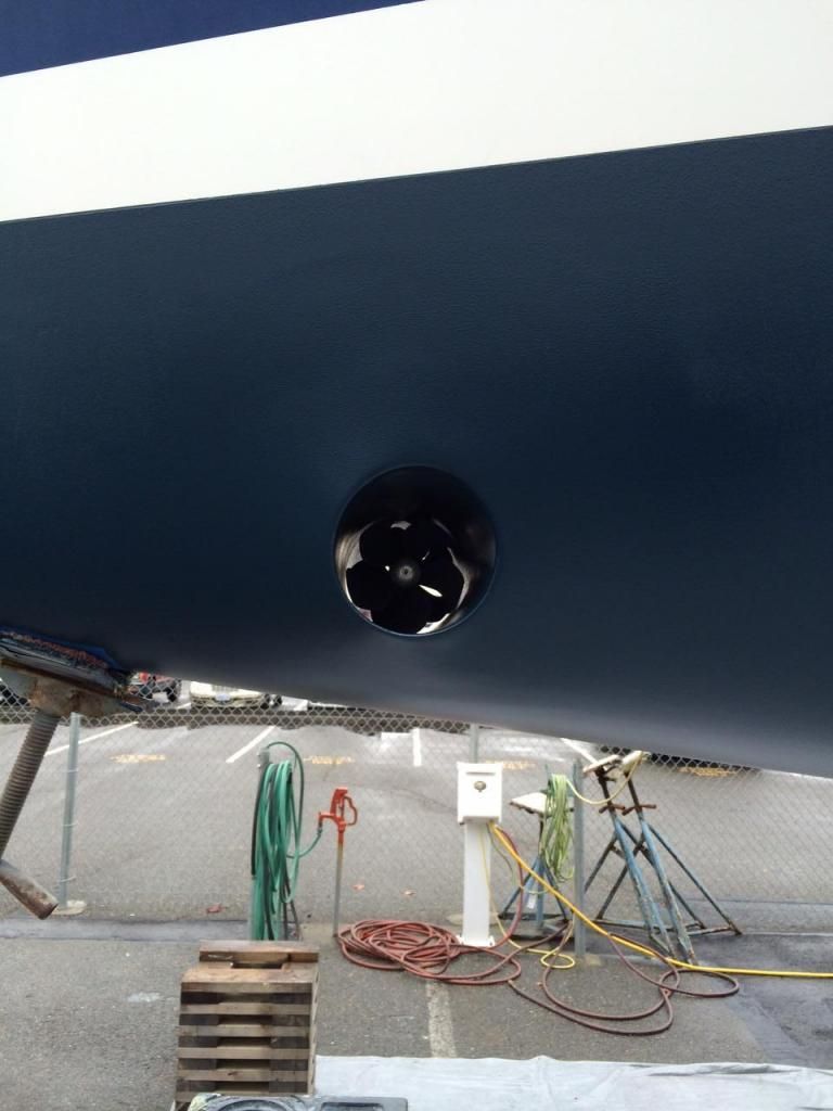

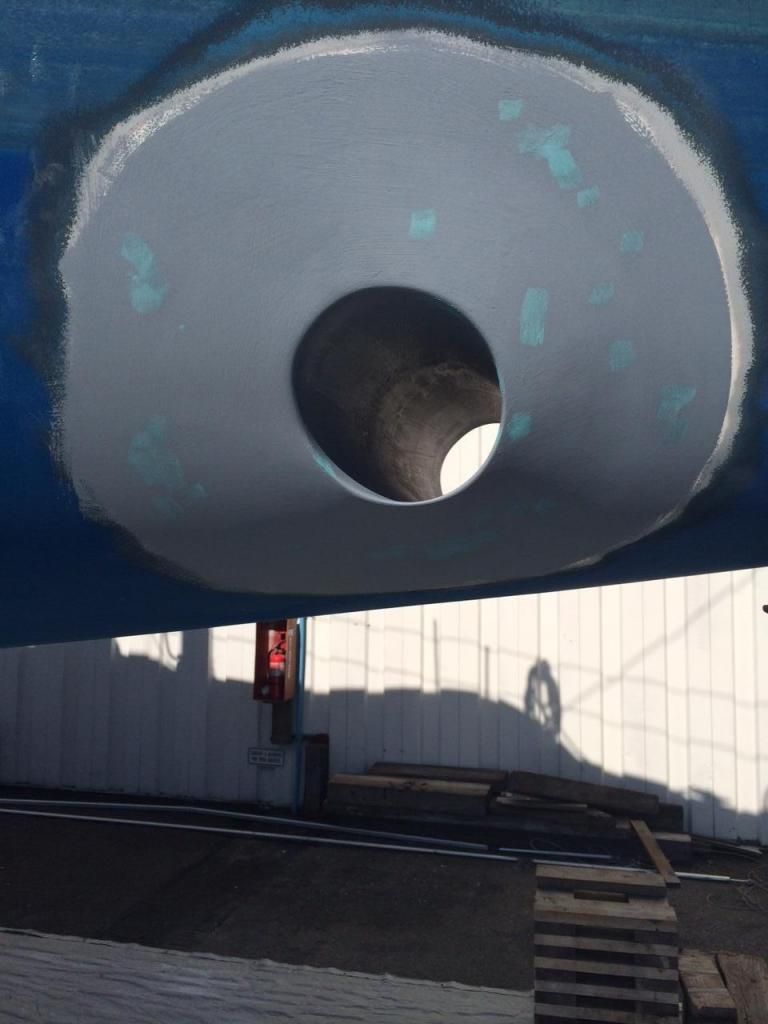

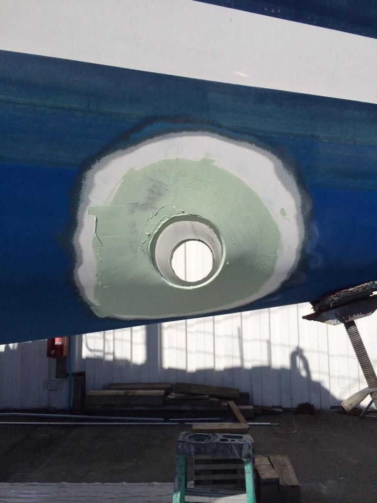

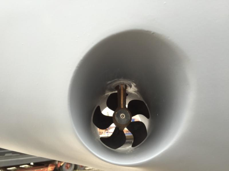

I have a H460 that's on the hard getting a bow thruster installed as I type this message (Side-Power SE100/185T). Having maneuvered the boat without a thruster I can say that it will definitely take the stress out of docking and make sailing more enjoyable, though I strongly suggest you learn to master docking without one in the event that it doesn't work, after all it is a boat and we know that the unexpected always happens.
I would echo most of the previous posts in that a tunnel thruster is your best option even if the cost is higher. I would recommend that you find a good installer that has a very capable fiberglass specialist as you will need to create a "spoiler" on the leading edge to channel the water around the tunnel opening, this will mitigate most drag. Also it is important to get the thruster installed as low and far forward as possible to provide the most lateral movement and prevent cavitation.

Thanks for the reply and sharing your pictures. That must have been gut wrenching to see them drill that cannon ball size hole in her bow. The finished job looks great, you'll be doing pirouettes in no time.
I'm still researching and comparing between the Hunter 41 or 44 DS 2006 to 2008 and look for a tunnel thruster or none at all so I can install one later.

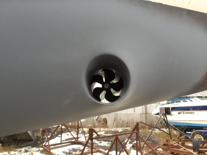

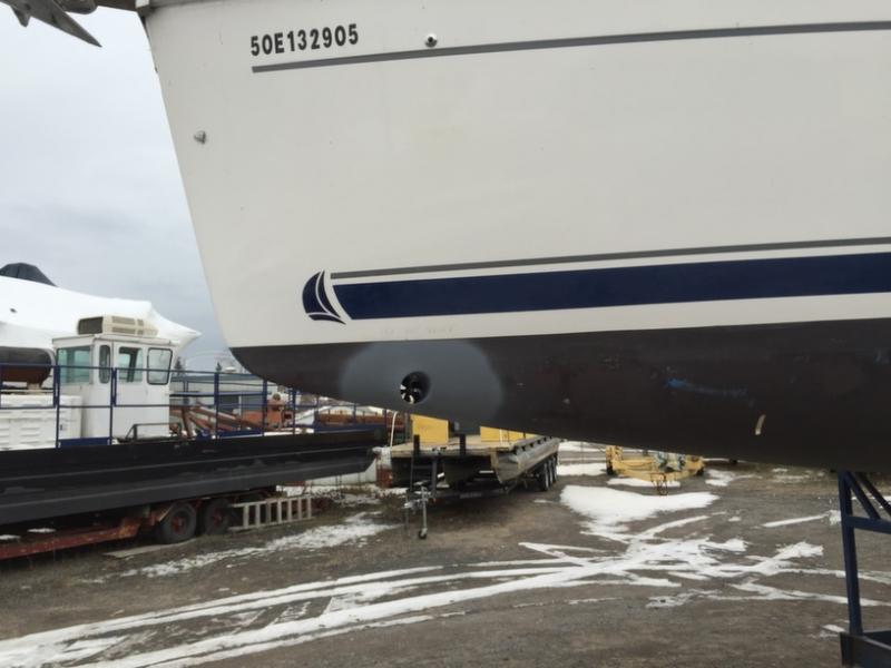

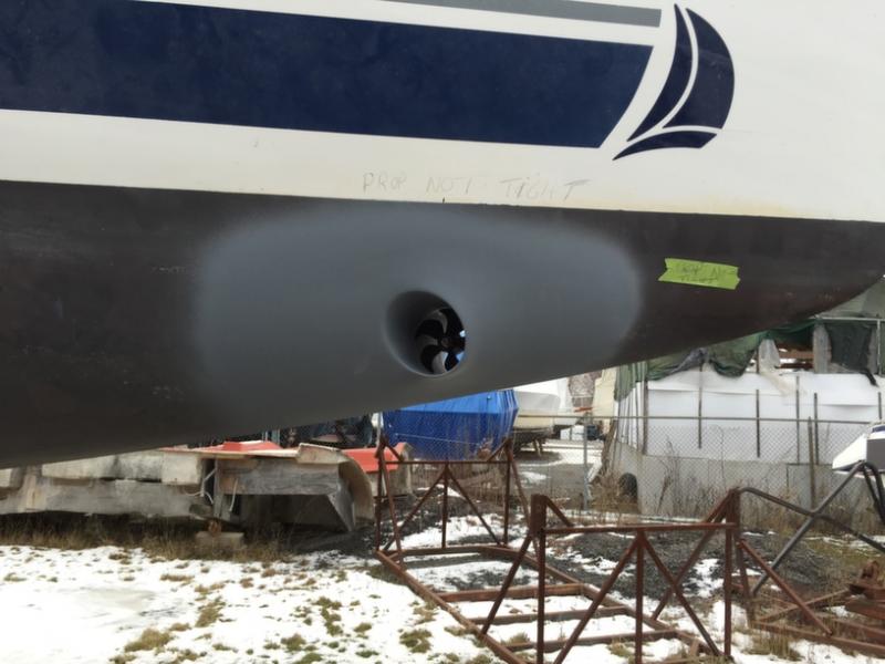

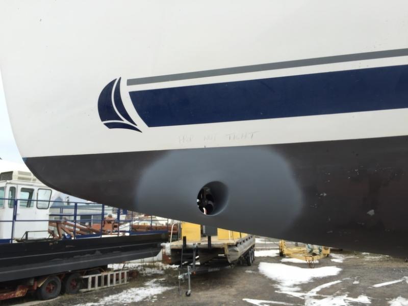

The installation of our bowthruster has just been completed, we are actually going down today to have a look at it. I will try to take some pictures. We are having the bottom redone as well so it may still need a bit of cleanup to be totally complete.
To answer your question, we had ours installed by Wiggers Yachts in Bowmanville ON, (google them - long history of building quality racing yachts) and taxes in it was approximately $7200.00 which includes everything including winter storage, haul out and launch, battery cables etc.
Shop around, I also received quotes in the $11,000.00 range that didn't include storage etc.
