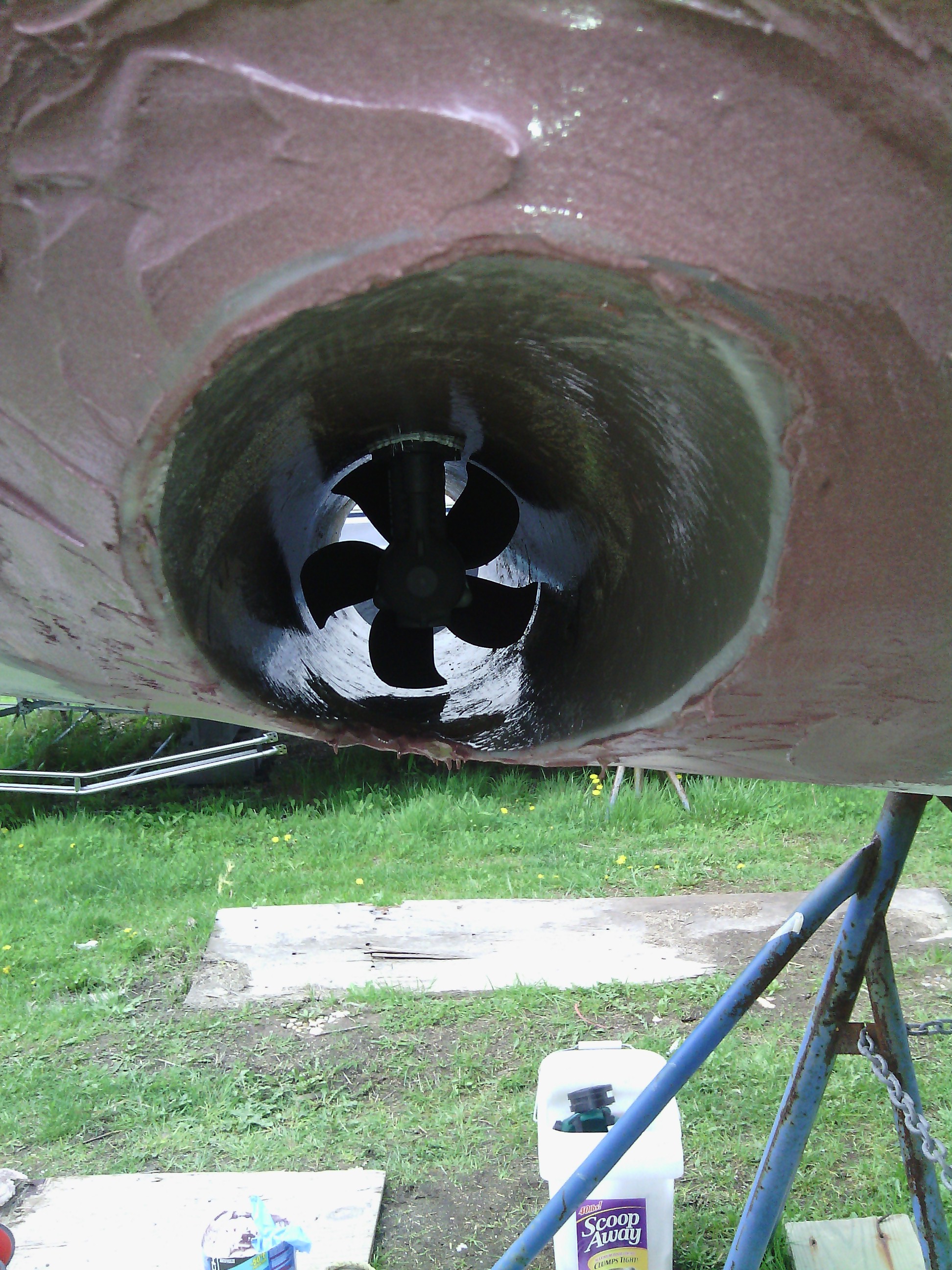

I installed by myself a Lewmar Bow Thruster in my 2007 41DS and followed Hunters' instructions explicitly. There is only room for the 6" tunnel. I have been satisfied with the performance of the installation. I can't say at what wind speed it will point the bow, but it has made docking much easier. After installation I would never have another boat of this size without one. I am going to try to find pictures of the installation and post them.

BAVARIA C57 Greenport, NY
Some pictures of the install

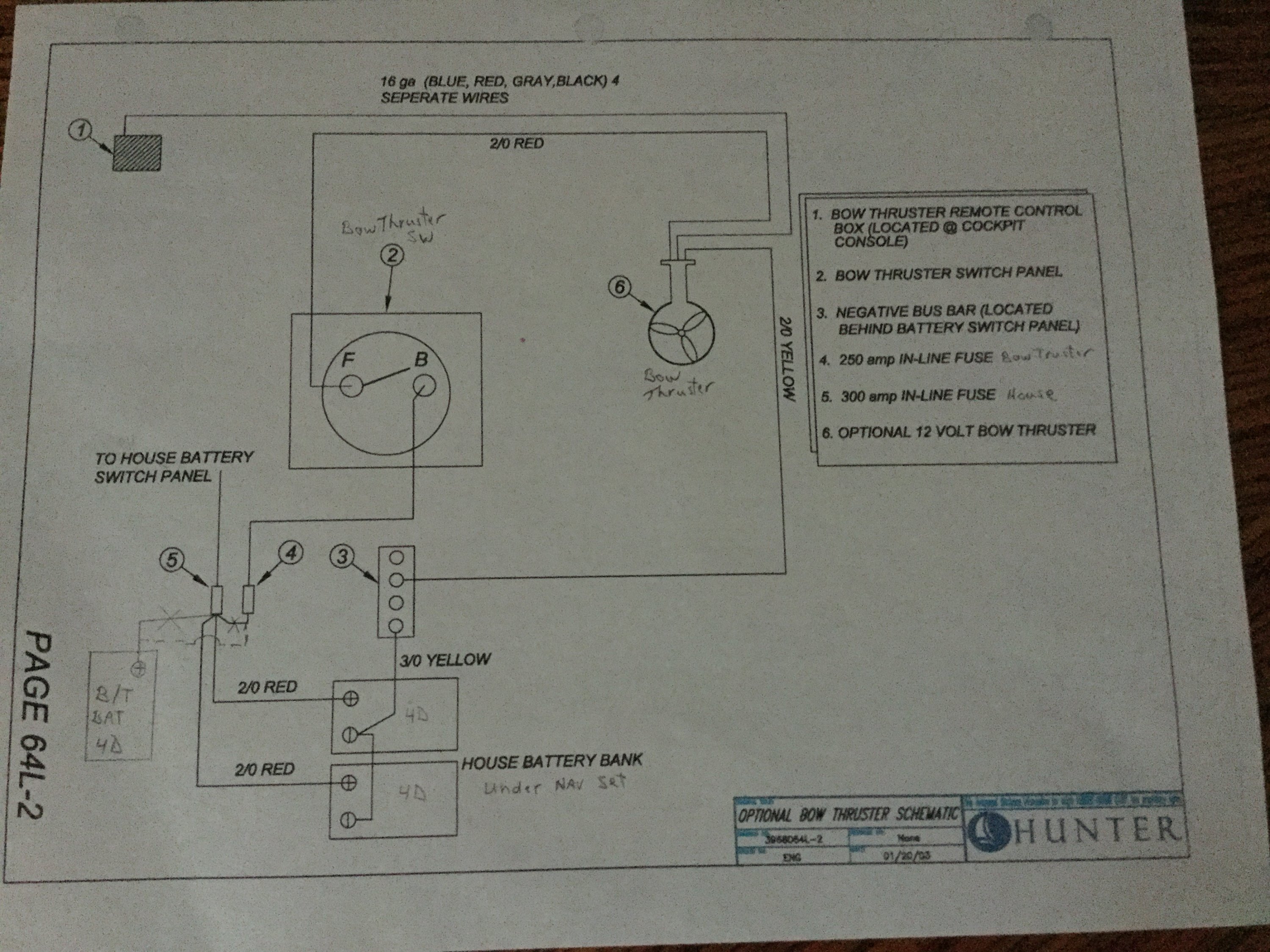

I'm curious, how is your battery connected to your bow thruster. Is it a dedicated battery or is it tapped off the house bank?
The P.O. had 2 4D House batteries under the nav seat and 1 4D battery under the floor. All 3 were connected to the house 300 amp fuse and before passing through fuse it is jumped over to the bow thruster 250 amp fuse then to the bow thruster main switch.
Having just bought the boat last year I should've known all the batteries were on their last leg.
I'd like to replace the house bank with true deep cycle 6 V golf cart batteries. The problem is I don't think that's a good choice for a bow thruster that requires high current like that coming from a start battery or 4D.
I was thinking of replacing the two house batteries under the Nav seat with 4 golf cart 6 V deep cycle batteries and dedicating the battery under the floor to the bow thruster only. I might add a switch to allow it to be couple with the house in times of need.
Maybe I should add this is a new post, but has anyone attempted something like this?
TFlight what did you end up doing with this, I have the same scenario right now, our 41 DS is on the hard for the off season, my (3) Exide 4D batteries are weak (apparent with after a load test), could last another season but I am thinking about changing them out for 6V Trojans T-105's and I have the same question.
It seems the high current draw from a thruster is not good for true DC batteries, just wondering what you ended up doing. I am considering doing the same circuiting and using a Dual Purpose D4 primarily for the thruster and 4 x 6 V Trojan's for the house, linked through a switch in case the 4D is needed in the house circuit. I have noticed as the season was drawing to a close the thruster would become ineffective / stall on high current after a very short burst.
My current dock is upstream of (3) bridges on what can be a very busy river, lots of folks waiting for the next bridge to open, so the thruster is a necessity when things get crowded, a couple of short bursts to hold position, trouble is after only a few short burst the voltage drops down low enough that the thruster will heat too fast given the increase in amp draw.
