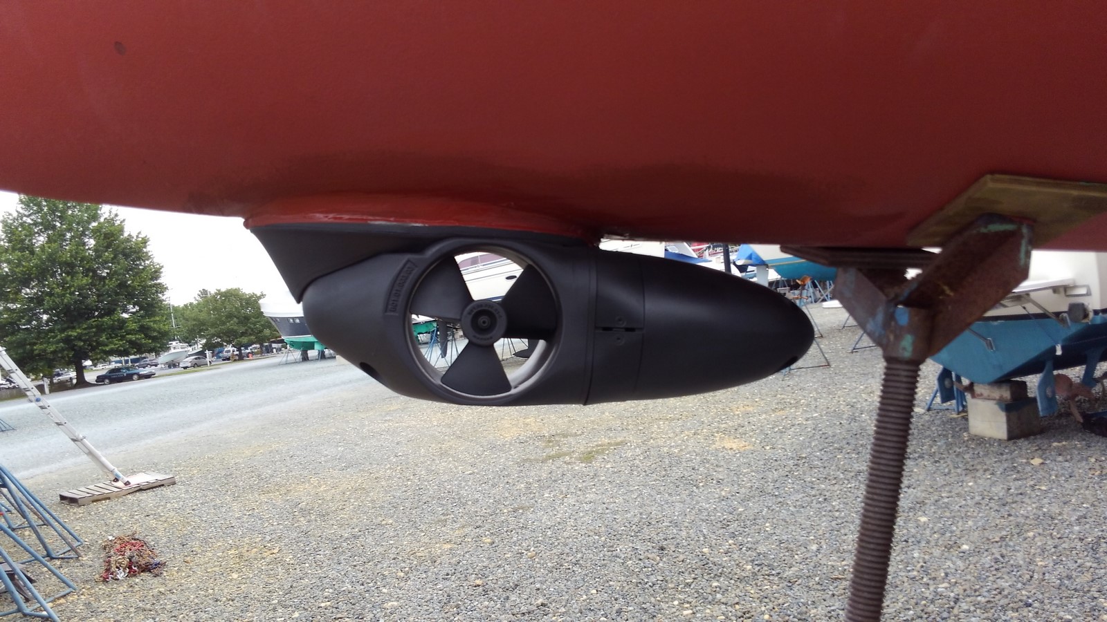

I had an external thruster installed at Harrinton North on my 410. Could not be happier with it, saw no performance difference.

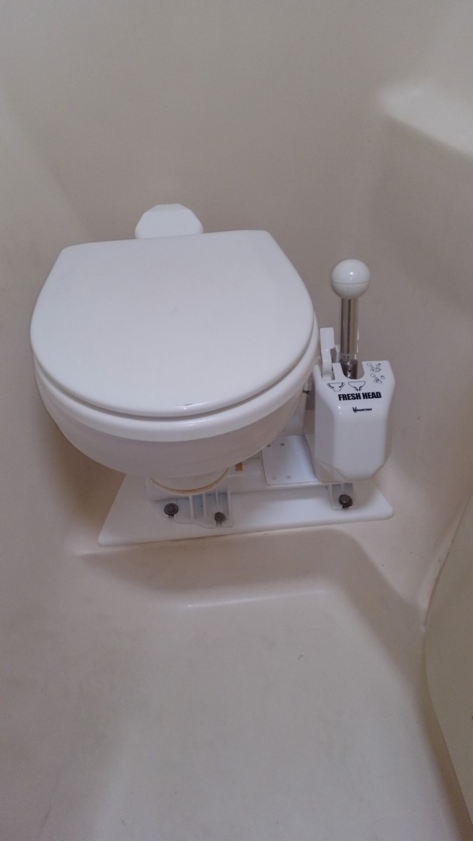

I haven't done it, but know people that have. It entails raising the head on a pedestal to accommodate the thruster head. Fiberglass work.
I personally haven't found the need. My recollection it was about a $10,000 job

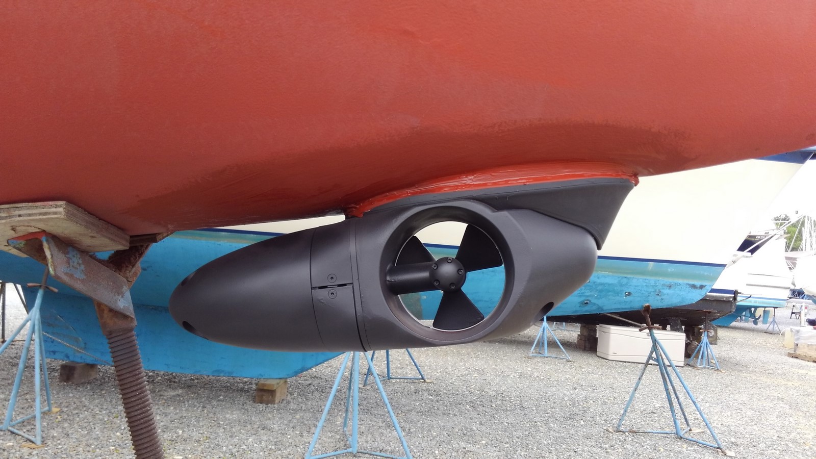

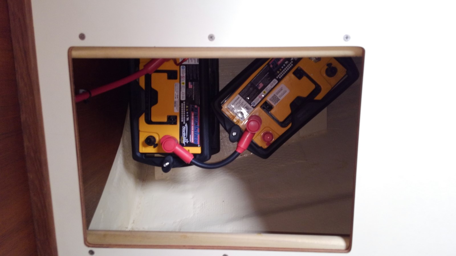

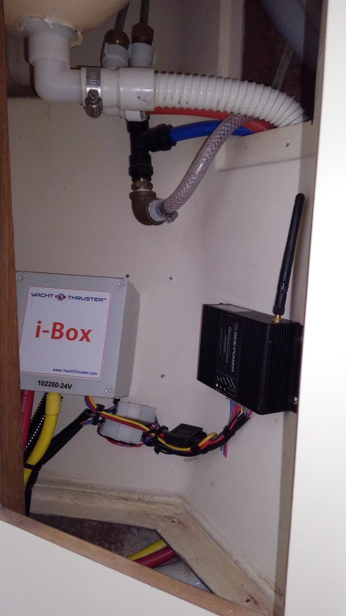

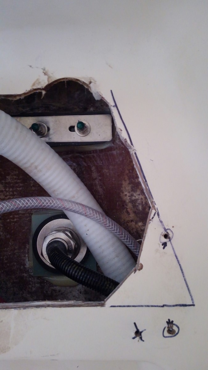

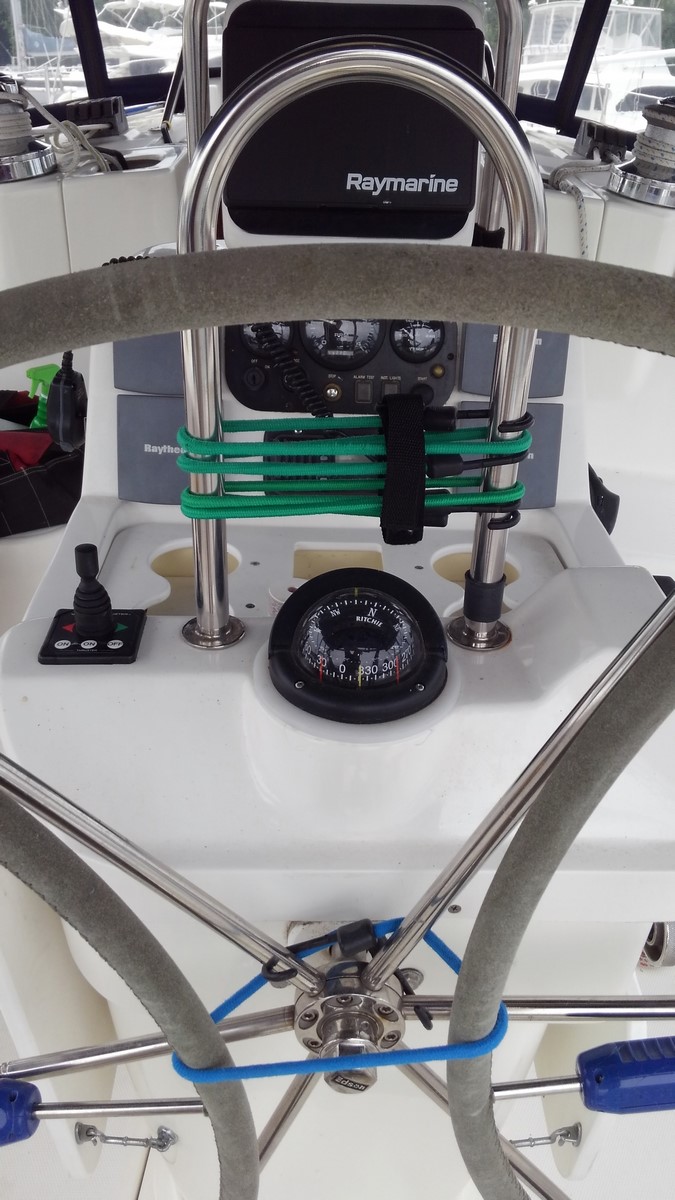

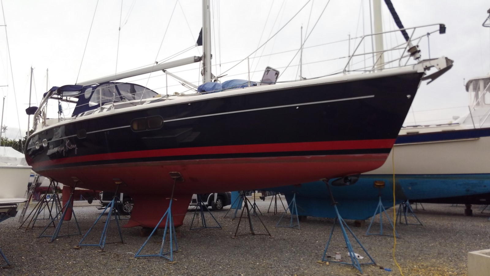

Could you post some pics of the installation and how it looks out of the water? Did you add an extra battery?
