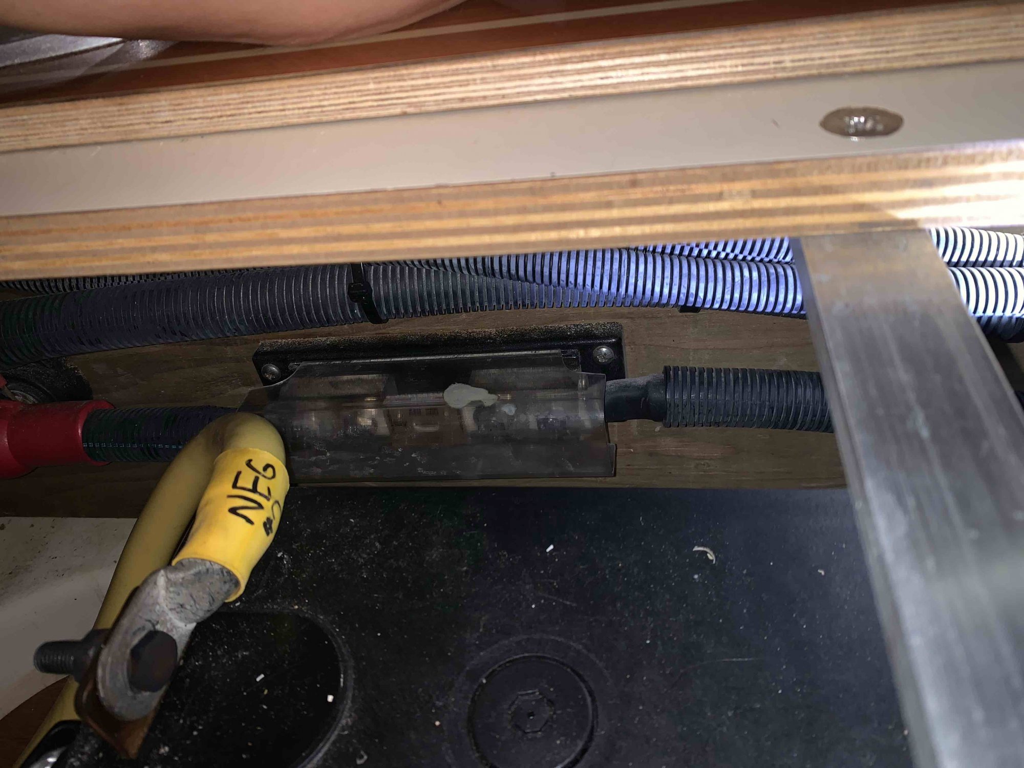

Hello everyone, hope this find you safe and in good health.
Does anyone knows where the 300 amp fuse for the bow thruster in the Hunter 49 is located?
Is there an schematic plan for the bow thruster instalation in the H49 2009?
I changed it before but it was very long ago and I can not find it ....
Thanks
MIguel

Hi Miguel,
These 2 threads and attached installation pdf should help. Let me know where you found it.

Hunter 49 60803 Lake Erie
there are two places that can cause bow thruster to go bad .. the fuse is one which is on the starboard side at the top of the bilge about in the middle of the opening .. the other is the automated switch that turns on when tickled by the the cockpit switch .. it turns on and allows power to run forward to the thruster so it can operate ... the switch is located on the bilge opening as well in the very back up high right under the floor... mine went bad and I replaced it with a manual on off switch verses the automated switch
