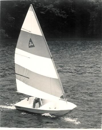

Just got a dinghy in trade for a 12' Landau Jon Boat. It is a sailing dinghy. Made by MFG model: Challenger 12'. It came with all the parts needed to sail including a trailer. I got the Jon boat a year ago for free when I bought a trolling motor on Craig's list. Had to spend $80 to get all the leaking rivets spot welded.
Now my question. The boat has a raked back mast/sail plan with a boom. Sail area is approx 75 sq ft. It doesn't appear to have a fore stay. Not sure as I really haven't had time to look at it as I am house bound this winter after a complete hip replacement.
I have been speculating about the advisability of righting the mast to a vertical mast and adding a fore stay to a bow sprit and putting on a hank on jib to give the little boat more sail area. I enjoy experimenting with this kind of thing. Since most of the modifications would be fairly simple to make and cost very little on an almost free boat.
Here is a pic of the boat.:D
Of course mine doesn't look so nice, quite dirty and needs a lot of clean up and a nice coat of paint. It does have very hard chines, resulting in a look like the old tri hulled power boats of yore. My sailing friend Dave tells me that it would resist turning turtle well, but when it did it would do it with a bang. I would add 280 lbs of internal movable ballast. With SWAMBO on board, we would have about 500 lbs.

I'd guess that a dinghy that's been designed by a competent manufacturer was probably designed to and test with the correct sail plan. To alter it and add 25% more torque to the top of the mast might be an invitation to swim. If Lake Pepin waters are warm and snake free, I'd go for it. Wear your PDF and file a float plan. What's the worst that could happen?

That boat is cat rigged.... the mast is placed well forward... adding another sail foward of the current mast location will create some challenging balance issues. I would consider moving the mast back to allow a more equalized sail plan, if the extra sail makes the boat unsailable.
You might study the differences between the Laser and the Laser II for a better understanding of the changes you are considering.
That said...... I highly suggest you actually sail the boat before you start making changes. You may find other areas of improvement you hadn't previously considered.

Tom, In the last 2 years I picked up 2 small 14 foot boats made by Catalina. One has a standard main/jib sail plan and one is a catboat rigged boat like yours. They both have the ability to plane and are almost more than my old body can keep up with.
After you sail yours I'd be real surprised if you added more sail.
