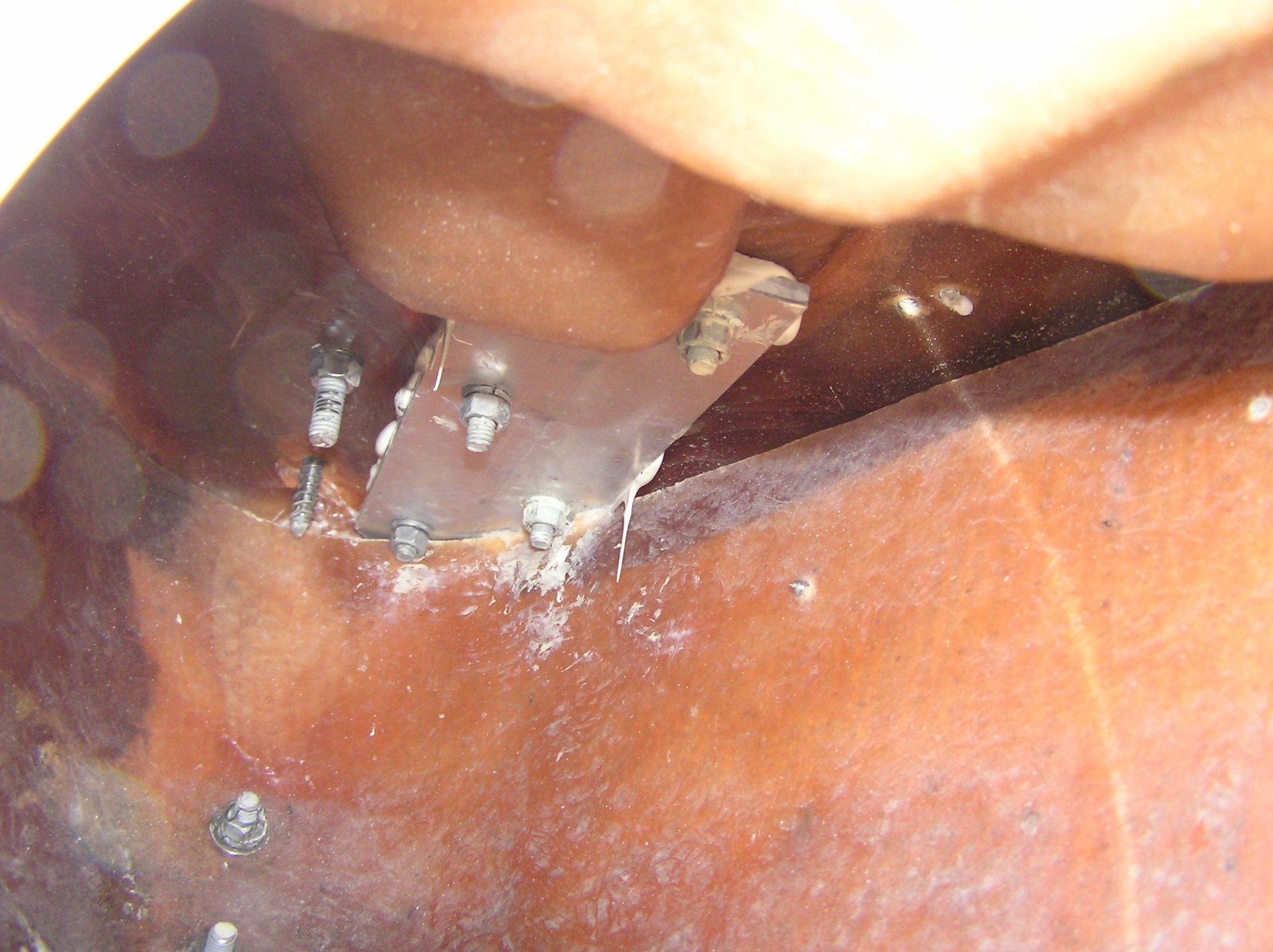

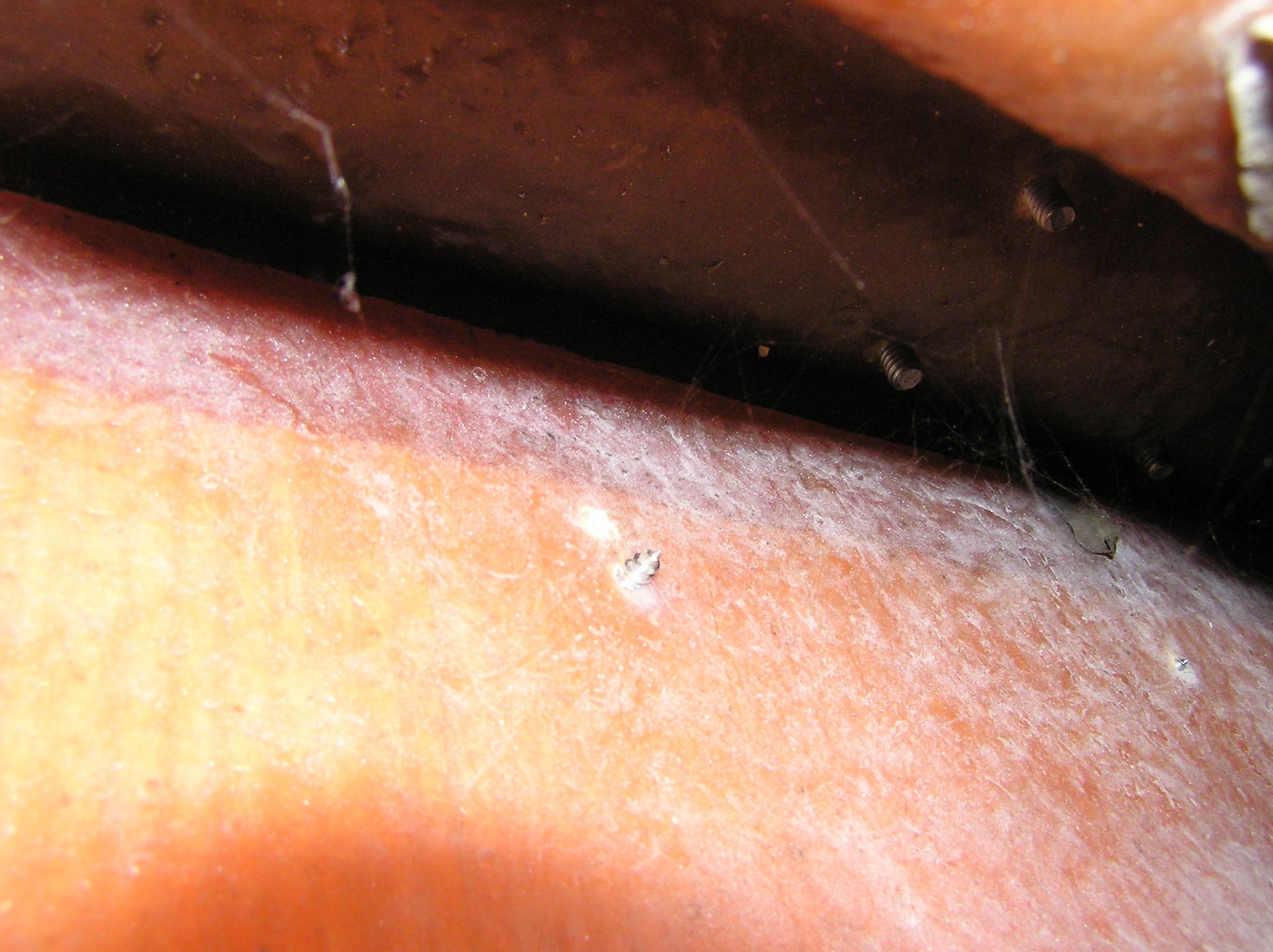

Good morning,

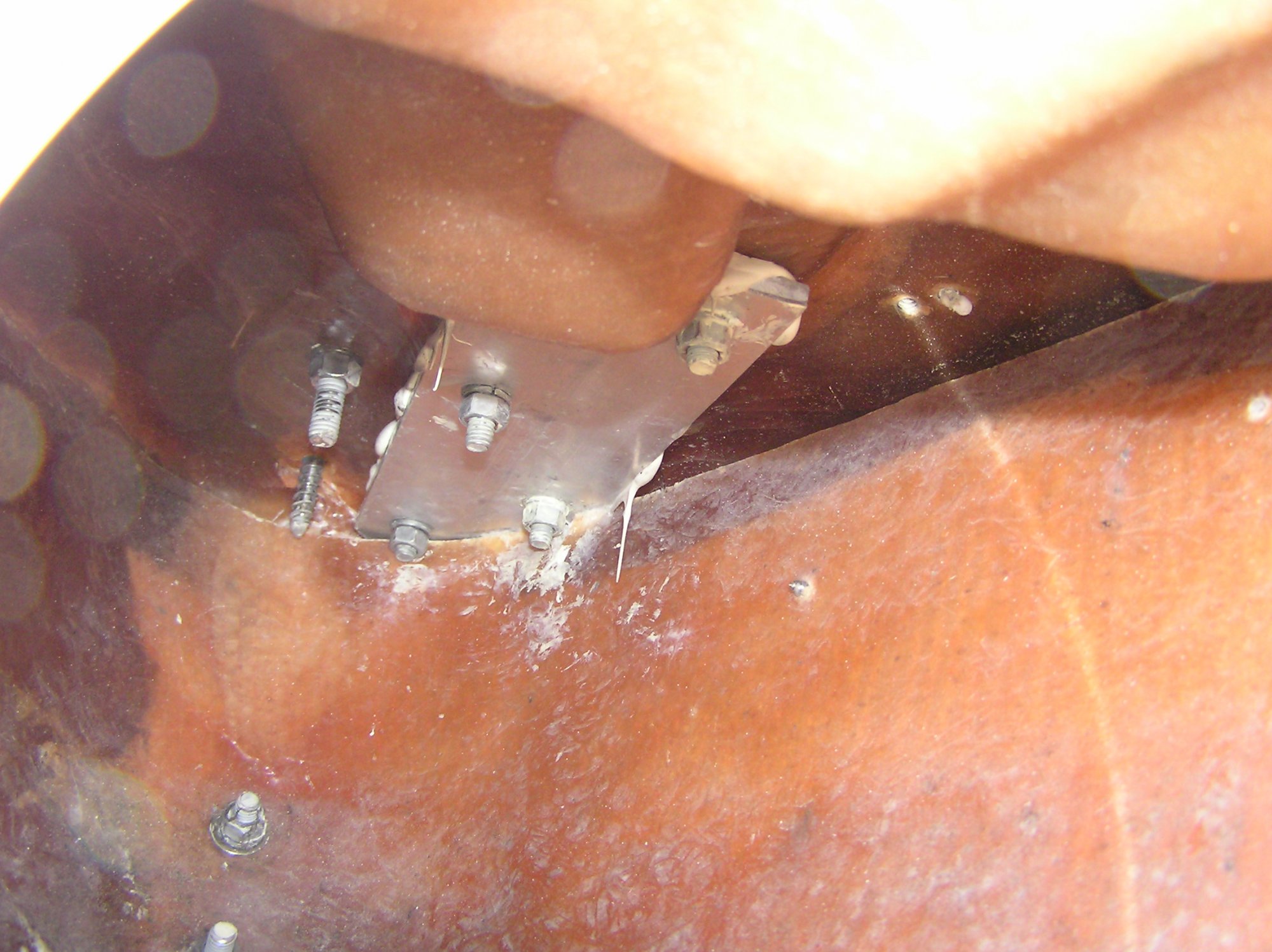

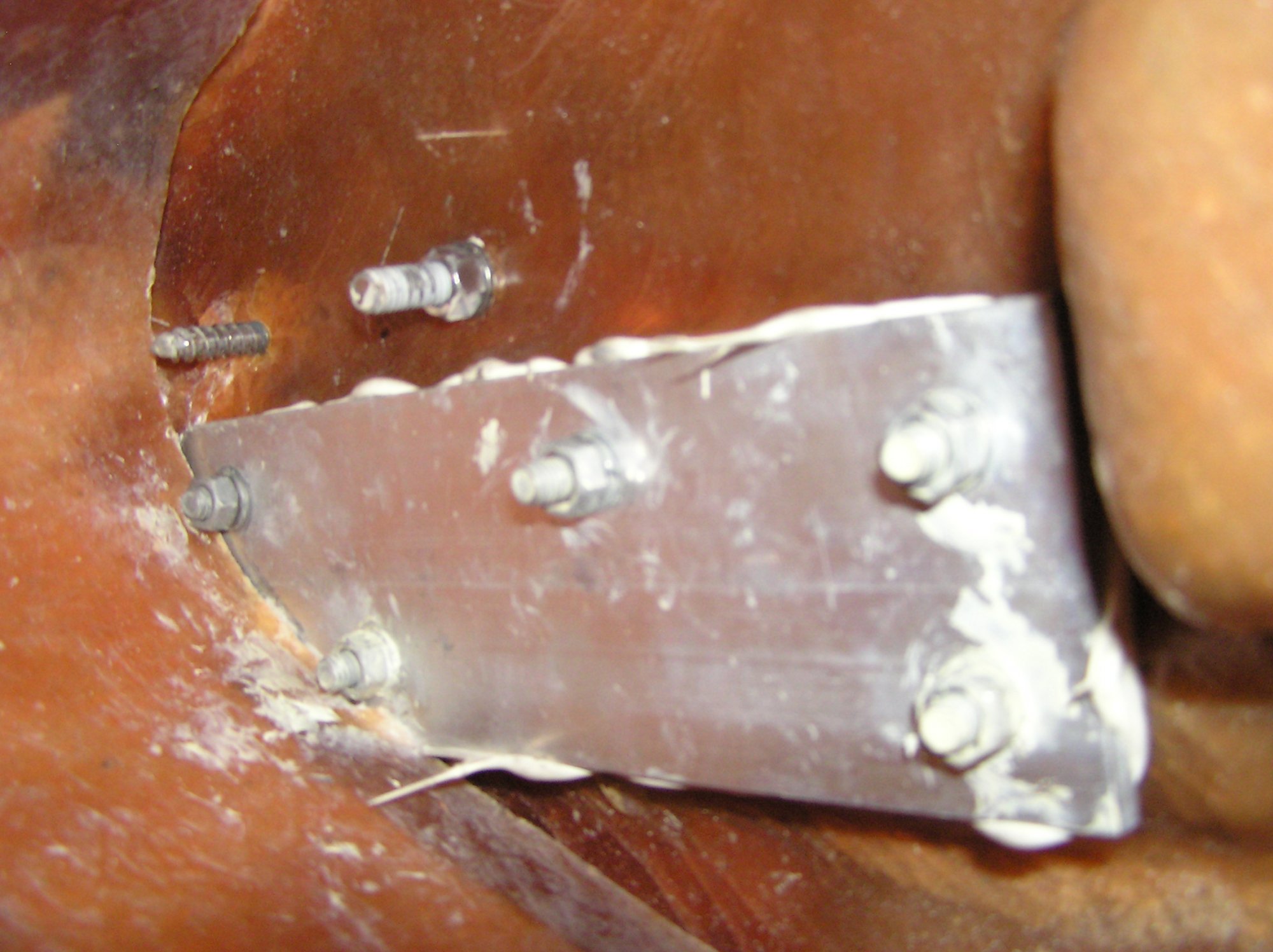

Have any 310 owners removed the now rail? It's the last piece of deck hardware that I need to pot and bed with butyl. I'm trying to figure out if the rail is bolted down with fender washers and nuts or into a tapped plate. I can see the end of the most stern bolts looking up in the corner of the crew berth but I can't see where it comes through the deck.

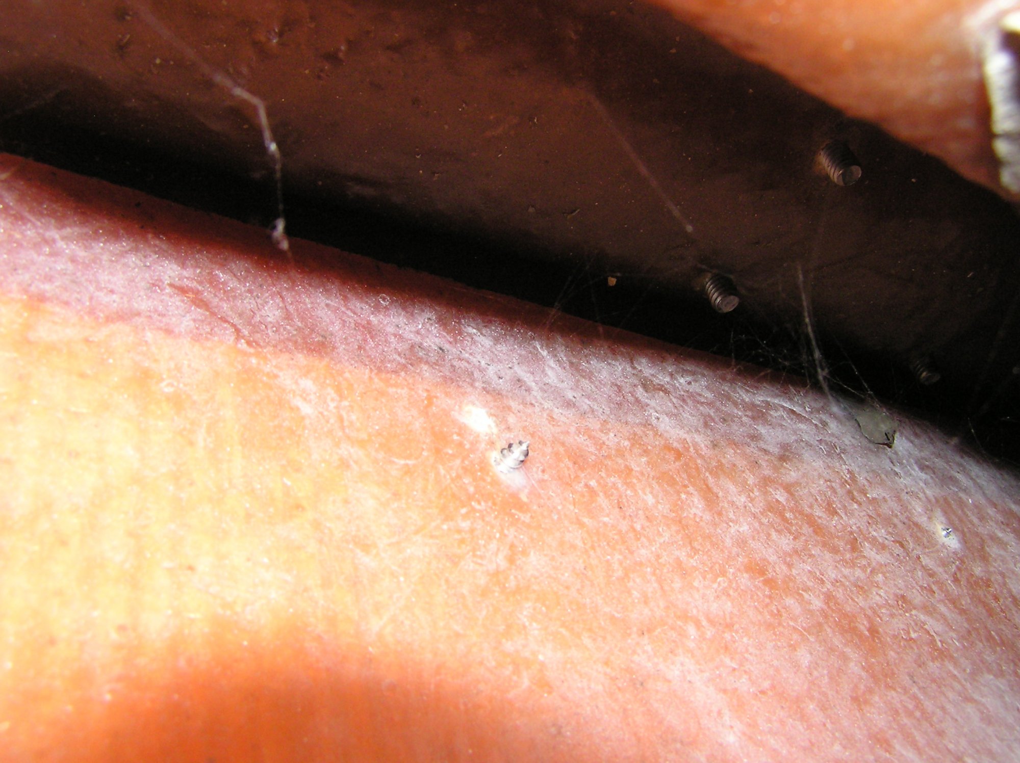

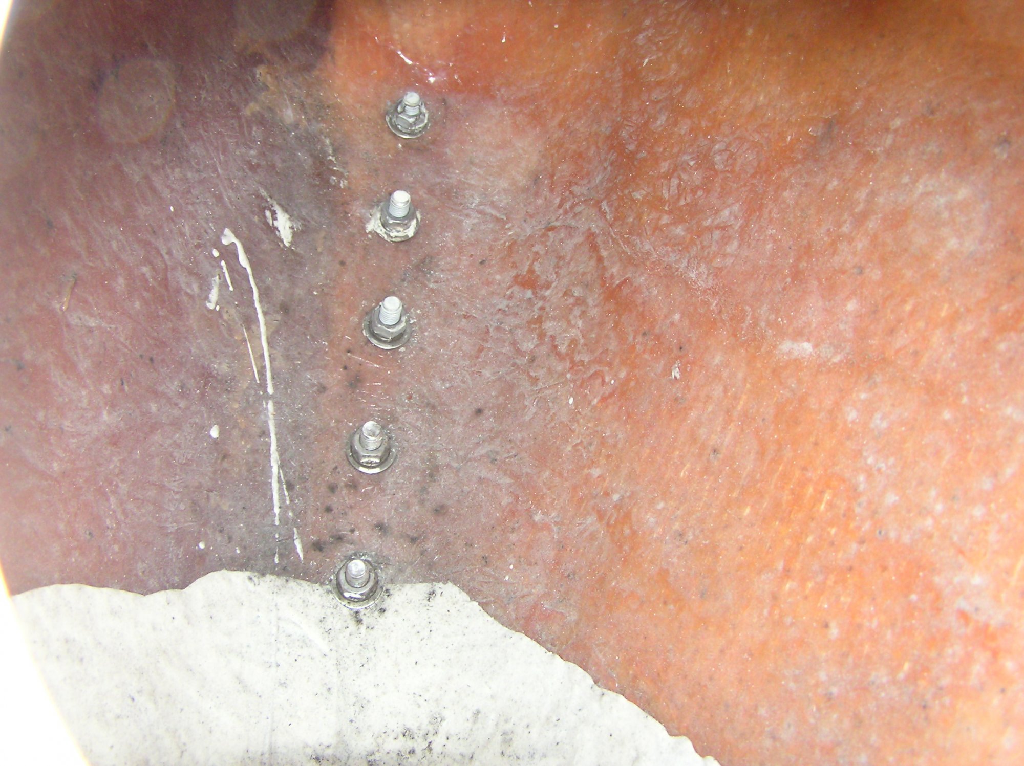

Jesse,

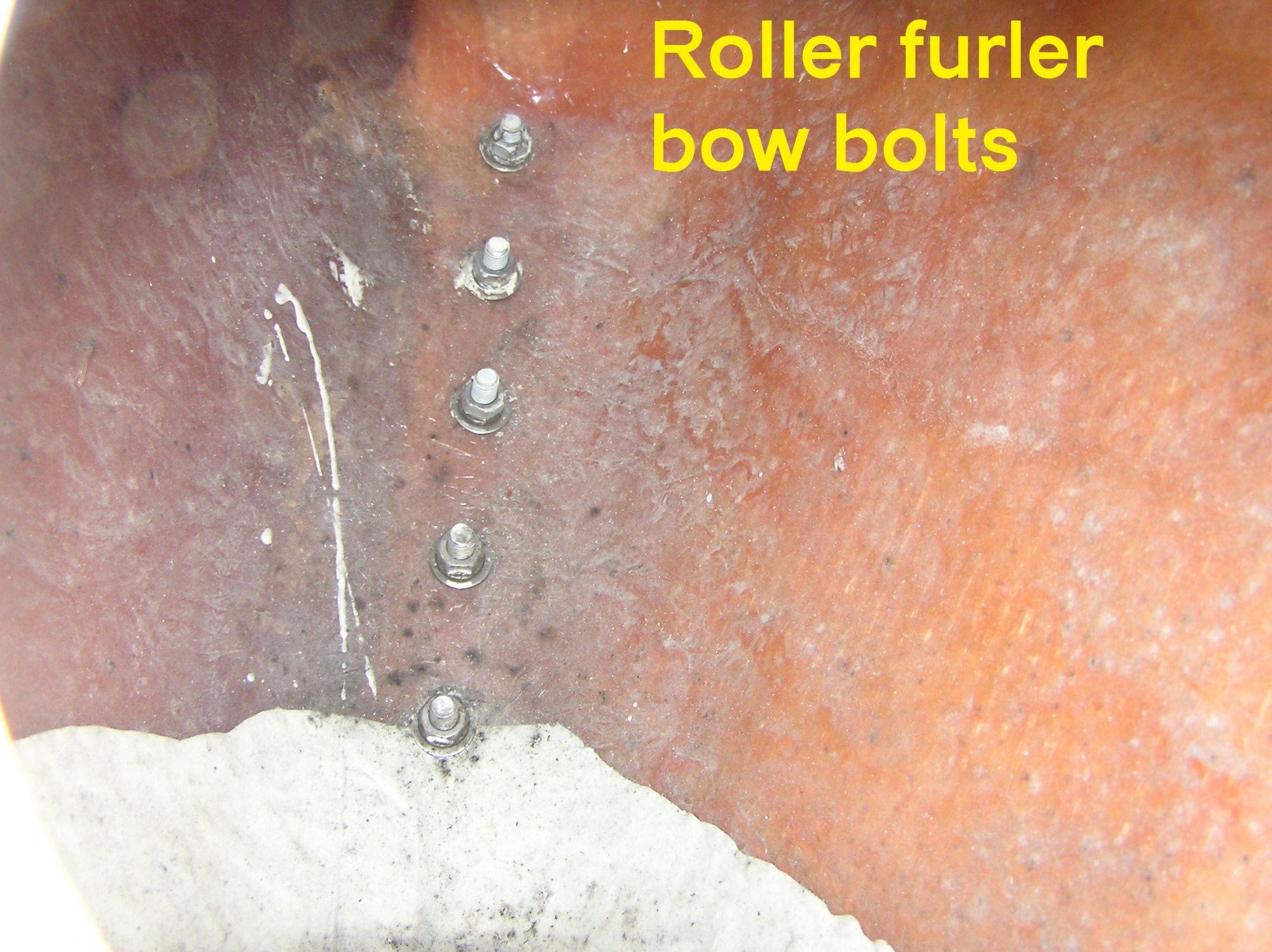

I know each boat can be different but on my C30 I could see a couple of the stern bolts of the bow sprit just poking through the deck into the v-berth. The area the bolts were was noticeably thicker than the surrounding area. I scratched a bit of the sprayed on paint/gel coat around one of the bolts and it was shiny, confirming an embedded plate.
Just an idea on how to inspect the area.

So, 9p out of the 10 bolts holding on the bow rail were tapped into an imbedded metal plate. On one they either missed the plate or drilled too large of a hole so they put a washer, lock washer and nut on the underside. This location happened to be almost perfectly in line with the bulkhead that is the forward wall of the vee berth. We couldn't get a socket on it. I could barely touch the bottom of the bolt. Somehow my Bride was able to get a box wrench on it and we were able to get it off. Catalina did this to us on one gate stanchion bolt too. But that was the one behind the head and it was easy to access the bolt.
All 10 bolts are in solid glass. So no potting is necessary on these. So tomorrow morning we will counter sink the holes, clean up the old polysulfide and begin bedding with my Bed-It Butyl Tape. Getting a nut and washer back on that bolt will be fun.

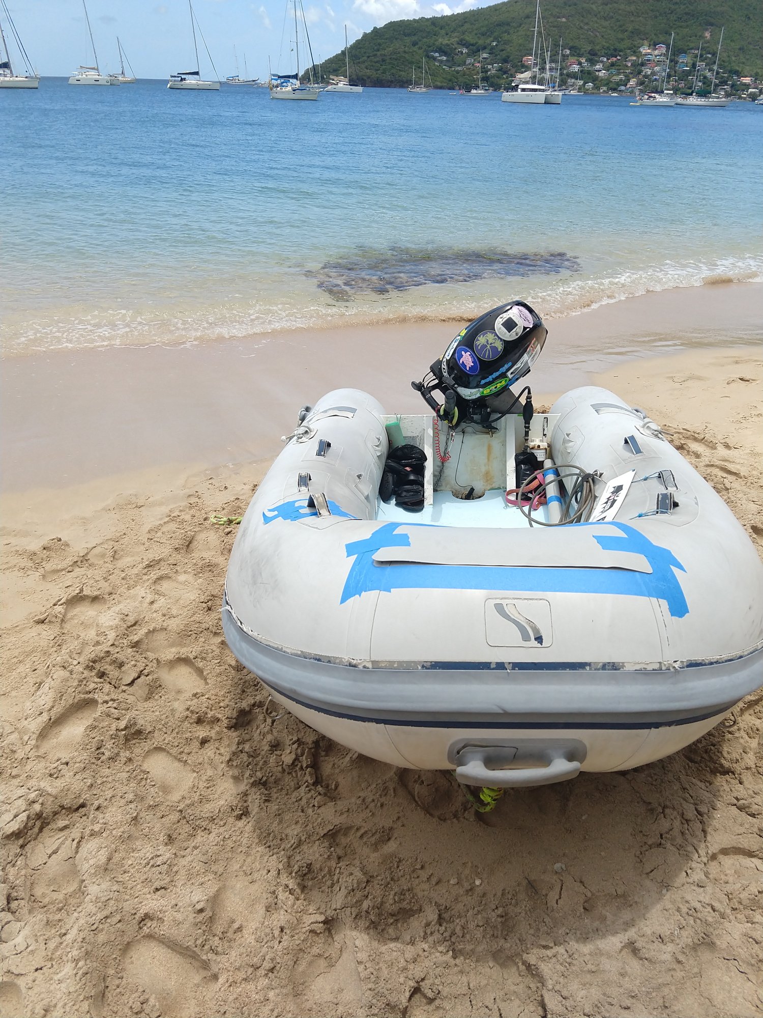

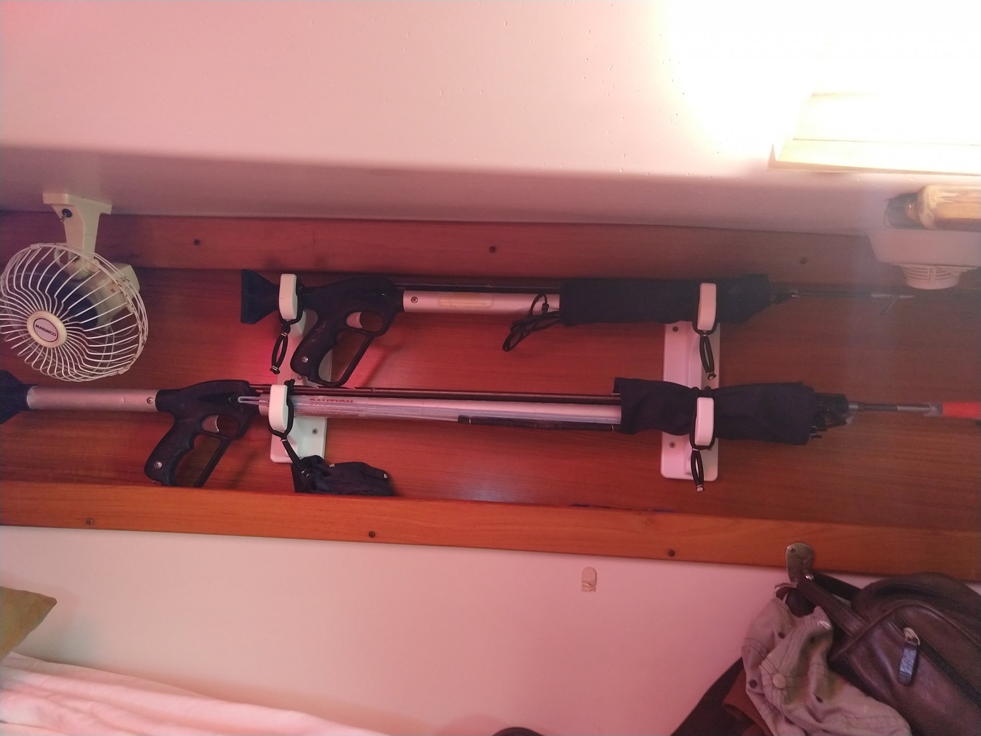

We have already rebedded everything but the chain plates, potting every place we go through a cored deck, rebedded the main hatch with adding through bolts throughout, refit on the dinghy including chaps and a new nonskid floor, finishing up some other projects like the arch, lithium batteries, new electronics, speargun rack, trying to find a place for my massive freediving fins, and so many I'm forgetting.
