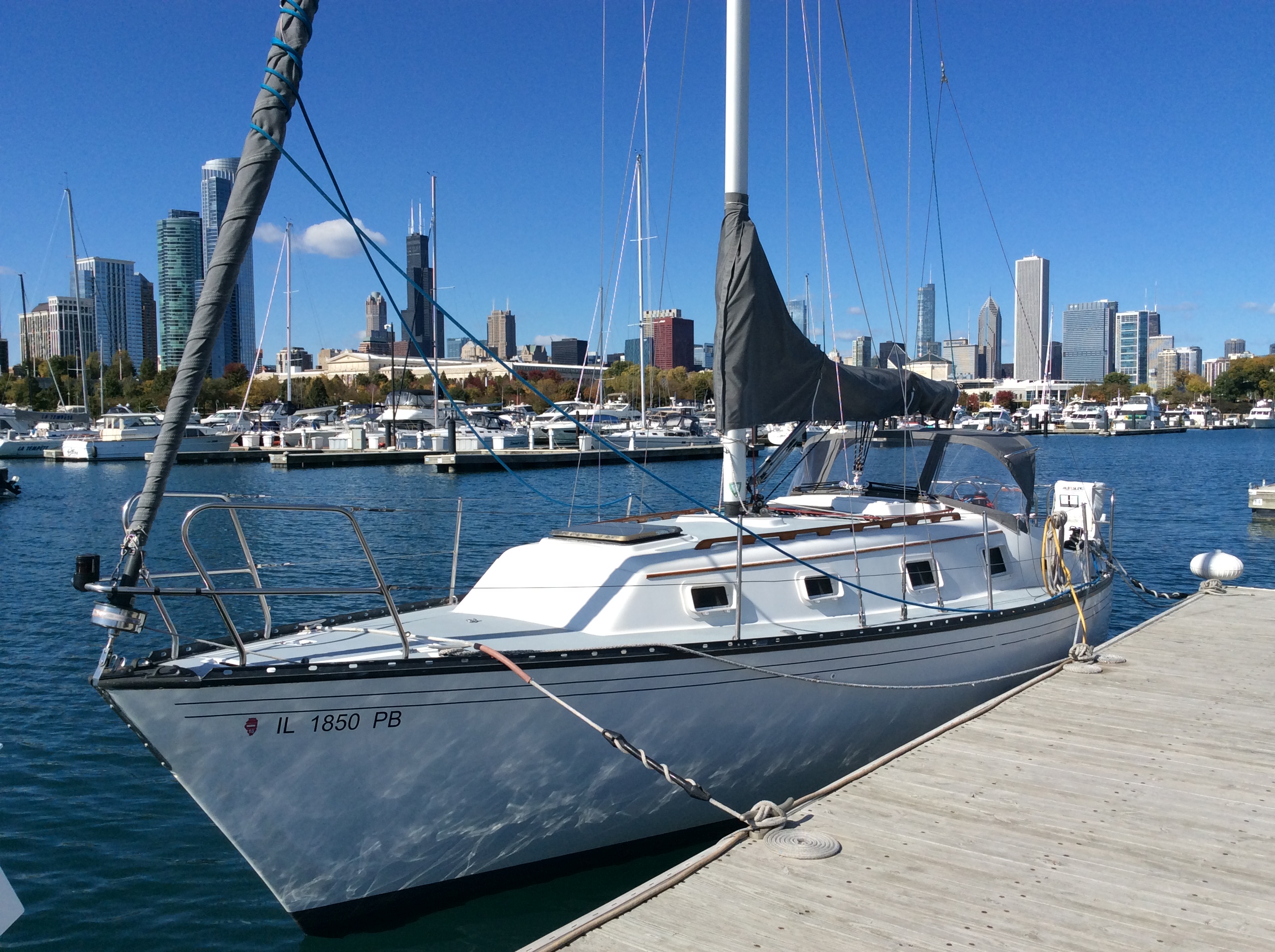

Kito,

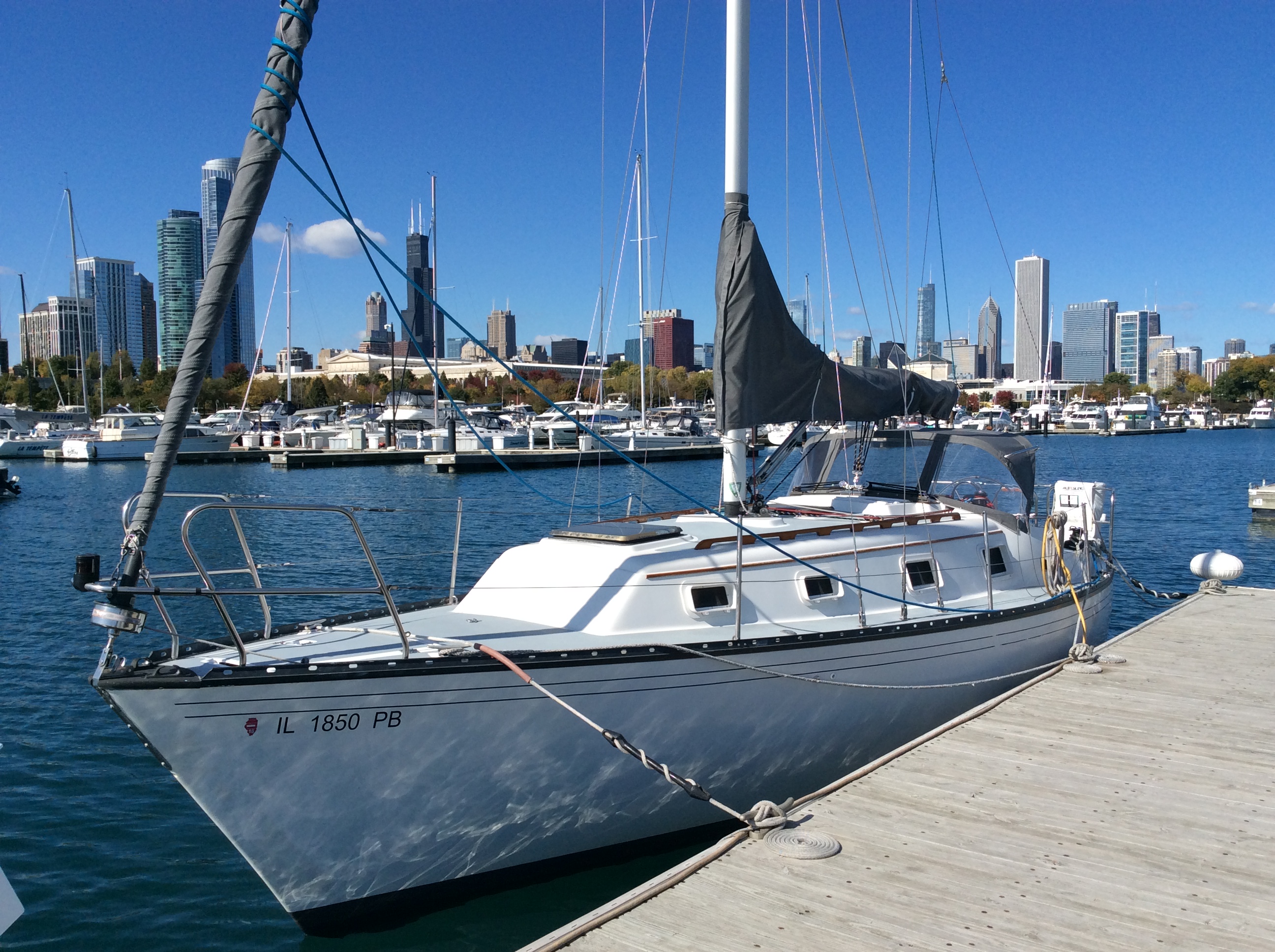

You can zoom in on the attached image to see how mine is set up. The cross brace you refer to was removed by the P.O. long ago. I've ordered a new genoa which will have the tack raised about 6 inches from where you see it here to improve visibility and allow the foot of the new sail to clear the rail.

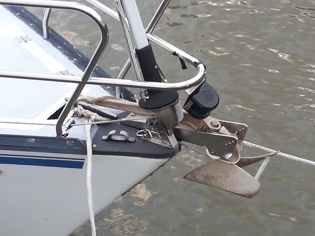

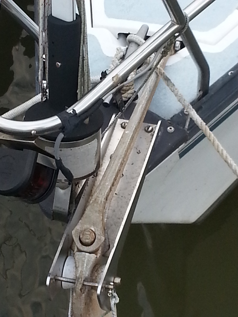

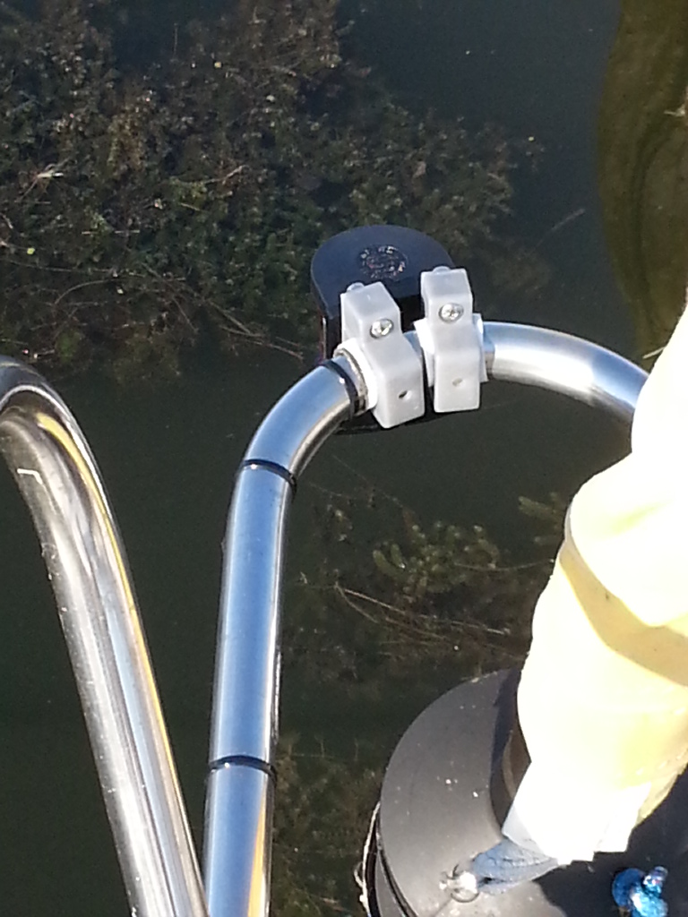

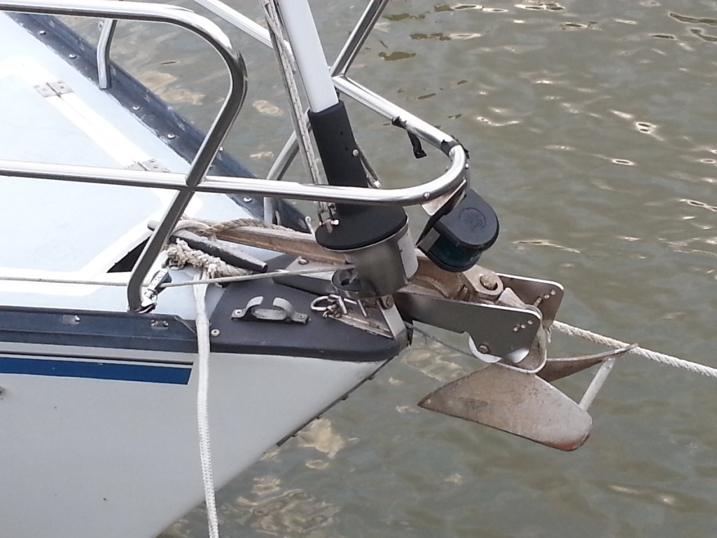

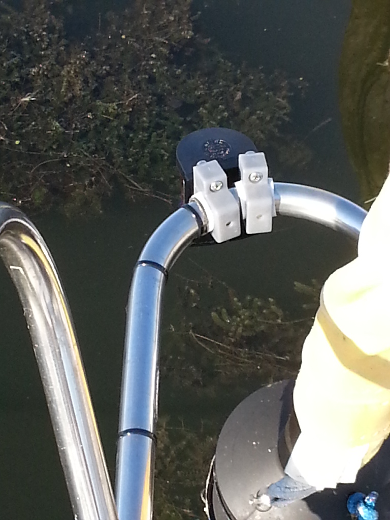

Here are photos of 2 H27's with furlers . First two are not mine, third one is. I used conduit clamps to hold the light on, I wasn't able to find the AquaSignal bracket anywhere on the internet (it shows up, but when I tried to order it they were all out of stock and couldn't get it). You can see how the light in the first two photos is knocked down from being bumped. If you can weld SS, you could probably re-use the plate/bracket off the cross-brace and weld it to the front of the rail and have a stiff mounting point. We used a sawzall to chop it off and I ground/filed off the rough edges.
In hindsight, I probably would have gone with a furler setup that gets the sail up over the rail, which would have avoided removing the cross-brace and having to re-mount the light. I have even considered taking the sail in and having it shortened, partly to keep it from hanging up on the rail and partly so I can see under it better, although at this point I need to spend my boat bucks on other things.

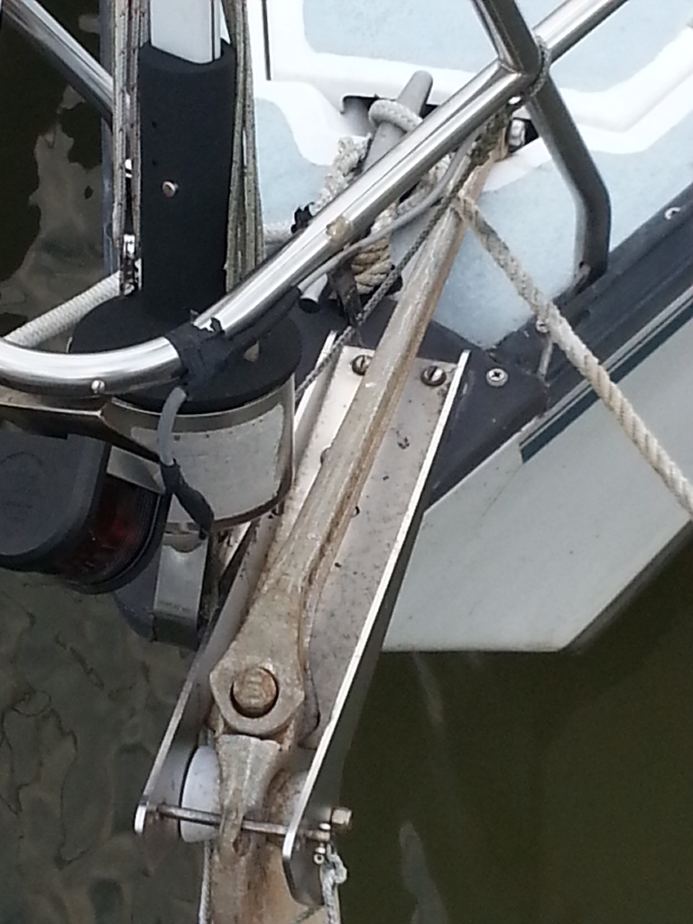

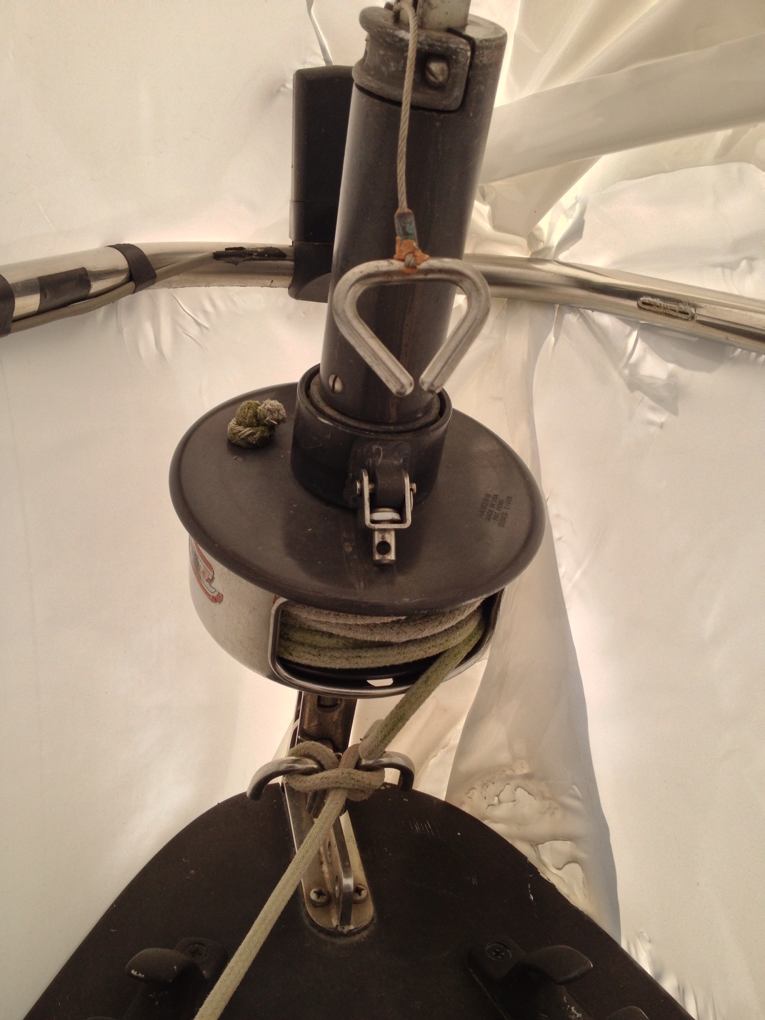

Here is a photo I took today on the foredeck under the shrink-wrap. You can see the cross brace weld mark on the starboard side and the tape covering the one on the port side - which was actually a fairly large opening in the side of the rail tube that I want keep water out of. It's amazing how long a piece of electrical tape will last outdoors. I had completely forgotten about that quick fix from 5 or 6 years ago - another item for the to do list. Anyway, the cross brace appears to have been just very slightly forward of the torque tube above the drum. Mine is a Harken furler, I know nothing about your Profurl furler, and we know that Hunter changed things from year to year. Different furler designs and and/or an inch or two variance in the position of the cross brace could mean a different situation for you. I think it's wise that you wait and see if cutting out the cross brace is actually necessary.
The nav light is the AquaSignal Series 25 Classic with rail bracket #25900-5. The bracket is upside down, but not the light. AquaSignal has discontinued that bracket, but you might find one on eBay.
