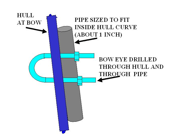

Method I used
Once I got to the inside of the bow, I tried different diameter pipes until I found one the matched the curve of the bow inside the boat. This pipe was then used as my backing plate to spread the load of the eye. So far it has worked like a charm. See attached drawing for detail. Ward

Ward scores again!!
That's a very simple yet highly effective solution. Well done. Peter H23 "Raven"

Excellent!
I would hate to see the boat that had the bow eye pulled out with Wards fix. I bet you could lift the boat in the air using the bow eye that way. Mine is not loose at all but I am going to put that on my list of projects.

WOW!
Ward: That's brilliant! I am returning to sailing only recently, in a non-trailierable boat, but that is a fix I can even use on my little fishing boat. "Clap, clap, and a double thumbs up!" Duane

Ward you are a "LEGEND"
What a great repair. Well done and thanks for the clear graphics. Excellent!

Clarification
In fairness to Hunter, I want to clarify my bow eye modifications. I have added the pipe backing to two Hunters that I have. The 1993 h27 never came with a bow eye so I added it. The 1988 h23 had a bow eye with only washers behind it for backing. This appeared to be a replacement not original equipment. I am not sure all trailerable hunters come with a bow eye from the factory. People may order it without because they don't want to trailer. As for all the accolades and nice comments, Thanks You. Keep in mind, I am only submitting the ideas that worked. You have no ideas all the DUMB ideas I have. I sort of fit the old farmer saying we have here in Iowa. Even a "blind" pig finds an acorn once in a while. <smile>. Ward
