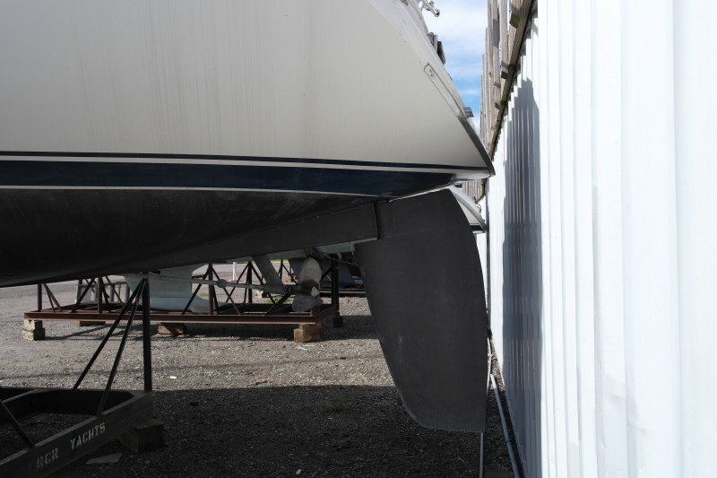

Look at the waterline, not the rudder. The top of the rudder may be at or slightly above the waterline. When sailing or motoring, the stern wave will submerge the rudder. The photo is a 1993 Sabre 362. The top of the rudder is at the waterline.
