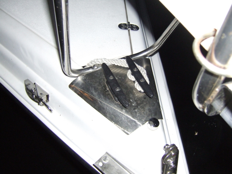

The approach recommended by John on his 26 wouldn't be feasible on a 23 as there is essentially no room forward of the anchor locker opening. Paladin's is the best I have seen.
My boat came from the previous owner with a pair of black nylon, maybe 6" or 8", cleats mounted to the deck edge (where the toe rail would be) just aft of the bow pulpit stanchions. More or less where the blue dock lines in Paladin's photo cross the gunwale. There is no obvious way to get under these for backing plates, so I assume they are just screwed into the glass. I only use them for temporary tie-ups. In our (new to us) slip, I attach the bow lines to the bow eye using a robust stainless carabiner. I spliced thimbles into 1/2 inch 3-strand nylon and the carabiner attaches these to the eye. In my case, it is easy to reach the bow from the floating dock to snap in the carabiner.

the interior of the bow is accessible (Hunter 23 wing keel) by unscrewing and pulling the forward triangular shape cover forward in the V berth. You should be able to purchase those fold down cleats and permanently attach them underneath and would suggest a metal plate to distribute the load for underneath.

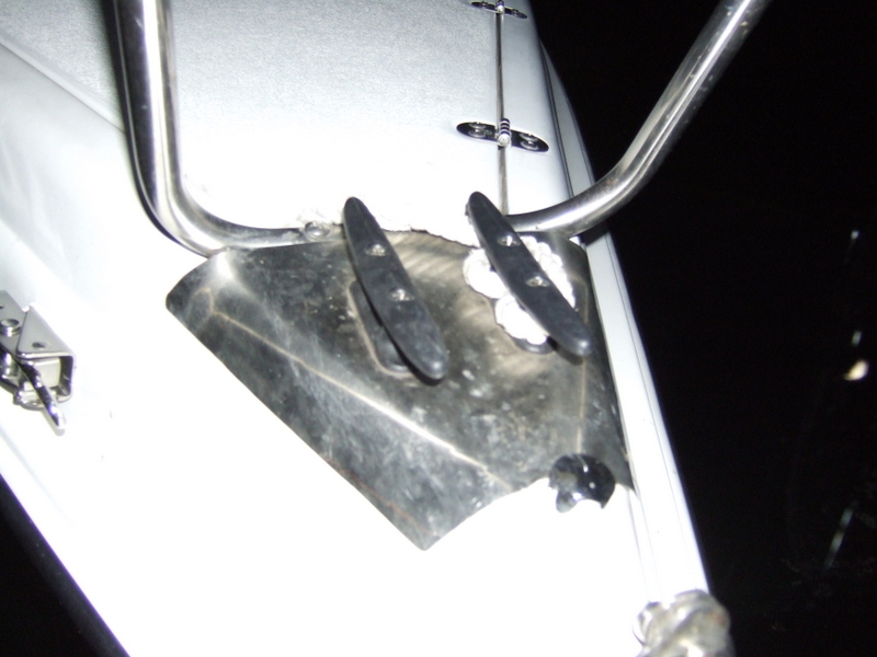

Folding cleat pictures
I just posted pictures of mine in my profile, Thanks again Paladin27 for the tip. No more sheets hanging up as with my standing cleat

Your welcome! It was one of the best modifications I've made to my H23! Makes docking a breeze and keeps us from having stubbed toes!
