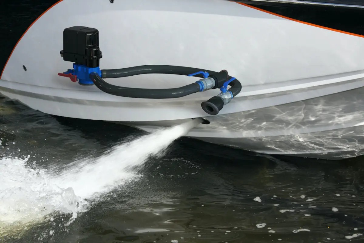

There is always the bow thruster. There's a product called a jet thruster that is basically two thru-hulls that jet out water on one side of the bow, in-take on the opposite side.
