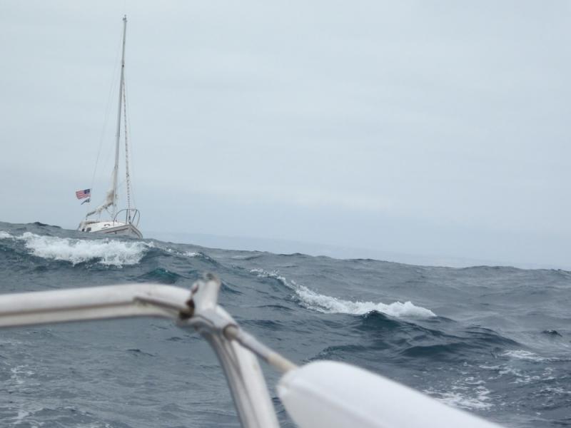

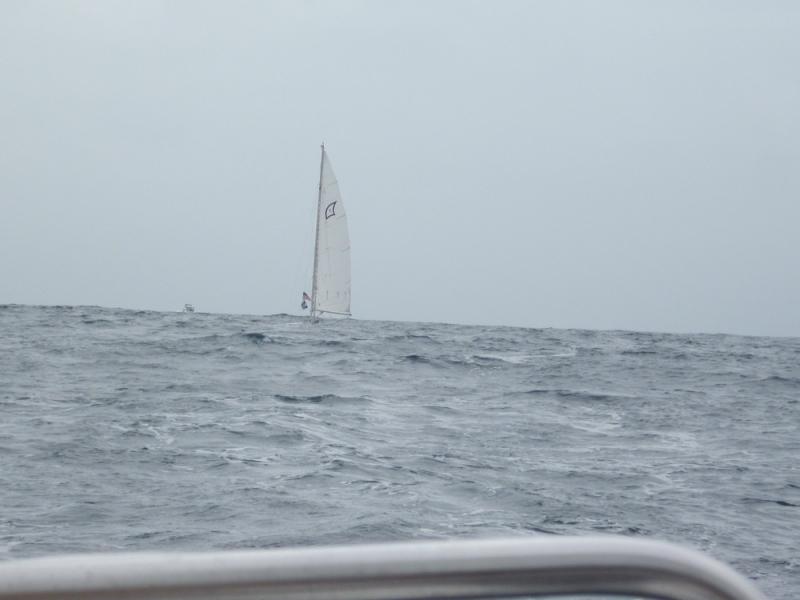

In the early C-22 days, some C-22's did have floatation, I think it was a factory option. Most posts over the years dealing with old boats with the floatation dealt with how do I get rid of this mess. We've been in some pretty rough conditions with our C-22 out in the Pacific. We've made some extended passages down into Mexico, up and down the coast, and crossing several times to Catalina Island. We pay attention to the weather, but we've still taken water over the cabin top several times. Exciting? Yes, but the thought of the boat sinking was never a concern. These boats will take a lot more than most us can. One thing I have done is to eliminate any through-hull penetrations below the waterline. I only had the galley sink to deal with on our MK-II version. I removed the ball valve, and patched the hole with good old WEST epoxy.
