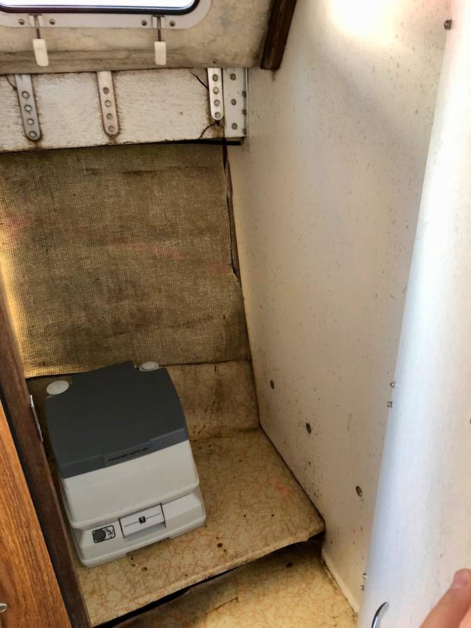

Recently bought a Bayliner 26 foot sailboat. Noticed that the sidestay mount on the inside is connected to wood that has a lot of dry rot and needs to be replaced. Is this easy to do for someone who is decent at wood work? Here is a picture. Is it just that small piece or does it go through the wall? First post so thanks for reading.

Can't tell from the photo, but would have to guess there is more to it then just that small pc. Sorry I don't know much about that particular boat. I am sure someone on this form does.

Ok so side stays are attached to bad wood means the entire mast could come down. Hopefully someone with that boat knowledge will come forward, but I would replace the entire wood, probably have to drop the mast while doing it.

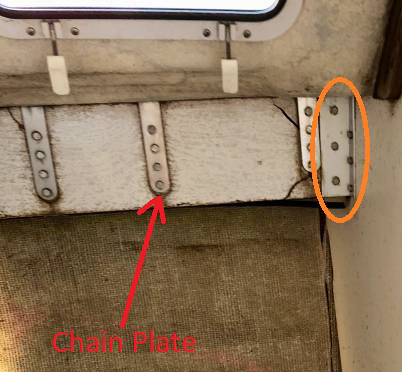

It is hard to tell from the pictures but it looks like all three chainplates are attached to a single board and that board is attached to bulkheads by the bracket I circled in orange in your photo (see photo below). More pictures would be helpful but if I am interpreting the design correctly, you should be able to replace that rotten board rather easily by removing it from the existing brackets. Use the existing board as a template and cut out a new board. I would use white oak if possible. Make sure it is not red oak. Red oak rots too easily. Alternatively, you might want to use Starboard or some other plastic wood like Trex to replace the board. That way you would never have to worry about rot again.
The shrouds (side stays attached to those chainplates) are holding up your mast. So you probably need to take the mast down first.

Starboard would be a poor choice, while it won't rot, it is not a structural product. The chainplates exert forces measured in thousands of pounds and starboard is not up to the task. White oak would work. High quality plywood without voids and knots might also be a choice.
Are the chainplates on the starboard side installed in a similar manner? This may have been a repair. The reason I mention this is look at the bolt pattern at the forward end of the board. There are 2 bolts that are adjacent to each other. Drilling holes that close can weaken the board and it appears that the crack originates near those holes.
If the mast isn't down, it should be taken down and all the chain plates on both sides removed cleaned and rebedded, paying close attention to the coring in the deck and how the boards are attached to the bulkheads.
The highest loads on the boat are where the keel or keel/centerboard attach to the hull. The next highest are at the chainplates. There should also be a compression post under the mast step. This will help support the mast. When a rig is properly tensioned, the tension tries to shove the mast through the bottom of the boat. That force should be transferred to the keel, through the compression posts and the bulkheads and chainplates.

I would replace that piece like @rgranger suggests with white oak encapsulated in epoxy. You should be able to tell if it goes through the bulkheads (walls) by looking at where it butts up against them. Drop the mast before you begin and rebed the chainplates. This is a necessary repair that will give you confidence in your boat and your abilities.

The cracks in the existing board don’t look like wood cracks to me...too symmetrical or something. A strong hard wood would be a good choice for this I would think.

On the picture the forward chainplate has been pulled up one notch... this is probably for the lower forward stay. that would make it an emergency repair: I wouldn't use the boat until it is repaired. I would lower the mast ASAP: on a 26 foot boat this isn't difficult and you don't need a crane or other mechanical aid; a couple of helping friends suffice!
I think @Caboteur is correct. I did not see that at first but it looks like the forward chainplate is no longer anchored at all. Fix this ASAP before the next big wind storm comes.
