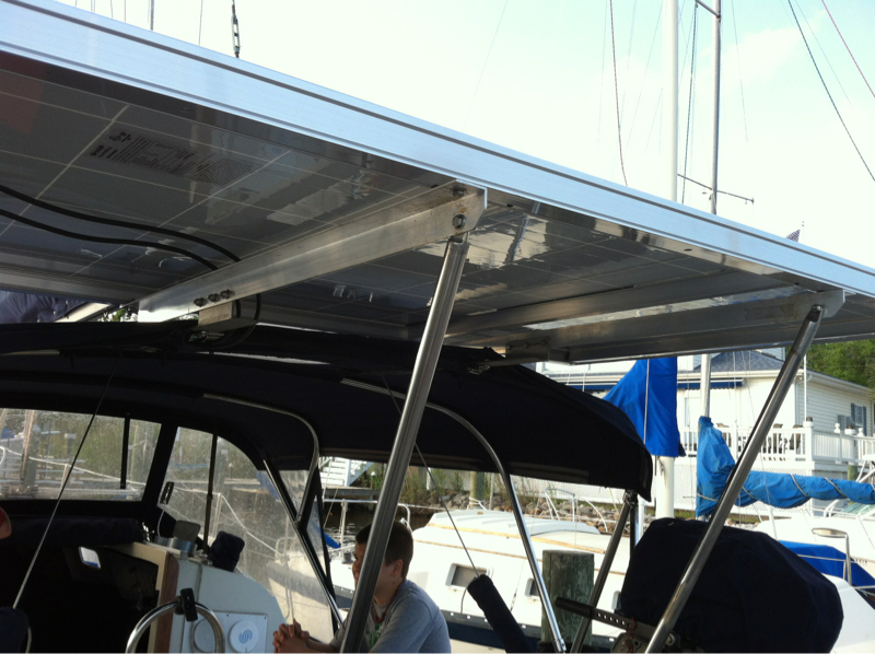

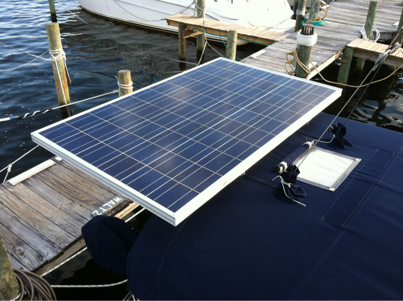

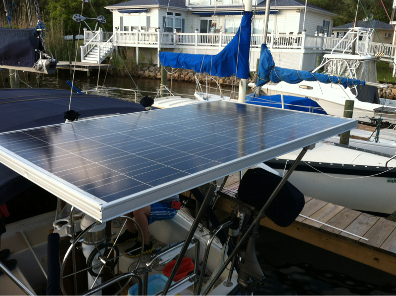

tcwaltz,
like to add a solar panel for batteries and electrical equip. fans etc.
suggestions about this for the oday28?

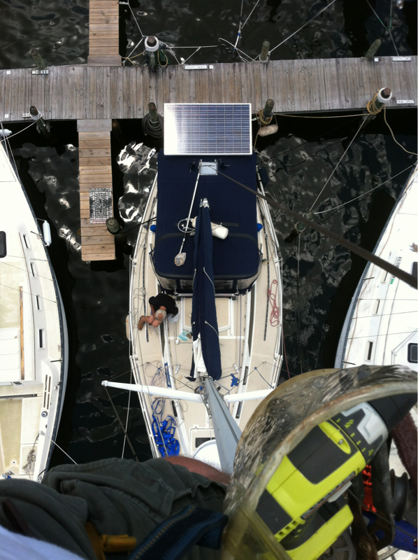

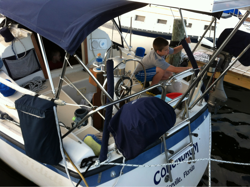

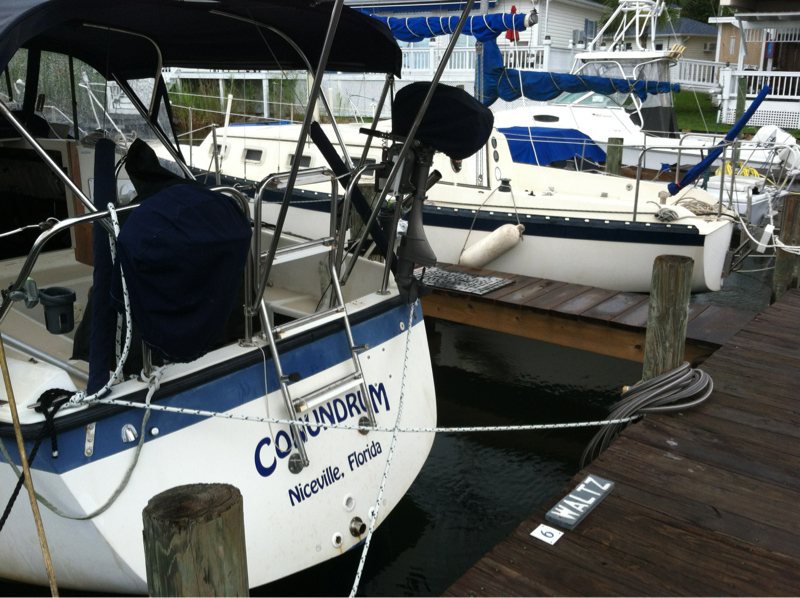

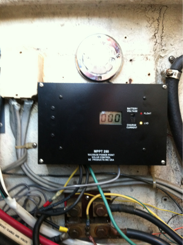

I have a single 230w 24v panel going into 4 Trojan 6v batteries. I have a pathfinder and shunt in my system so excess power charges my engine start battery. My lighting is all led now. The major power consumption is my refrigeration. I have not used shore power to charge in months. The other thing I notice is my batteries seem better because it charges during the day and get some use at night. Ive not had to put any water in my batteries in 3 months (I do have water miser caps also. I'm attaching photos of my install, charge controller and what it looks like 40' up the mast. Best thing is it adds more shade to the cockpit. All the mounting hardware is custom built
