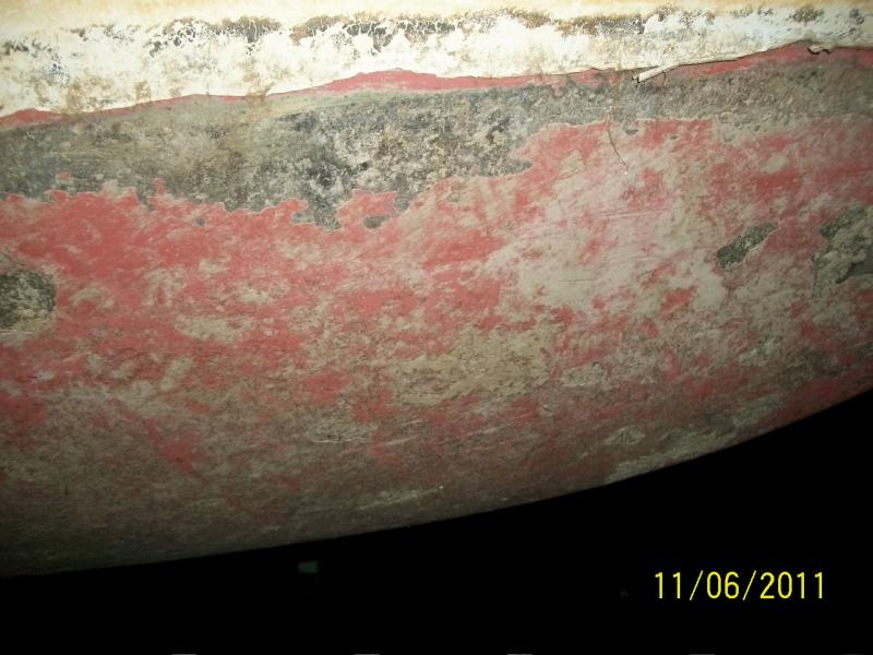

Two part question, part two is paint selection, I've been thry the archives did the search and what I found was inconclusive (at least to me...) Lot of "I like this kind, I like that kind" and "this is resistant to barnacles" this let the algae grow", but what I want to know is of the different typs of finish's which is most appropriate for Fresh Water lakes, and a boat that will be stored on trailer...? I imagine a "hard" finish, not neccessarily a copper coating, anything else I should consider...?
First part of the question is on prep.. looking at the pics of my bottom it looks neglected...I'm assuming I need to sand all the reddish orange "paint" off and down to the glass hull, (greenish part under water line..?) Do I need to "prime" with anything or go direct to hull finish...? Or just feather out the lumps and bumps and re-cover it all..? Thing is I don't know what I have so it's hard to tell what will cover it...

You may want - correct that - need to strip the old paint down to gel coat.

I don't know that I have a "smooth" gel coat on the bottom any more, so I'm pretty sure I need to do some sort of sanding to bare glass... Does the VC17 go directly on the sanded glass..?

Those round areas look like blisters to me. Need to get the bottom paint off down to the gelcote and investigate them. Painting over blisters will be a useless effort - they won't hold paint and will only get worse.
