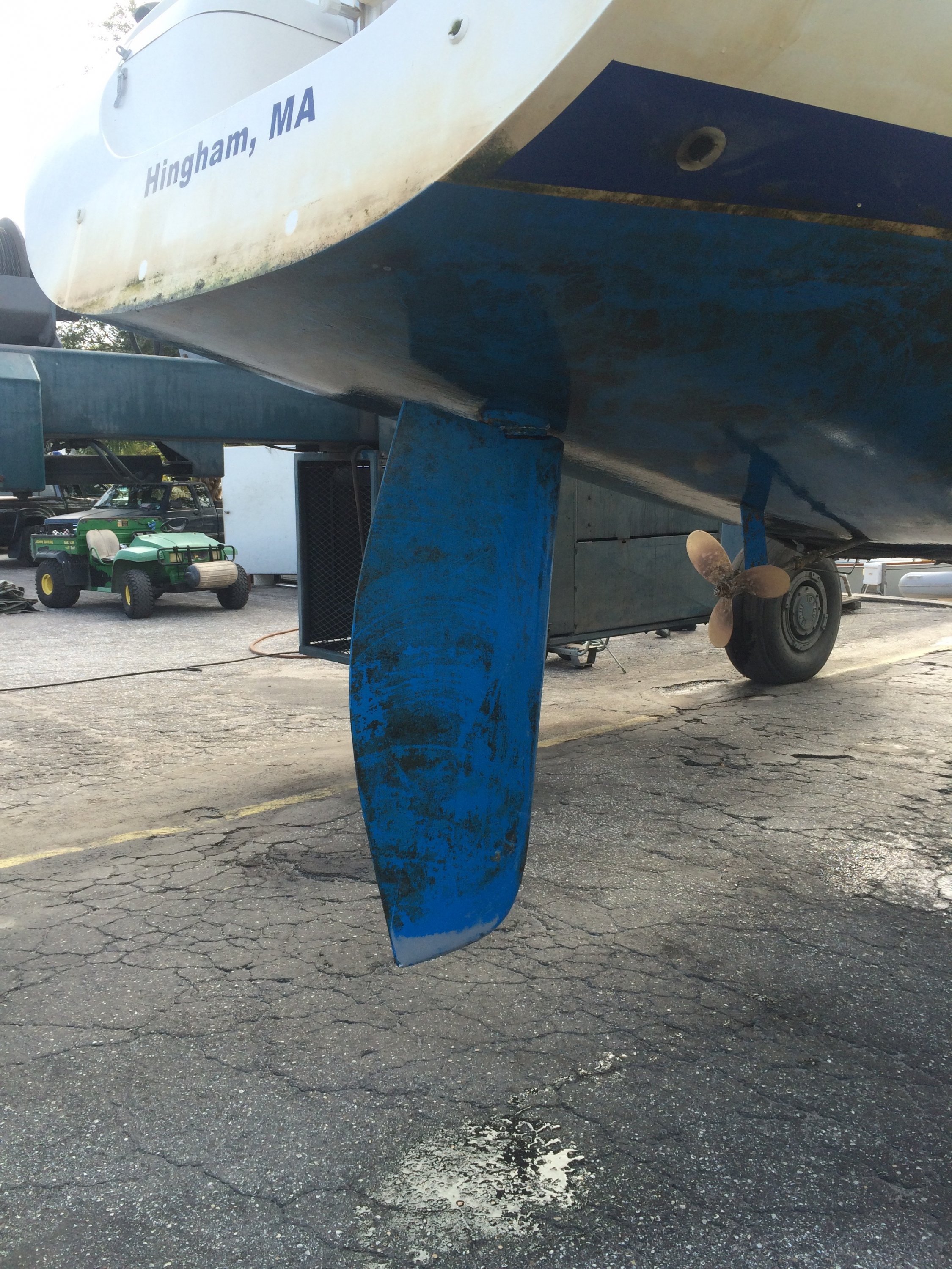

We just did a DIY bottom job in Indiantown, Florida. It cost us $just under $600 for haul, pressure wash, blocking, 6 days in the work yard and relaunch. We shopped this around and had the restriction of needing to live on the boat while doing the work so that might lead to a slightly higher cost than you are being quoted for some of those services. That also did include a day of rental for their vacuum sander.
As far as paint, 2 gallons of Interlux Micron CSC will give you 3 coats over the entire boat and 3 more at the waterline. We apply thin coats with foam rollers and probably could have gotten another entire coat with what we left to do the stand locations and the keel bottom. Double check that price with the yard. Interlux Ultra is only $190 a gallon from Defender. So that is over $100 more per gallon for the paint from your yard.
We also raised the waterline 3 inches. As a general process we believe in using two coats of barrier coat as a primer for the bottom paint. We "hot coat" the first layer of bottom paint to the barrier coat.

BTW Great looking bottom Jesse, Does not look worse for wear from coming down the ICW.
