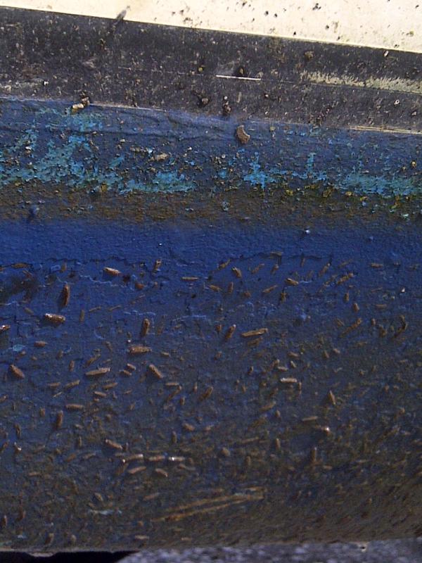

I tried this stuff called Aquaguard. It's water based and worked great for me in fresh water with Zebra mussels and blue green algae. This is what was on the hull at haul out time in the fall. I didn't clean it all summer. It rubbed right off with a soft brush. I used a power washer and was done in 15 min!
I was impressed!
