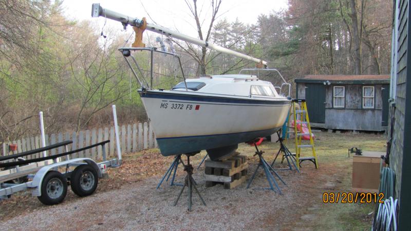

I've been painting my hull with Super Shipbottom Ablative paint. It's manufactured in Fort myers FL. by a guy named Ed Donlin.
This paint has it's own primer built right into it and it contains 62.5% copper. It can be painted over bare fiberglass and most bottom paints. You only need one coat.
http://www.supershipbottom.com/PAINT SPECS.htm
I just painted my centerboard and keel yesterday and today I'm going to paint the rest of the bottom.

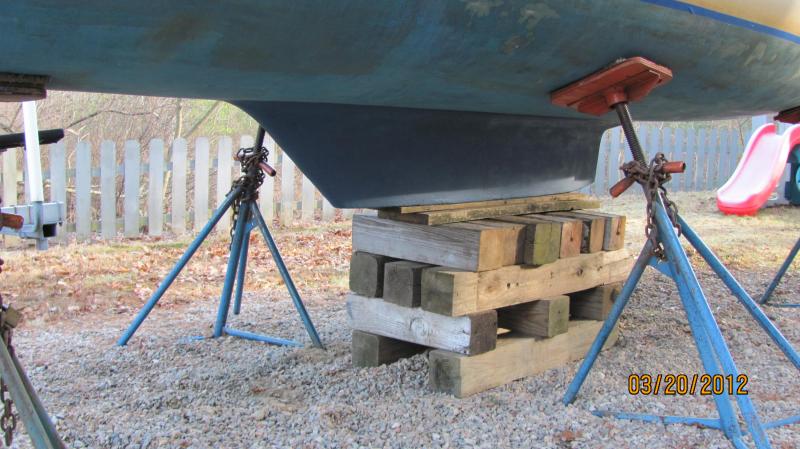

If you're into DIY you need the right equipment like the canister type respirator, paint roller on the end of the stick plus some cheap throw away brushes. Probably the hardest job is gaining access to the hull and keel to paint it. Yesterday, I had blocks under the bow and stern supporting the boat with the keel about 25" off the ground. I dug a 15" hole under the keel to let my my centerboard all the way down.
The stuff dries fast and toward the middle of the afternoon I was able to fill in the hole and shore up under the keel to remove the bow and stern shoring blocks. There's a little work involved and some danger that goes with it when your dealing with the weight of a boat, but I plan it all out and the work usually goes pretty well for me.
I should have her back on the trailer by the end of the week if all goes as planned. I want to get the mast up next week and check my new mast extrusion to make sure my stays will come right. I added an extra 1/8" to the bottom of my mast a couple of weeks ago. It shouldn't make too much of a difference to my turnbuckle adjustments,--I hope.
