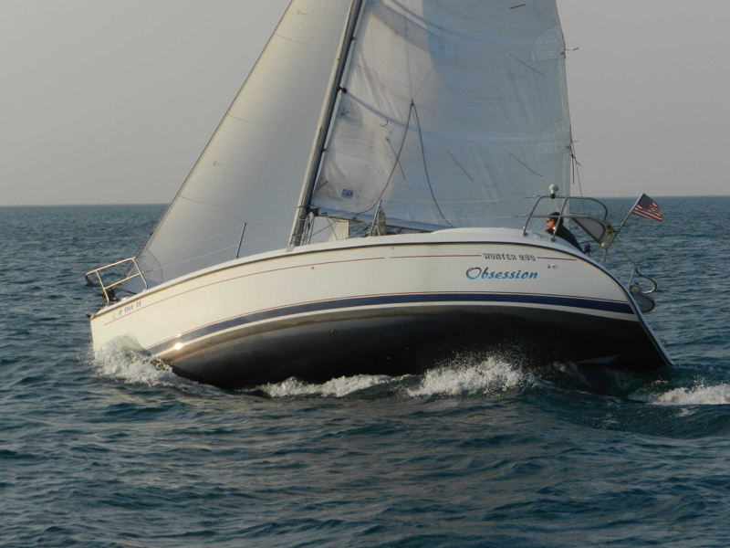

I also sail on the Great Lakes (Lake Michigan), and I apply VC-17 every other year. It helps keep the algae growth down and your hull cleaner though out the season. Obviously, you should power wash the hull at haul out every year. I keep a little VC-17 around for touching up any areas on the "off year".
Greg
Jan 7, 2011
6,018
Oday 322 East Chicago, IN
Greg
See how clean!
