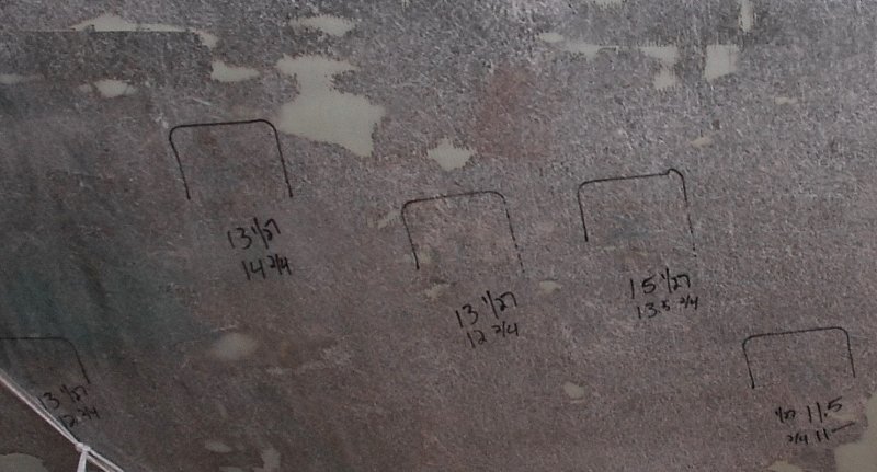

For the amount of time you will be hauled out of the water a barrier coat job is basically going to be a waste of money. The hull needs to be DRY before applying a barrier coat or you simply seal the moisture into the substrate. For boats that are in water year round this can take a long while out of the water to achieve dry. If you don't have a blister problem I would just haul, pressure wash, sand if necessary and re-paint.
In the NE to achieve dry out many yards will strip in October, measure moisture content then let dry all winter.
High moisture readings are recorded by tracing the outline of the meter then writing the date and moisture reading in the box. It is re-checked monthly and new readings written in the box.
As you can see drying happens quite slowly. Those readings should be roughly 4 or less before applying the barrier coat:
There are a LOT of unscrupulous yards that will take your money and do an improper barrier coat job.
P.S. No need to "tip" an ablative as they are self polishing. Use a light nap roller like a 1/4" or even foam if you want really smooth..
