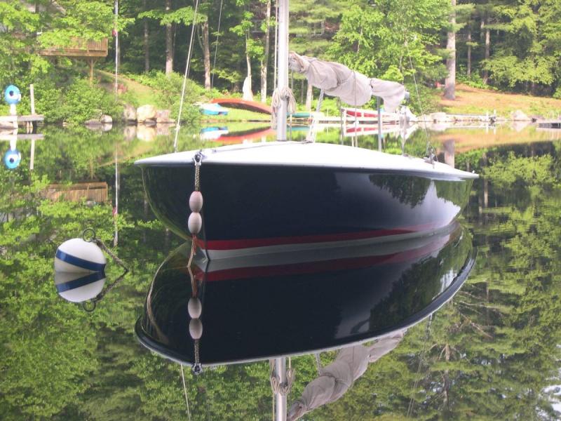

We have a 19' flying scott on Thomas Pond, which feeds into Sebago Lake. I refurbished the boat a few years ago grinding off the bottom gel coat and applying epoxy barrier. I finished with VC Performance Epoxy, which is Teflon filled and very hard and slippery. I chose this over any antifouling paint because I don't want to affect Portland's water supply and the lake is so clean I figured antifouling is not needed. This is true. I get a very light slipper layer on the bottom that you can feel with your hand the end of the season but it is cleaned up with a Scotch Brite pad. I highly recommend it.
I ended up using Pettit Hydrocoat ECO, it made good sense
Nice when it is freshly painted, huh? Do you pull it yearly? Mine stays nice with just a light pressure wash at the end of the season and a light overcoat before the next launch.
