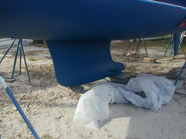

One Color
I know you want two colors to check for wear,but what color is on now and use a different color this time and color next time and less waste with two good coating of same color.
I just did mine with a 1/4 nape roller which went on better than a 3/16 roller that I used on first coat.
I used two gallons of Ultama SR 60 on my 36 Hunter.
