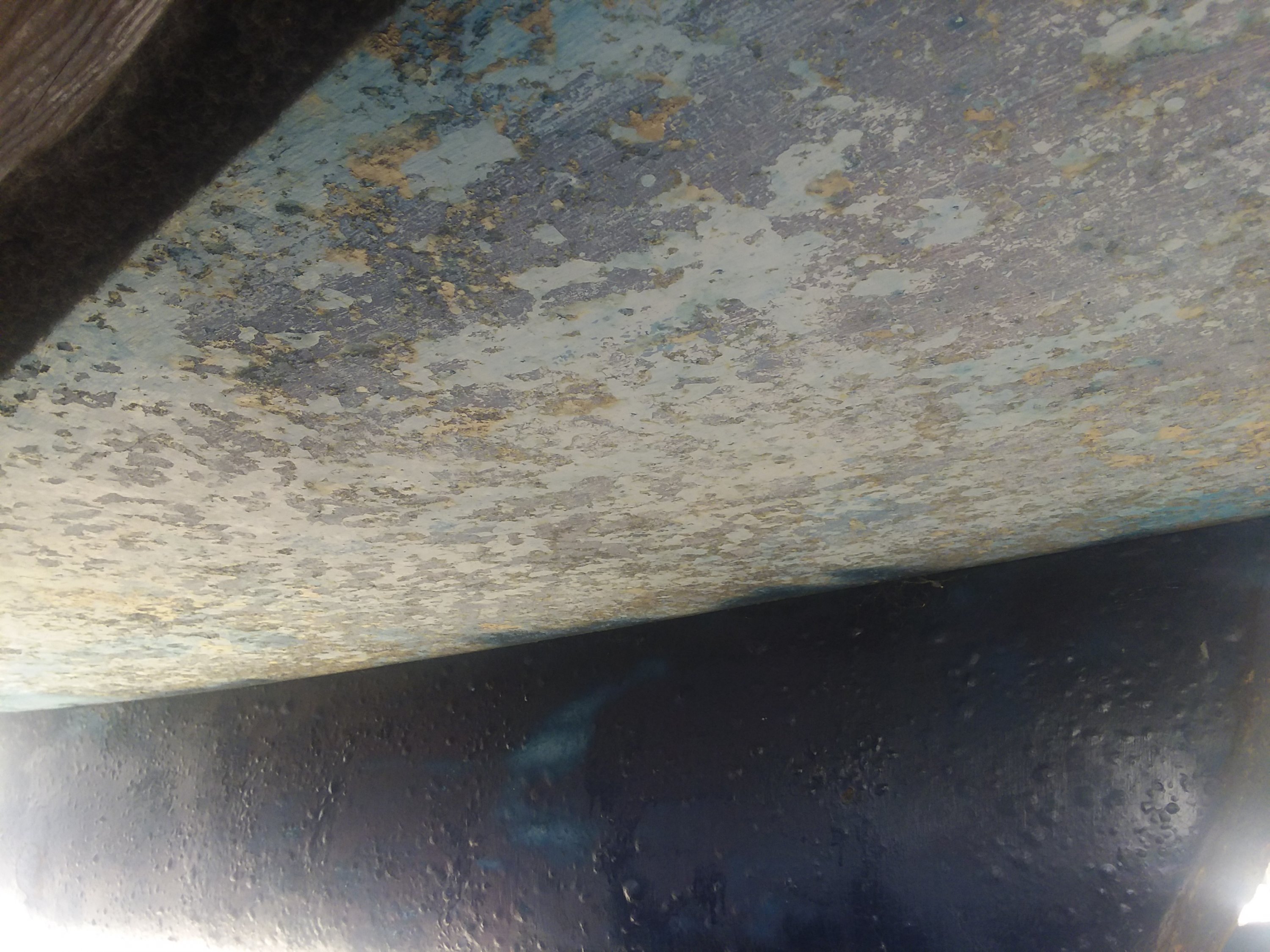

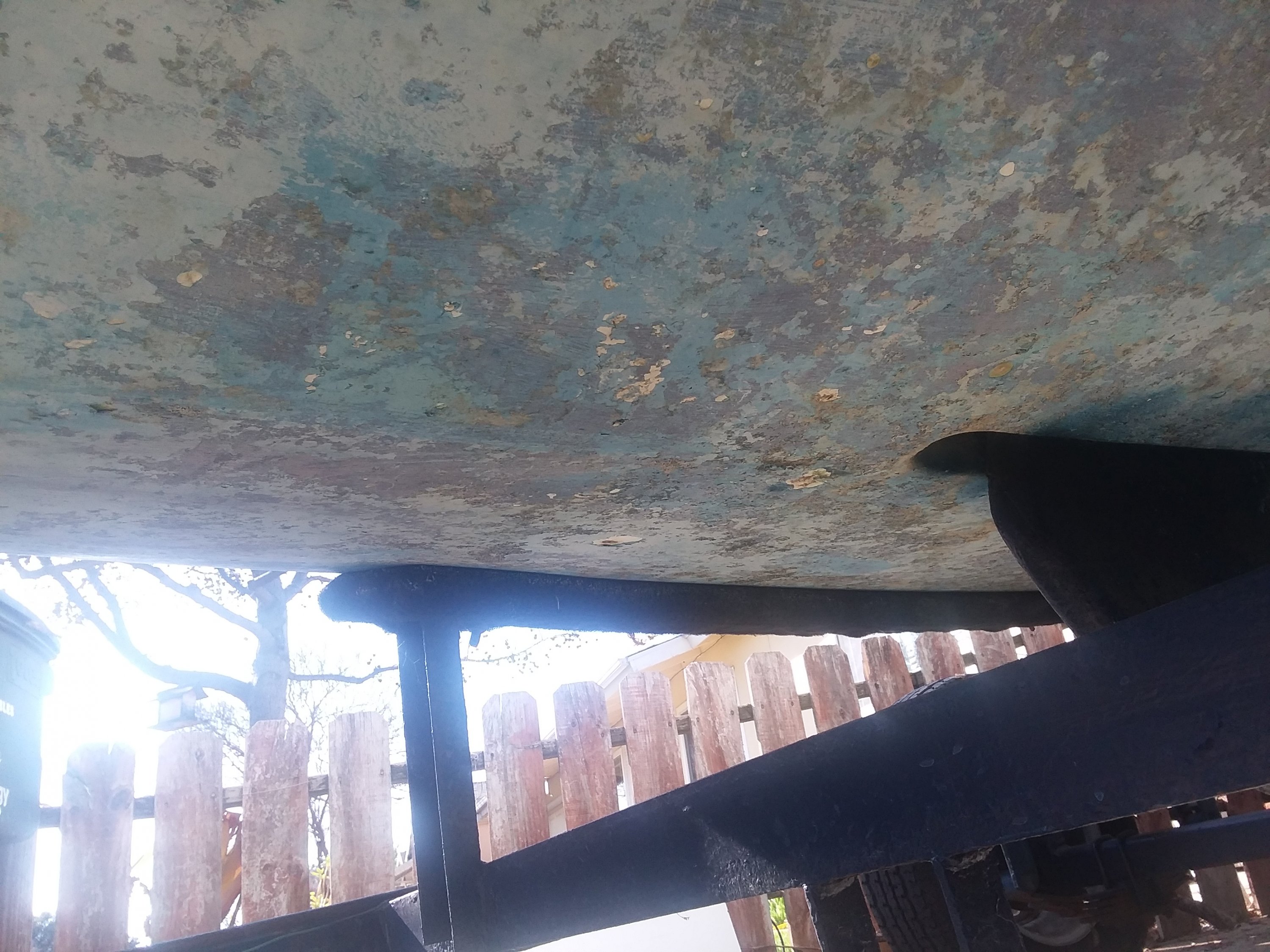

Hello,
I have been doing a lot of research and I think I know the answer here but need some reassurance.
I have a 1981 C-22 the PO said it spend "some" time in salt water and then 10 years in a barn before I pulled her away for a new life. I am planning to follow Stingy Sailor and strip her down to the gel coat and go the Interlux 2000 and VC-17. Is it a must to strip or soda blast to the gel coat rather then cutting corners and painting over a sanded bottom?

It is all about getting to a firm surface to apply the barrier coat. Check with the paint company. They are the experts about how to apply their paint over existing surfaces.

Generally, before applying a barrier coat all of the old paint must come off. How it comes off is a matter of choice. Some paints come off easily with sanding, some with paint removers, some with soda blasting. After the old paint is removed, the surface will probably need to be sanded with 80 grit.
There are environmentally safe paint strippers out there. Check Franmar they make a soy based product that is very safe.
As John said, check with Interlux. Their website has lots of good information. Sometimes it is better to look at the Pro side of the site, the information may be bit more detailed.

You should remove it all the bottom paint. The paint adhesion is basically mechanical and the barrier coat is chemical. So you would have stronger adhesion of the barrier coat to the paint than the adhesion of the paint to the hull. That's a formula for failure. So pop a few ibuprofens and go for it.

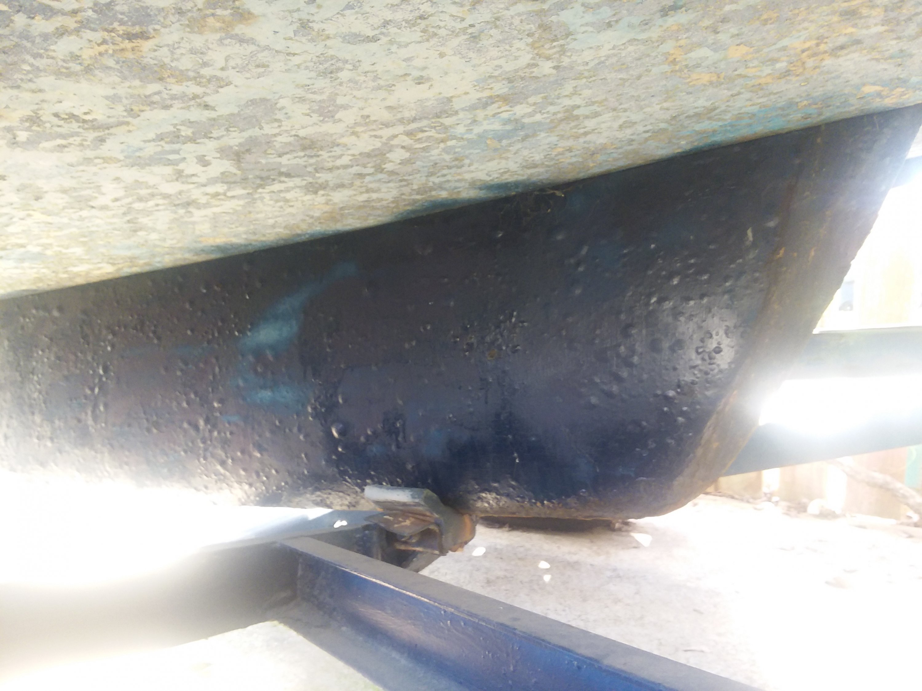

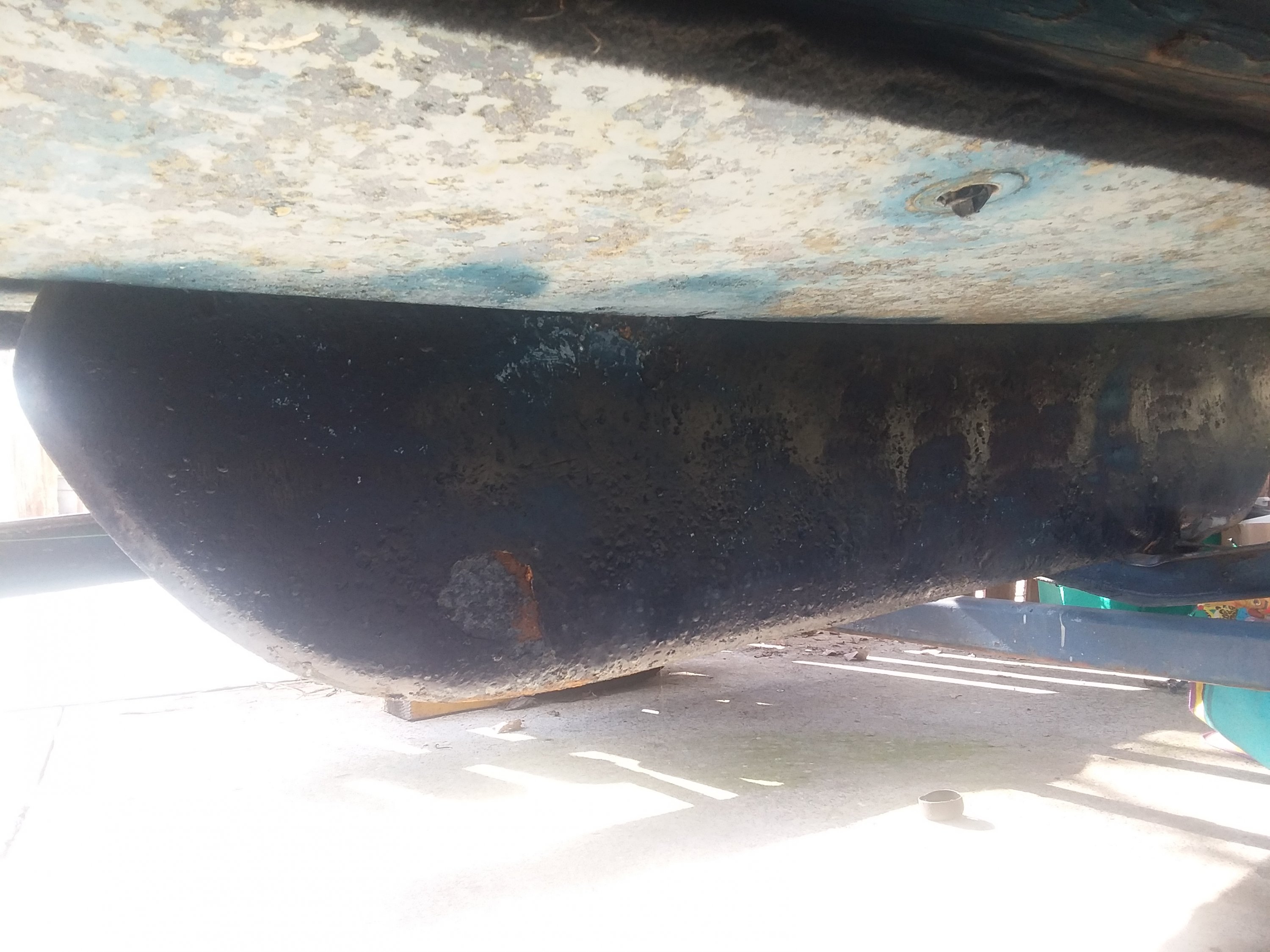

Ugh, that keel is a mess, it it iron or composite? Have the hull blasted. Then decide if you want to do the repair, fairing and coatings yourself.

WHAT are all of those bubbles on your keel? Was there ever a blister issue with the hull before?

If you are not going to leave the boat in the water, the barrier coat is of questionable value. The photos indicate there has been saltwater intrusion on what appears to be an iron keel. Sandblasting will take that down. Soda blasting won't.
I recommend using an orbital sander with 80 grit on the hull to take it to the gel coat or barrier coat, if previously applied, before painting. It appears to already be there in places. Use a good mask or respirator. Do not rush. If you burn through the gel coat you need to apply the epoxy barrier coat. If you believe the previously applied paint is in good condition you can get away with a deep scuffing of the paint layer before recoating, in case you were to apply two coats of bottom paint. If you are not leaving the boat in the water a hard anti-foulant is the best choice if you are going to use anti-foulant at all.

I been dragging my feet on getting the bottom painted. Thanks to the garbage man chipping a piece of the gel coat and insurance, I got a check for 700 and will be using that to get the bottom done. To answer some of the questions
1. She will be in Salt water for the sailing season and back home to sit covered in my driveway
2. I have no clue what was on it prior
2. The keel is cast and is rusted and pitted and the PO just rattle canned it before I picked her up last year
3. The keel cable and mount on the keel itself looks surprisingly good in my opinion
4. From what I have seen on boats with blistering mine seems to have an cracked eggshell look and I have not noticed any pits or blisters.
I contacted a Soda guy here in my town and am looking at around $1000 to just blast it. I can justify that so I will be using a random orbital sander to take it down and get rid of all the flaking.
You have 2 choices here. The first is to just clean it up, slap some bottom paint on it and go sailing. The other involves taking the CB down to bright metal, prime with an appropriate primer, fair it, and then prime again and bottom paint it. I'm sure the folks who own C22s and race them can give you more advice and guidance. To me the big project looks like a good one for the next off season. :) Spend more time sailing this year and do the big labor intensive projects in the off season.

Unless you want to spend a good bit of your sailing season doing ugly bottom work put a soft ablative paint that is well rated for adhesion to whatever and go sailing. Pettit Hydrocoat is one, there are others. At the end of the season, having done your homework, do the job right. Clean, rust stabilize and prime the iron keel and centerboard. Sand the hull down to the gel coat or existing epoxy primer (if any). Let the hull dry and apply a 10 mic epoxy barrier coat in the spring, followed by a hot coated bottom paint. Interlux has a wealth of info on their web site. This forum does also. Take the lazy slacker course and you will waste your time do it right the first time, but for now just put a soft paint on it that sands off easily and go sailing.
