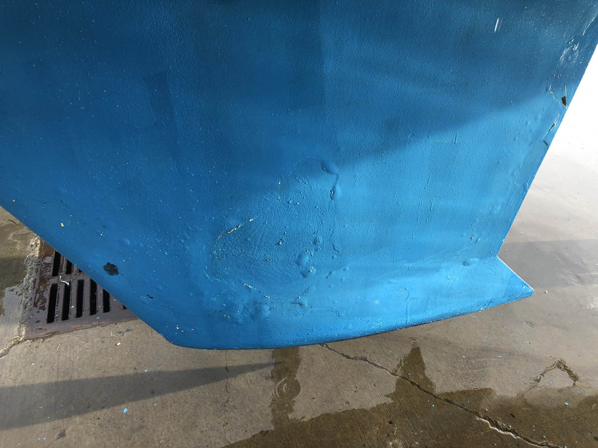

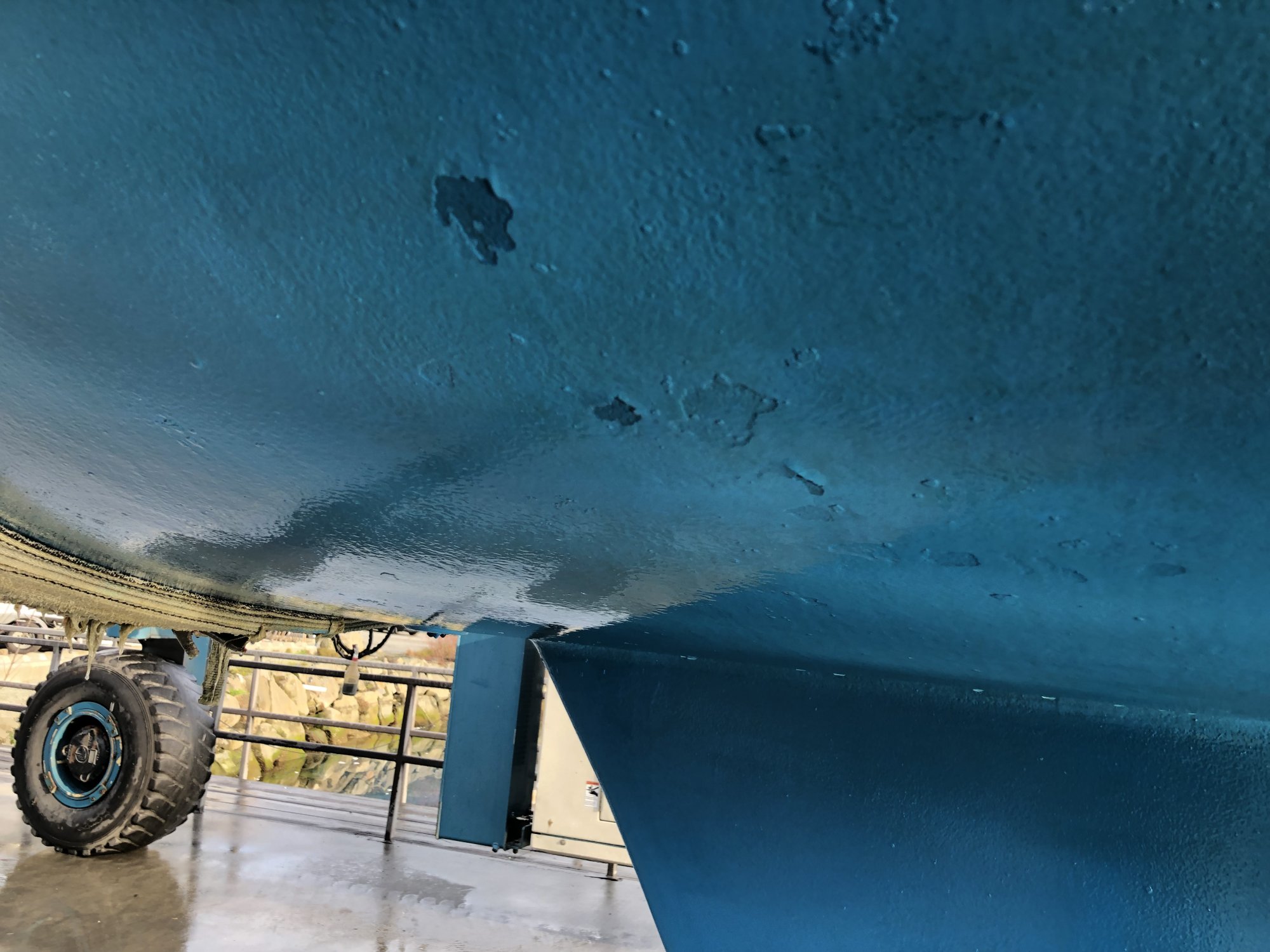

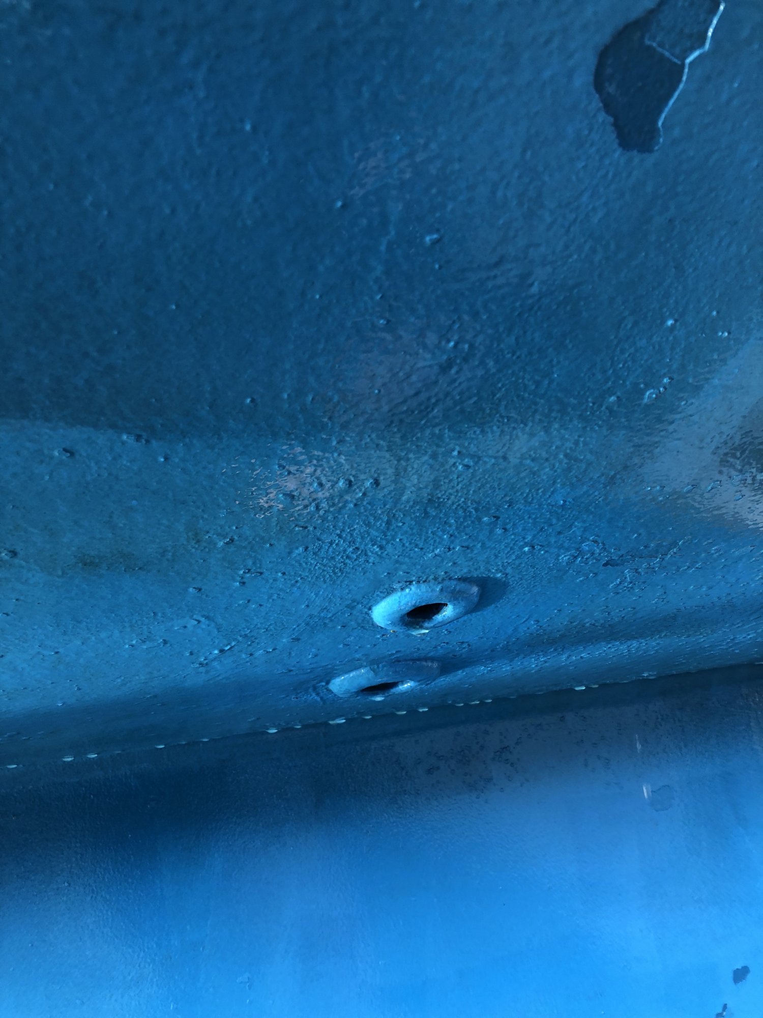

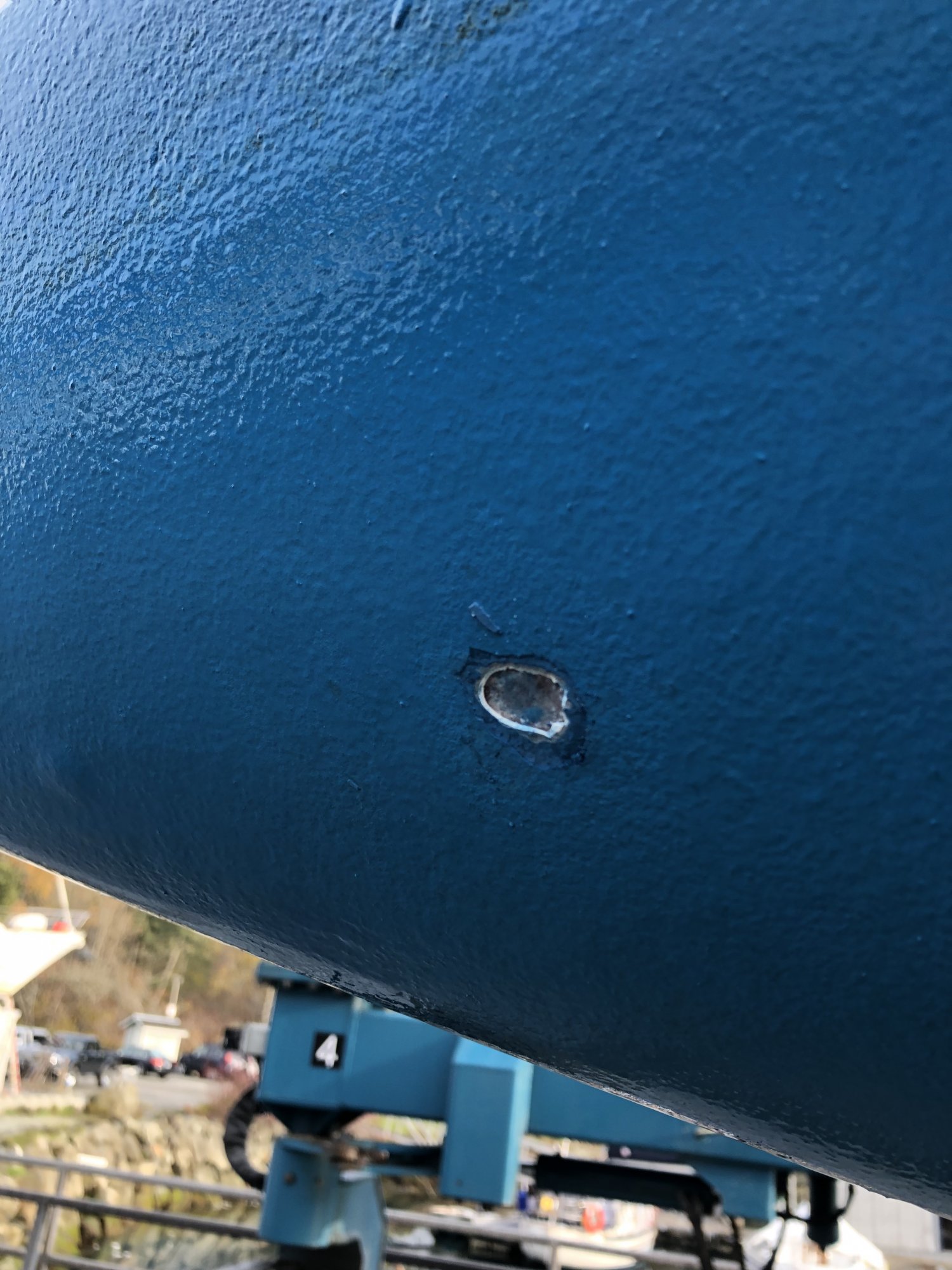

I have our 2000 Hunter 320 scheduled to come out next month. I've arranged for dustless blasting down to the gel to take off the last 20 years of whatever was put on it (owned it for 2 years) and make a few repairs (see pics).

You may discover that some of those spots are blisters which need to be addressed with some epoxy to seal the fiberglass. Then a little faring and sanding to smooth and even the bottom. Then the barrier coat... I would be inclined to give 2 coats of barrier coat since I have it out of the water and have gone to the expense of prepping the bottom. Then yes a couple of coats of antifoul and back in the water. You should be happy for a couple of years.

It does look as though you have at least one blister in the last image or a poorly done repair after the boat hit something. Once the paint is off you'll have a better idea.
The keel does not look like it is encapsulated, so when the paint comes off it will be bare metal. Not sure if Hunter used lead or cast iron. The lack rust suggests it is lead. You'll know when the paint is off. Keel castings are pretty ugly when they come out of the mold, expect to see a lot of fairing compound on the keel. The bubbles on the keel may be caused by a poor fairing job or poor preparation for the barrier coat. If the keel is bare metal, it will need to be barrier coated as the antifouling paint won't adhere well.
