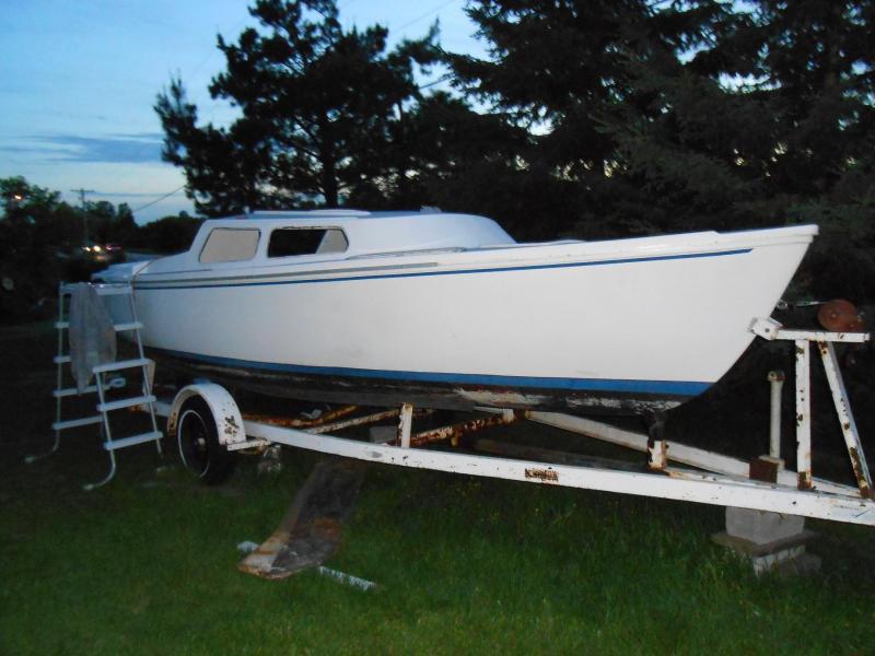

Ok all you C-22 Gurus I have a question, may be a stupid question, but I never painted a boat before so here goes. I am going to paint the bottomsides and then eventually the above the water line topsides. Do I roll the bottom coat(using awlgrip 545) up over the boot stripe or do I tape it off at the bottom edge of the stripe and just come up to it? And if I do roll up over it won't I lose where it is? I won't have any reference. Ideally what I would like to do is epoxy all at once the bottom and topsides all the way up to the rubrail, the bootline will be gone. Of course then going over the topsides with awlgrip white. If you get the boot line wrong it can really look awful, crooked or like your boat isn't sitting right in the water. Probably a simple solution, not sure why I am grinding on this. Any ideas?

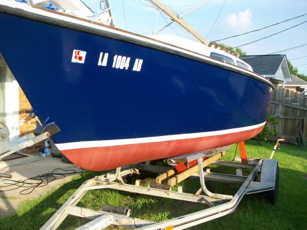

By the way KPGRACI is that awlgrip on your topsides there. I like the blue, looks sharp!
Jun 12, 2010
936
Oday 22 Orleans Marina, NOLA
The PO went to Lowes and bought some marine paint they sold there, I was able to find it two years ago at Lowes, but now I can't. It's a darker blue than the sapphire blue commonly sold as topside paint.
I do like the classic look of the blue over red, but I don't think it makes me very visible on the water. at least judging by the number of people that try to run me over.

Thin boot line.
