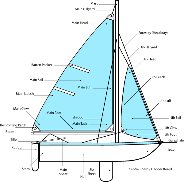

It sounds like your halyards (used to raise sails) are run back to allow the crew to raise the sails from the cockpit. This is a good thing as long as you keep track of what goes where. There should be one halyard coming down the back of the mast for the mainsail and one coming down the front of the mast for the foresail (jib or genoa). If you have a furler installed the halyard is probably in use hold the jib up in the furler track.
There may be another halyard foreward (of the mast) for using a spinnaker, if you have one leave this sail in the bag until you become proficient sailing with jib and main.
Sheets are use to control the sails once they have been hoisted by use of the halyards. There will be two on the back corner (clew) of the jib and these are run down each side of the boat. There is one mainsheet which connects the boom to the cockpit (many boats and I think yours) and this will have a multi- pulley "block" at each end which allows for mechanical advantage over the the force exerted by the of the sail.
Below is a simple picture of the parts of a small boat. This should help with nomenclature of the various parts of a sailboat.
Rather than take it out by yourself, I suggest snagging a friend that knows sailing and taking them along. Better yet, a sailing course would help to get you on the water with confidence much faster than anything else.
