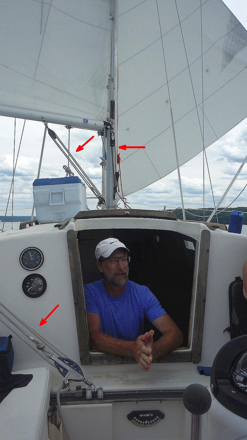

Hi Tim, my 1978 H30C has boom vang, down haul and traveler...highlighted in the attached image. I bought the boat in November 2015 and just assumed these were all standard rigging. With goose neck slider, down haul, and traveler combination, it seems a bit redundant to have a boom vang. But I have yet to see what happens with big following waters...not likely on the finger lakes! We shall sea.
Nice lookin' boat. I'm sure you didn't mean that ^^^^. The vang is an important element of sail control. For once your mainsheet is out all the way, the vang is the only control you have for your boom.
Thanks Stu, we try! Lots to do though, just glad to be on water. Now I get it.
Once the traveler is payed out fully downwind in big blows, no way to correct the boom lift and flatten the sail pocket without it. Can't wait to get an opportunity to see what happens. Not many big blows up here. So far the Labatt's, shrimp cocktail, antipasto, Pinot Grigio, and 50+ year old women in bikinis is my biggest distraction. That's actually a good thing.
