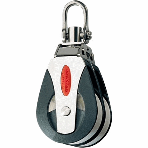

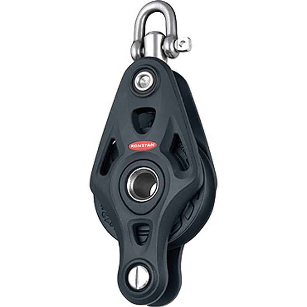

Fred. You’ll not want the vang to clear near the mast if you plan to run the line to the cockpit. For a 3-1 you’ll need a Single Swivel Block with Becket on the boom
and a double on the deck with swivel.
These are Ronstan images to give you the idea. You can find these by other manufacturers. The deck swivel block must turn towards the turning blocks (organizer) leading lines to the cockpit.
The challenge will be more about releasing the tension then when needed adding tension. The blocks will tend to turn when slack. This could cause a jam and require crew to go to the mast. You will need to keep some tension on at all times to maintain a fair lead on the vang line.
If when putting in a reef or raising the sail be sure to ease the vang.
